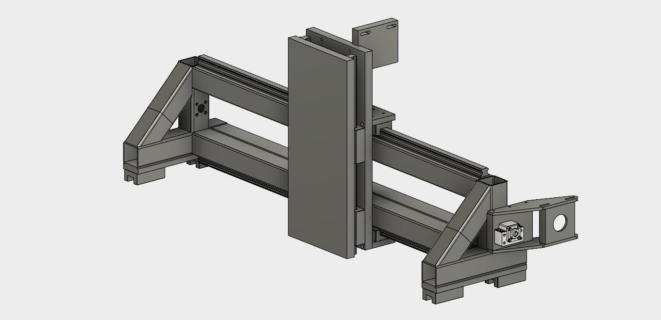

    The Machine
    I wanted to replace my first CNC router which was based heavily on the JGRO design (available via a Google search – plenty of examples around) and built in MDF. It had many problems which I wanted to avoid with the Mk2 although it did a useful job for me for around 4 years. Basic goals were a decent woodworking machine although the ability to machine aluminium would be an advantage. Not necessary, though, as I have a vertical mill anyway for metalwork (CNC conversion might happen one day ). Capacity is always a compromise - ability to work with quarter-sheets of material was a starting point, but the machine needed to fit in my garage/workshop so could not be very much bigger. I had already decided to use ballscrews and Hiwin rails. I started the project about 3 years ago (I’m not a fast worker) and at that time buying these from China was not as obvious a choice as it is now so I bought from CNC4YOU. Not as cheap as China but I have always had good service from them. They stocked standard sizes, so having worked out my minimum machine size, I bought the next stock size up for ballscrews and redrew the machine to suit. As a result, the overall dimensions are length 1800mm, width 1000mm, giving a cutting area of about 1550x750. The X rails overhang one end of the bed which allows me to machine work clamped to the end face of the frame.
    I wanted a floor-mounted machine which could be moved around with the idea that longer pieces of work could overhang the bed if necessary by moving the machine out from the wall. For various reasons (cost, ease of working, and modification) I chose steel rather than aluminium. This is a CAD drawing of the machine as it shows the general structure rather better than a photograph (which is difficult in my workshop anyway). There is obviously a lot of detail missing from this picture; in particular, there is a lot more bracing of the structure in the finished machine.
Name:	1 1 Router Mk2 GA.jpg

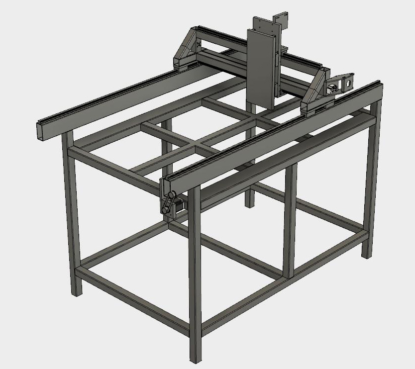

    Although I did a lot of the design in Fusion 360, this was more to work out overall dimensions and some of the details which is why the drawing has some odd little items (motor mounts, for example) but no ballscrews shown.

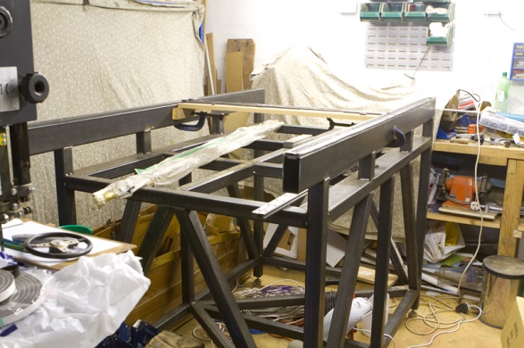

Name:	1 2 Frame in build.jpg
    The photograph was taken during construction but you can see the bracing in place.
    The structure is steel box. Most is 50x50x3 although you can see that there are some 100x50x3 sections supporting the side of the bed and the X rails to give extra stiffness for relatively little extra weight. Reading this forum, there seems to be a general view that anything less than 4mm wall thickness is needed, and 5mm might be better. I have not yet found 3mm to be a problem with one exception – it is not thick enough to take the M5 capscrews holding down the profile rails, or for similar attachment screws elsewhere.
    An unusual feature (not unique so I’m making no claims here but I don’t remember seeing one described at the time I started my design) is the welded steel gantry. People worry about gantry mass and how it might affect performance. When I did the sums, I reckoned that the rotational inertia of the ballscrews was at least as important, if not more so, than the inertia of the gantry when it came to acceleration/deceleration (which is what often matters most – inertia isn’t very relevant to speed) even with the steel gantry. With suitable bracing it could be pretty strong even though I was using my 3mm wall thickness box. This design also meant that I could run the ballscrews through the uprights at the ends of the gantry which solved a lot of design issues. More about all this later.
    Again, more details to come, but the drive is by NEMA 23 3Nm steppers, two for X, one for each of Y and Z. X ballscrews are 2005, Y and Z are 1605. Motors drive the ballscrews via belts and 1-1 pulleys. Rails are 20mm Hiwin.
    The control box uses EM806 drivers running from 68V linear PSU for X and Y, and a recycled M752 for Z – less critical than X and Y, and not needing the stall detection which (in my view) is absolutely necessary for a dual-motor axis such as mine. There is a CSMIO-IP/M motion controller, plus Pilz safety relay and the usual odds and ends. Limit switches are inductive, NPN NC, running off 24V.
    Spindle is the usual Chinese water-cooled 2.2KW/3HP choice driven by an HY VFD. These are the same units first used on my Mk1 router and are now about 5 years old, and have never given a problem. Cooling, when I bother to switch it on, is via a small caravan water pump recirculating water from a 10l bucket. In fact, to extend the life of the pump, I only run it on 12V when initially filling the system or to purge any air bubbles and most of the time it keeps a trickle going driven from 5V. However, for short cuts, I don’t bother to turn on the coolant although I do check the spindle temperature from time to time. Occasionally, the water seems to be a few degrees above ambient. I probably don’t drive the machine hard enough…

    Basic Structure
    As described in the intro, I used 3mm wall thickness box section steel throughout for frame and gantry, with a mix of 50x50 and 100x50. The frame is pretty straightforward. I found that steel has one brilliant advantage over aluminium extrusion – it is remarkably forgiving. The combination of angle grinder and MIG welder (I’m not clever enough for or could justify TIG) means that building the frame is not difficult, and in particular those two tools will also deal with the odd mistake. Chop and reweld to your heart’s content. What I did realise, after the event, is that I should have spent a lot more time jigging and clamping and aligning before welding. Obvious to the more experienced out there, not so obvious at the time to a beginner with a welding torch. Close scrutiny of any of the welds will indicate my lack of ability, but fortunately it seems that a strong enough weld does not have to look pretty. In many cases, I welded as a series of “spots” as I had found that there was more tendency for things to move if I made continuous welds, and what I have done is probably good enough.
    3mm is too thin to take a decent tapped hole for fittings, especially for things like M5 cap screws to hold down the Hiwin rails. I have used the same idea as other people, therefore, and fitted a steel strip inside the relevant box sections to provide added thickness for tapped holes. To keep tapped holes square, I used the old toolmakers’ trick of turning up a short mild steel cylinder, maybe 20mm long, ends faced square, with a hole up the middle a close but not binding fit on the tap. Hold guide to the work and turn tap with other hand. Very easy to make, very easy to use, does a good job. And use spiral-point taps for these kinds of through-holes – enormously better than conventional hand-taps for this kind of work. Mine were cheap from China but stood up well enough to this steel with a bit of tapping compound, even when I was turning them with a cordless drill. I “marked out” the hole positions by clamping the rails in place and then using a cordless drill with a drill bit that was a close fit in the rail’s mounting hole to make a small mark in the steel. You can then swap to the correct tapping size drill which will pick up the mark and drill a hole where you want and not where the drill point drifts to. Using M5 cap screws in the rails gives just a little bit of wiggle room for final alignment as long as you were fairly accurate to start with.
    Note that the additional short vertical braces (see photograph in previous post) which take loads from the main rail supports to just above the diagonal braces are not shown on the original drawing. These were added as a result of a sophisticated deformation analysis. I clamped a DTI to the bed structure and measured the deflection when I put my weight on the middle of the (unsupported) X rail. From memory, I think the bend was around 0.25mm which seemed a bit too much. So I added the extra supports and the deflection was very much reduced. Again, I forget the numbers but I think it was around 0.05mm. Gut feel said that this was better, and good enough.
    The gantry is also a welded steel structure. More 50x50x3 box. Why not aluminium? Well, I had the steel to hand and the tools to cut and weld it, and weight saving is not as important as you might think at first glance. The steel gantry is almost certainly heavier than an aluminium version but not by an enormous amount. Things like the two 20mm Ecocast slabs forming the Z moving and fixed platforms are pretty heavy, and the spindle and mount add a chunk of mass. There are also Y and Z motors, ballscrews, and rails. As mentioned in the intro, the rotational inertia of two 20mm ballscrews 1700mm long is quite significant as well, so a bit of weight-saving in the gantry structure doesn’t make a big percentage difference to the total inertia as seen by the X drive motors. I reckon that the total finished gantry weight with everything in place is about 40kg. Of that, the steel weighs about 18kg. If you just replaced the steel with identical section aluminium it would weigh about 6kg, but in practice the aluminium would need to be of much heavier section, so maybe around 12kg? In other words, aluminium would only save about 6kg out of 40kg.

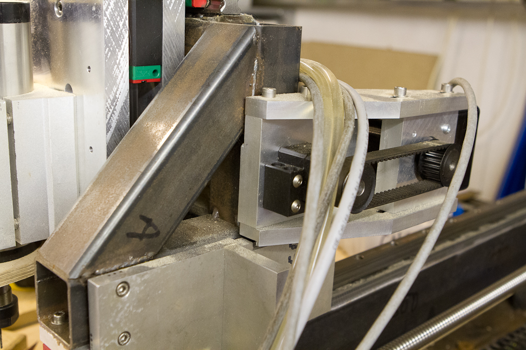

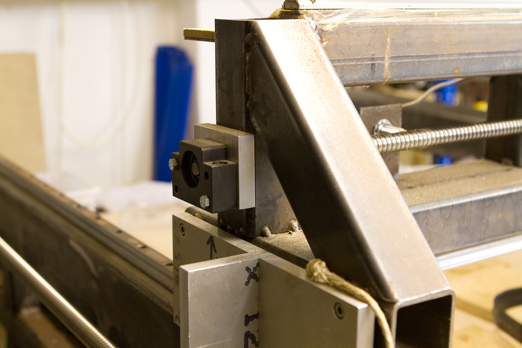

    The gantry structure has Hiwin rails mounted on top and bottom. I considered using the front face of the rails but top and bottom gave more separation. I was also able to achieve the ideal of the ballscrew geometrically centred between the rails, by running it through the gantry uprights which might be more difficult with aluminium. All the relevant holes have sufficient clearance to allow tweaking on assembly to get the alignment right – I allowed something like +-1.5mm. You can see one ballscrew bearing at one end of the gantry and the clearance/mounting holes at the other.
Name:	2 2 IMG_5587.jpg
Name:	2 3 IMG_5588.jpg
Name:	2 4 Y motor.jpg
    Of all the things that are important with a home-built machine like this, the most important has to be, “If you can’t build it accurately, make it adjustable!” I knew that I was not going to be able to keep the “feet” of the gantry accurately aligned due to welding distortion (I should have done better – see comment about jigging and clamping) but the machine design allowed for that. The X Hiwin carriages bolt to a flat 12mm aluminium plate. The gantry feet - lengths of 50x50x3 - bolt into tapped holes in those plates via a set of holes just inside the ends of the feet. However, the feet were not truly horizontal, as expected. I therefore made up a thick epoxy paste, smeared a good layer on each plate, covered it with a sheet of Cling film, and gently placed the gantry on top. Excess epoxy oozed out and was removed, and the whole thing left to cure. Once cured, I lifted the gantry clear, removed the epoxy from over the tapped holes (a small square of sellotape over the hole ensures that the threads stay clear), and the gantry then dropped neatly back on to its prepared bed with no wobble. As I said, allow for inaccurate build! The holes in the gantry feet were also made a little oversize for their bolts, to allow a small amount of movement for squaring the gantry (at a later stage).
    The whole machine sits on castors bolted to simple welded brackets so it moves easily around the workshop if necessary. However, in use, it sits on home-made feet. I welded M12 nuts to flat plates across the bottom of the legs, and turned down the heads of 12mm bolts so that they fitted into counterbores in wooden pads to sit on the concrete workshop floor. I also welded on M12 nuts so that the feet would be easily adjustable with a spanner (as I had just turned off their heads which were hidden in the wooden pads anyway…), and a locknut makes sure that they don’t move afterwards.
    A lower shelf of thick MDF rests on the bottom rails, and I welded on a set of brackets to carry a second shelf halfway up and across half the area of machine. There is just enough room to bolt the control box to the frame so that it sits, in effect, on the lower shelf but is easily accessible, and at the moment the PC and monitor also sit on the lower shelf. I’m still making a swivelling bracket to hold the monitor at eye level, and I use a wireless keyboard with built-in touchpad. However, I have just started using one of the wireless Mach3 MPG devices from Aliexpress which is making things easier and I wouldn’t want to be without it now.
    The bed is supported by a simple grid of 50x50x3 box welded in place. I did my best to ensure that the grid was flat, but I had a plan to allow for inaccuracies anyway. I have bolted a set of strips of hardwood to the bed support rails. I used U-bolts sunk into grooves below the top surface of the wood. I then machined the top surface of these wooden strips using a 50mm face cutter, and using the machine itself. This guarantees as far as possible that the bed supports are parallel in all dimensions with the machine X and Y axes. The bed itself is a simple sheet of 19mm ply which seems to be flat enough for my purposes (mostly woodworking) and if I need more accuracy for small components I machine a spoil board in situ. I have also added ľ” aluminium extrusion track to take T nuts and bolts for work hold-down; by machining the grooves for the track with the machine itself I can also align work pretty accurately using the tracks. The track comes from Rutlands – they have it on special offer fairly often. I also bought a big set of T-bolts and clamping knobs, again at special offer prices. They are intended for ˝” track, but I made up some sliders to make use of them on the bigger track. Really useful.

    The drive system on my machine is pretty conventional. Nema 23/3Nm steppers driving the ballscrews through 1-1 pulleys and HTD5 belts.
    I fitted pulleys partly because I wondered at the design stage about needing to change pulley ratios. However, given that the critical speed of the X ballscrews is about 900RPM (2005, fixed/floating bearings, although different critical speed calculators give slight variations) and the corner speed of the steppers is about the same, I was designing for a machine rapid speed of about 4500mm/min, which seemed reasonable at the time. Still does, in practice, as I tend to be making small fiddly bits where acceleration is more important to total cutting time than speed. In practice, after playing about with settings, I’m running with a max rapid speed of 5000mm/min which seems to work OK, and I’ve set the Y to be the same just for consistency. I don't see any real need to change pulley sizes.
    However, pulleys also allowed me to mount the motors within the overall envelope of the machine rather than protruding, which is useful in a confined workshop where space is important. The motors sit on slotted brackets which allow belt tensioning and in theory the slots are long enough to allow other pulley size combinations.

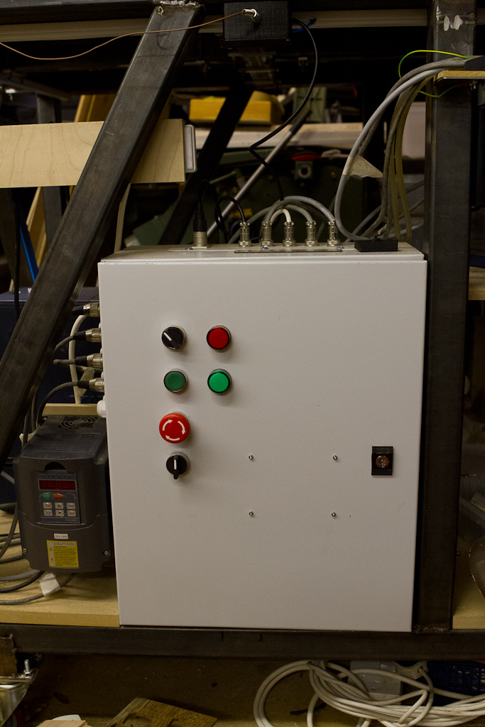

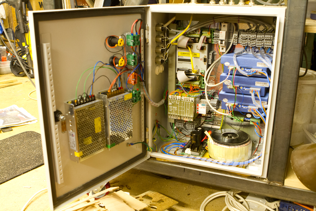

    The Electrickery
    The early design decision which drove much of the design in this area was the selection of the CSMIO-IP/M motion controller. This choice was driven mainly by discussion on this forum. Not the cheapest option, but I was attracted by a number of features:
    • Ethernet communication to PC (noise resistance)
    • 24V supply and external digital I/O signalling (noise resistance)
    • Differential signalling to stepper drivers (noise resistance)
    • No BOB needed – built-in to unit
    • Built-in analogue output (and input, although I’m not using this)
    • Good reputation for build quality and reliability
    It required a move to Mach3 (Mach4 would have been possible but I preferred to go Mach3) from LinuxCNC which I had been using with the Mk1 router. LCNC does have motion control hardware available, but this seems rather more difficult to specify (and understand!) Not sure if I would go the same way today, but would need to do more research on the LCNC added-hardware options first. Anyway, the IP/M was available off-the-shelf from Zapp and I bought during one of their “special offer” periods where (at that time, I believe) the LCNC-supported hardware was only available from the US. Again, this might have changed – I’m talking about decisions made around 3 years ago.
    Having chosen dual X motors I wanted to go digital for the stepper drivers, replacing the older analogue drivers I had used with the Mk1. Generally described as giving smoother motion with various anti-resonance features, for me, the most important feature was stall detection. With a dual motor setup, if one X motor stalls for any reason, you want the other to stop immediately before you potentially break something by driving the gantry on one side with the other locked. These motors are surprisingly powerful! I bought EM806 drivers which are a later updated version of the popular AM882. At that time, I thought that the AM882 would become obsolete and I wanted something that was going to stay current for a while; in the end it seems that the AM882 is still going strong. However, I only use EM806 for X and Y; the Z axis uses an old M752 salvaged from my old router. Saved money and I’m not sure that the Z axis needs the advantage of the digital driver or stall detection. Seems to work fine in practice. I use a 68V linear power supply for the steppers. The original 500VA toroidal transformer failed and I replaced it with a 650VA item but it doesn’t even get warm with my normal machine use.
    To keep the control box contents cool, I have a couple of 12V 120mm fans on one side with foam dust filters that get cleaned from time to time. However, they are run in series off 12V so just give a gentle waft of air over the drivers and then through the box.
    I was able to pick up a cheap “new but shop-soiled and obsolete” Pilz safety relay on eBay. 24V so it worked well with the PSU needed for the CSMIO. I’m still not quite sure exactly how the thing works internally, but the effect is like having two relays with their coils wired in parallel, but their switch contacts wired in series, and with a latching capability so the thing is reset with a momentary-operation switch. Both coils have to be activated so that all their switch contacts are closed for the machine to work. Even if one relay fails to release when the e-stop is operated, or a switch contact welds together and does not open, the other relay will still act as a safety device - it is very unlikely that both would fail together. If I were doing this again and couldn’t buy a cheap Pilz device, I might well consider doing something similar with two ordinary relays. Not quite the same level of reliability, perhaps, but pretty good if you don’t have to satisfy the safety mafia who want everything documented. Anyway, my safety relay has (the equivalent of) three n/o contacts plus one n/c contact. One n/o switches the enable signal to the CSMIO, one n/o switches mains to the stepper driver PSU (via a 24V relay), and the n/c switches the enable signal to the drivers. Ideally, this last signal should also go via a n/o contact but the wiring was slightly easier this way. Belt, braces, and electric trouser hoist – any one of these three actions should stop the machine. The safety relay can be tripped by any one of the three e-stop switches mounted around the machine and there is a single "reset" button on the front panel.
    The fault signals from the digital drivers are wired to the “driver fault” input on the CSMIO. The hardware documentation tells me that the response time is very quick like this, although clearly I am relying on a single safety mechanism via the CSMIO firmware here. However, a motor stall might damage the machine but it is not the same as a “personal safety” issue which is handled by e-stop switches and the safety relay. Limit switches are wired to the CSMIO; a limit switch event does not cause an e-stop event and I have to trust the CSMIO firmware to do the right thing.
    So, I have to rely on the CSMIO for limit switch events. I do have limit switches at max X and Y travel as well as min; the min limit switches are also used for homing as usual. Each axis has both limit switches wired in series. There is a single min limit switch on the slave axis but this is not wired to the motion controller. Just a single limit switch at top of Z travel, also as usual. I’m not happy about the reliability of the cheap proximity switches that I have bought. It was a cheap box of ten from eBay; one was the wrong type, one never did work, and the rest seem to have virtually no hysteresis between on and off switching points. This was a pain when first setting up the machine. Because I have the home switches for each axis wired to separate CSMIO inputs, I can home more than one axis at a time. I have the machine configured to home Z (to raise the tool clear of any work) then X and Y together. What happened was that Z homed fine, then X and Y started moving, and almost immediately I had a limit switch trip. This could only be on the Z axis, as the X and Y switches were being used for homing at this point. Eventually I discovered that Z homed correctly by moving until the switch tripped “off”, then moved a tiny amount in the opposite direction until it tripped “on” and Mach3 used this position as “home”. This is normal Mach3 homing action. However, because the on and off trip points were so close, once the Z axis had homed any slight vibration was enough to cause the Z switch to trip “off” again – which was now being interpreted as a limit switch event. I am very grateful to Dean/JazzCNC for pointing out that the CSMIO allows you to define a small offset for the home position; now, my Z axis goes through the usual homing process, then drops 0.5mm and sets “home” there. Far enough that the switch does not trip accidentally.
    I mentioned proximity switch reliability – I have had two of them fail while fitted to the machine. This is one reason why I also use soft limits set slightly inside the physical limit switch trip points. I find this very useful as I often jog an axis out of the way, and you can just run the axis up to its soft limit without any ill-effect or physical limit switch event. The only down side that I have found with soft limits is that they prevent use of jogging unless the machine has been homed. If you want to rehome the machine and one or more axes have a long way to go, it can take a bit of time as homing speed is rather slower than full rapid speed. However, homing is a bit faster by having X and Y home simultaneously so I don’t usually bother to turn off soft limits to jog in this situation.

    For completeness, here are a couple of pictures of my control box. External controls are mains on/off and pilot LED, reset button and associated LED, e-stop, and spindle coolant pump switch. This has two positions and centre-off; turn to left gives 12V on pump (only used for filling system and purging bubbles) and turn to right gives 5V – slow trickle of water through system which is more than adequate and should extend the life of the cheap water pump I am using. I often don’t bother with the spindle coolant if I’m only doing a smallish job – I just check the spindle case temperature from time to time. Everything else is driven through Mach3, using a wireless PC keyboard with integrated touchpad and a wireless MPG “pendant”. You will see warnings against using wireless keyboards like this because of potential electrical interference generating false keystrokes but I have never seen this problem.
    External connections are made via cabinet-mounted sockets, with the exception of the hard-wired mains lead. Stepper motor connections are via 4-pin XLR connectors. They lock in place, so minimal chance of one falling out, and the contacts, on paper at least, are rated for the motor current. I started by hard-wiring motor connections to DIN rail terminals but found that I was continually needing to remove the control box while setting up and testing so went back to the same connectors that I had used on my previous machine, and where they had worked successfully for a number of years. Control and similar connectors use what were described as “avionics connectors” or GX16. I use 4-pin versions which have a screw-lock to keep them in place. There are 5 of these altogether and carry e-stop, limit switch, spindle coolant pump, and VFD connections. The remaining connector looks like an XLR connector but inside the shell is an RJ45 ethernet connection. The actual plug and socket are pretty much standard RJ45 but the cabinet-mounted socket has an XLR-compatible fitting around it and the plug is an XLR shell that fits over the RJ45 plug for protection and locking. These are available off-the-shelf from people like Rapid Online, but make sure that you get the one that fits over an existing connector if you want to use a commercial Ethernet cable. Otherwise, you are going to have to fit the RJ45 connector yourself AFTER putting the shell on the wire. Guess how I know this… The RJ45 bulkhead connector has a short length of Cat5 cable inside the cabinet connecting it to the CSMIO.
    All cables on the machine run through cable chains; motor, limit switch, spindle power, and spindle coolant pipes all run through the same guide. I have tried to keep limit switch and motor cables (all CY) on opposite sides of the cable chain and I have not seen any interference or false triggering effects. I suspect that the 24V signalling voltages are a great help here – much better noise rejection. I have also run ground wires through each section of cable chain between ground points close to each end of the cable chain. This removes any reliance on ground connections via the Hiwin rails. Certainly the touchplate mechanism is very reliable – no need for crocodile clips to the tool bit or anything like that.
