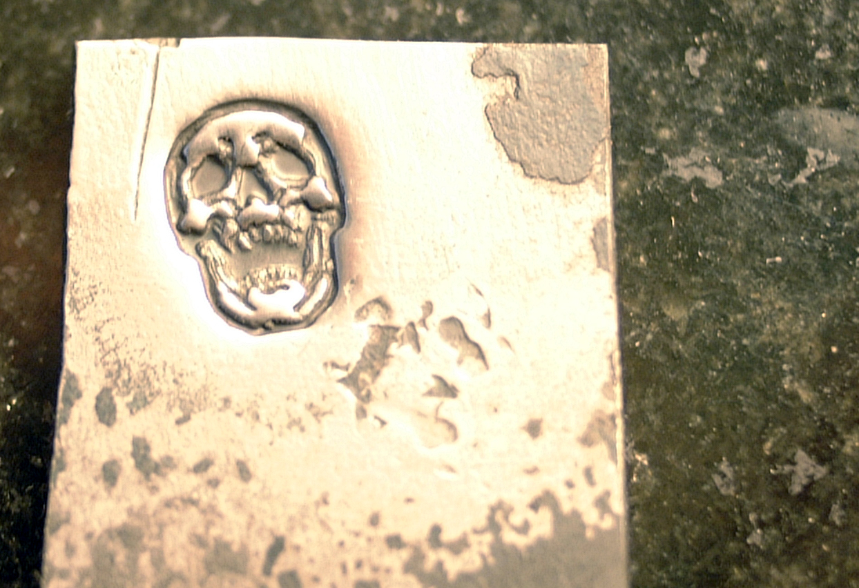

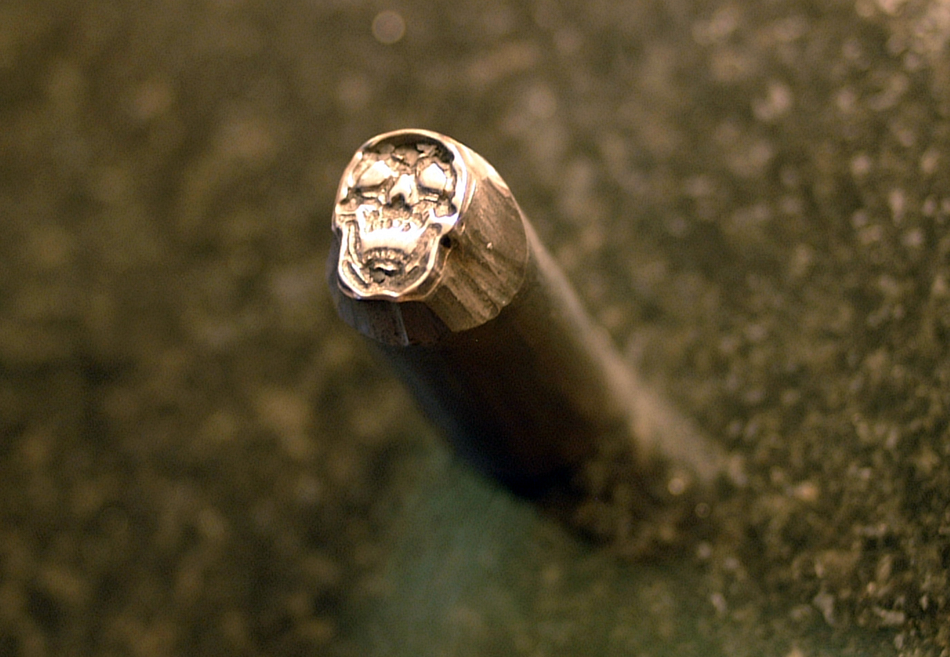

    I've made branding irons for wood and stamps for steel, this a 10mm wide 01 Tool Steel stamp I made for a customer and the impression on steel

    I did this work with a Contour Minor CNC milling machine driven by Mach3 and an old 12v Router CNC control box with no PP buffering.
    I just sold the whole system for just less than the sum of it's parts cost with 5 Coventry Easy Change holders and six ER11 10mm shank collets, a 4th axis and a 30krpm high speed spindle :D
    Mass and rigidity are your friends when machining fine detail

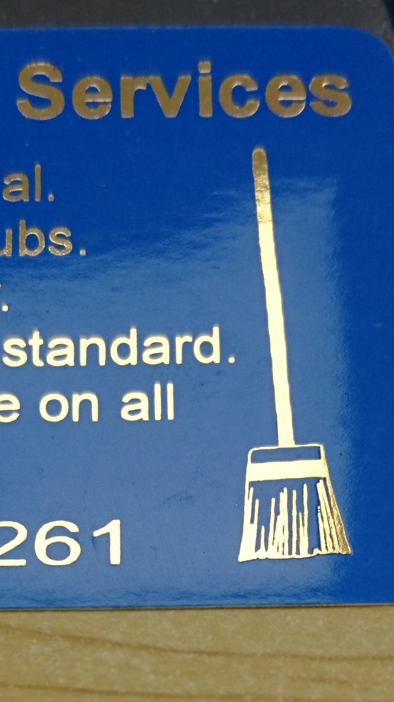

    I'm mainly speaking from my hot foiling experience, and some of the jobs I did.
    The blocks/plates I used were magnesium, and used some kind of photo etching process to create them.
    I've no doubt, CNC would be good for some jobs in hot foiling, but a lot of the stuff I did, I don't think so.
    I have attached a scrap card, showing a broom head. I don't any other examples at hand.
