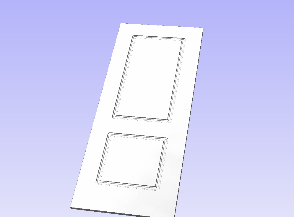

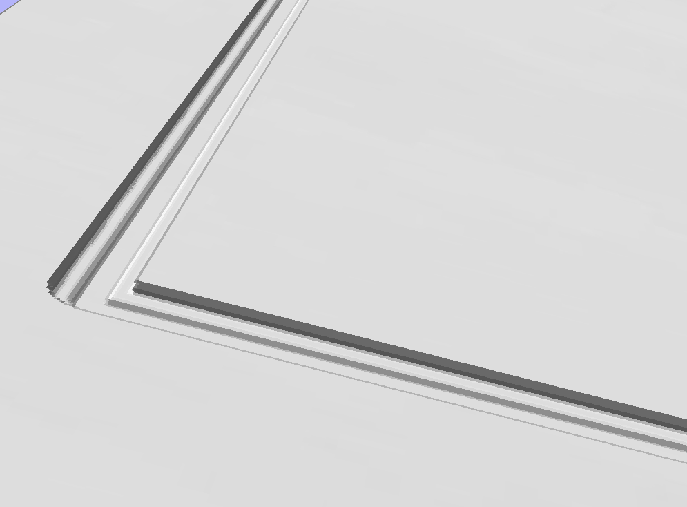

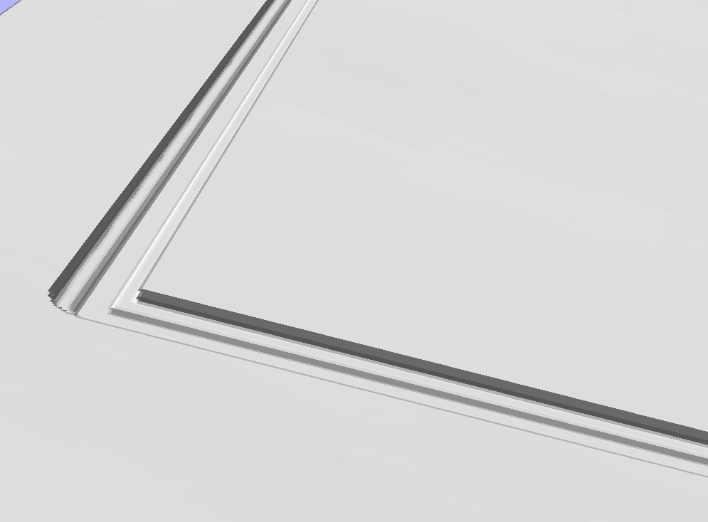

    A very nice short video how to program the custom shape of the profile cutter in Vectric V carve or Aspire. It took less than a minute.
    So now i can preview the cut
ID:	25899 Click image for larger version.
Name:	mdf door profiling 2.bmp
    Still not quite sure about the speeds and feeds with this 35mm bit, depth is 9.5mm. Will try it tomorrow at 16k rpm / on the tool it says it can/ 5000mm/min, 1.5mm depth of cut. It will take 7 cuts to finish to final depth of 9.5mm.
    I believe i can go 2mm deep at 7000mm/min probably, but will start easier on the spindle. The initial speed will be like 13 min to finish one side of the door. Seems pretty slow to me.
    Anyone has experience with ogee bits in MDF?
