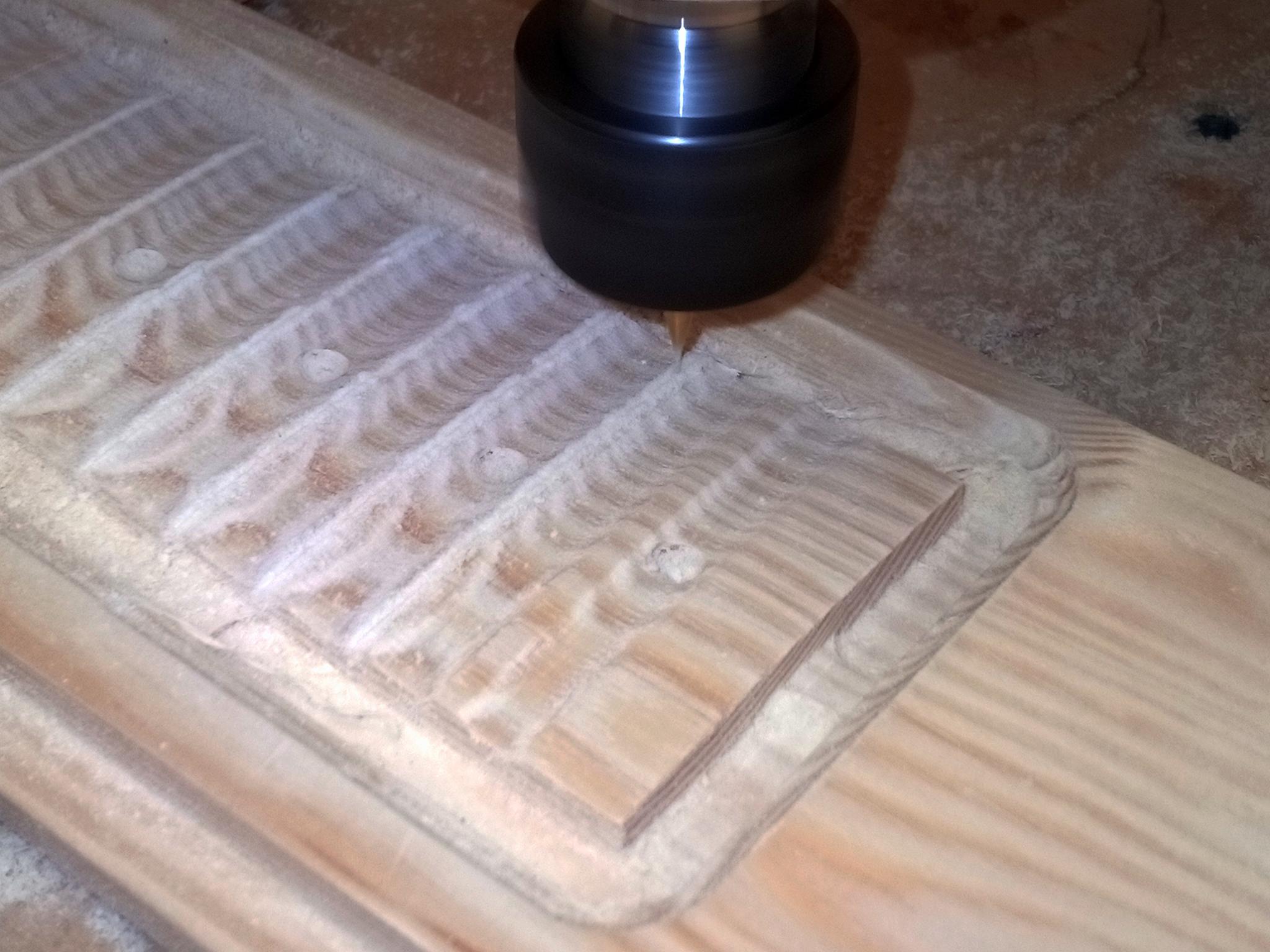

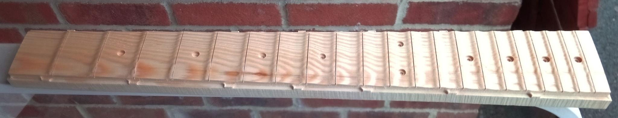

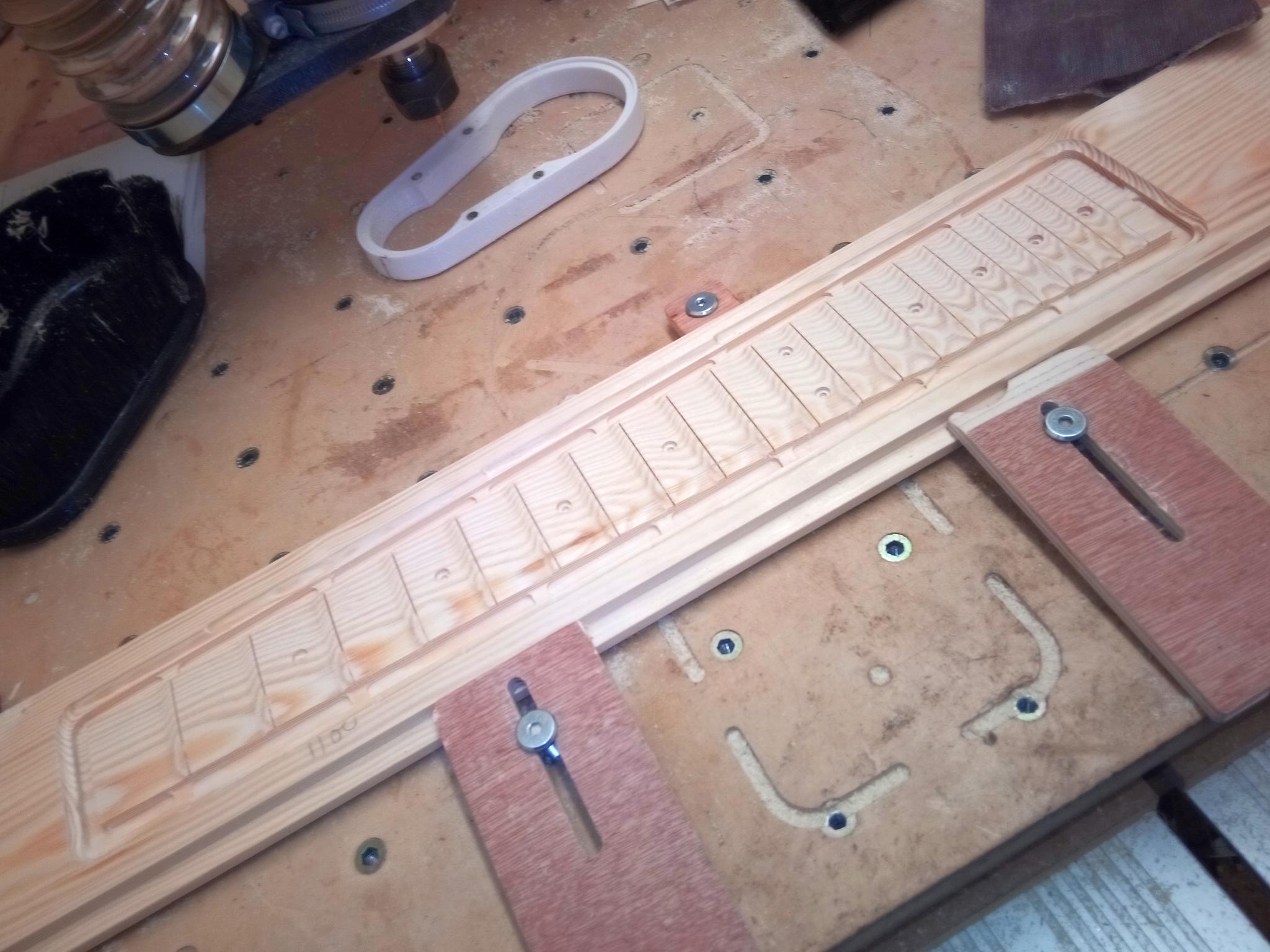

    Ive been using 0.5 mm slot drills, I generate the code using Fretboard.exe which is in imperial, so generate the code and scale it in Discriminator to suit the Estlcam controller.
  6. #16
    Cut a test one in a bit of pine,
ID:	25864   Click image for larger version.
ID:	25865   Click image for larger version.
  7. #17
    Looks okay, did you check both ends with radius gauges ?
    I'm not a fan of marker dots these days, I just use side dots and one at the 12th fret as a logo.
    What's the difference between a scalloped board and just using tall frets ? of course with the cnc it's no more difficult to make.
    Also don't be worried about asking me to process more dxf files, if it's to do with guitars I'm on board.

    The guitar lads soon get out their guages etc whenever I cut something for them. as a non player I also wondered about tall frets.
    Thanks for the offer of help with files, I may well be asked for something different.
  10. #19
    [QUOTE=EddyCurrent;109021]Looks okay, did you check both ends with radius gauges ? [QUOTE]
    Man with guages says "perfect"
