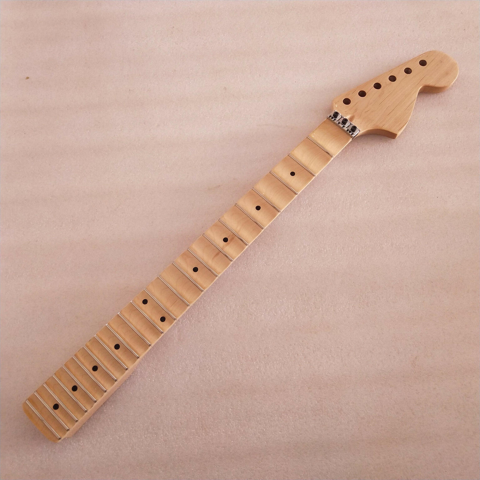

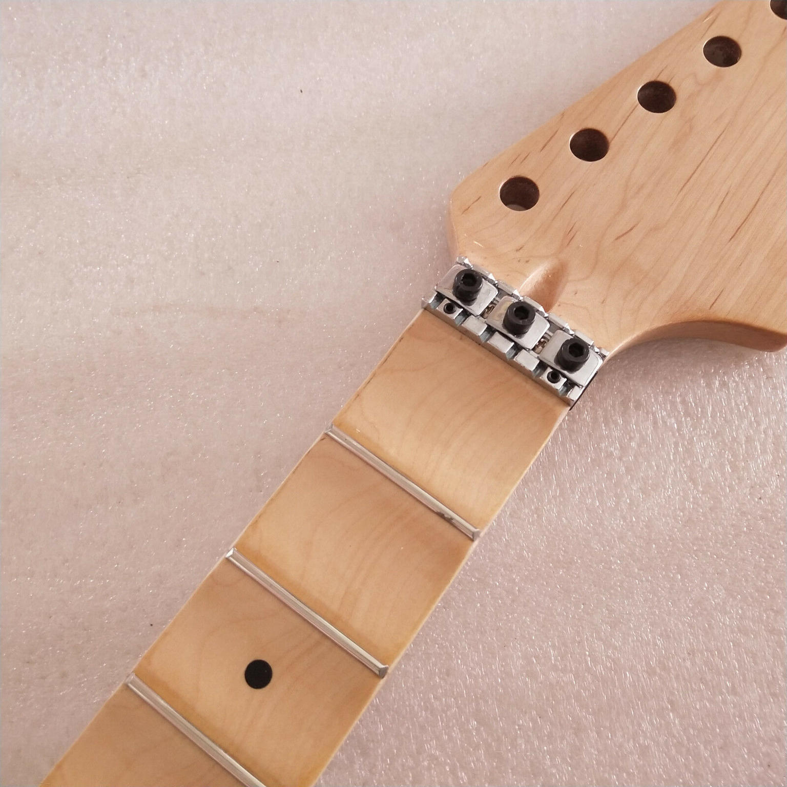

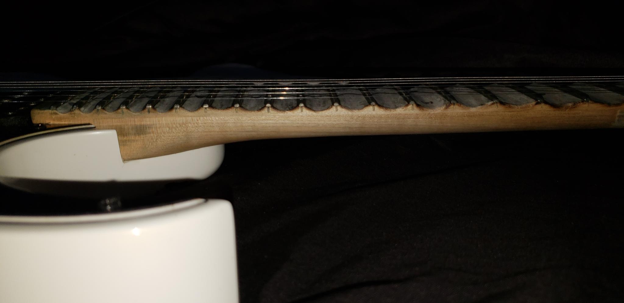

    I want to cnc a scaloped guitar fretboard, similar to the pics.
    I can draw what I need in my ancient Acad but not generate a model or an stl file.
    I wondered if anyone would be willing to generate a model and a file

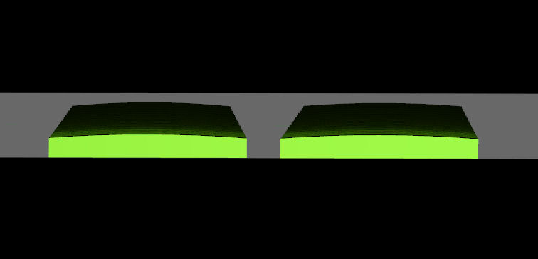

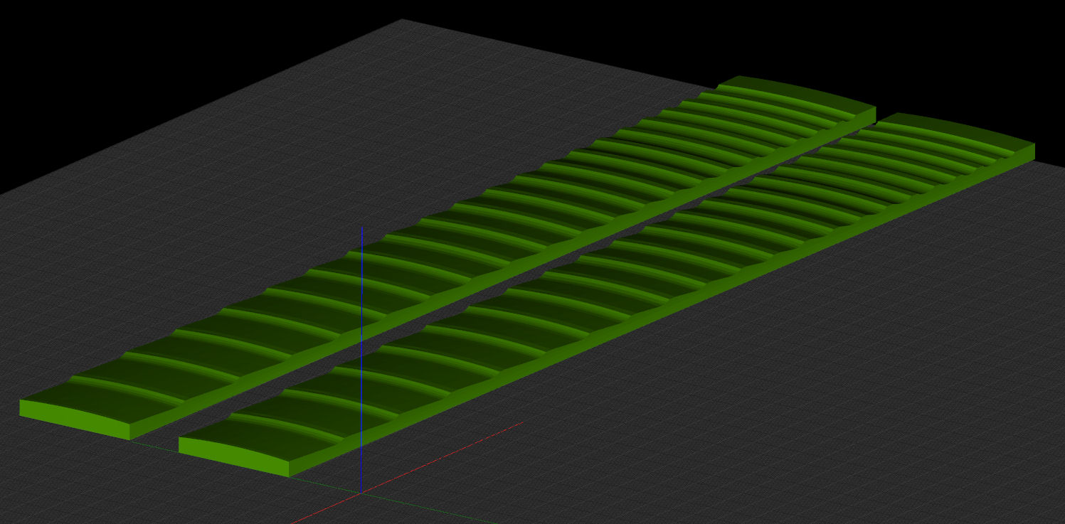

    Sorry about the oversight earlier, these two files are correct and as per drawings.
    Images show the stl files opened in CamBam
    In the CAD (Rhino6) I used a "Two Rail Sweep" with the end profiles being the two rails and the scalloped profile being the cross section.
