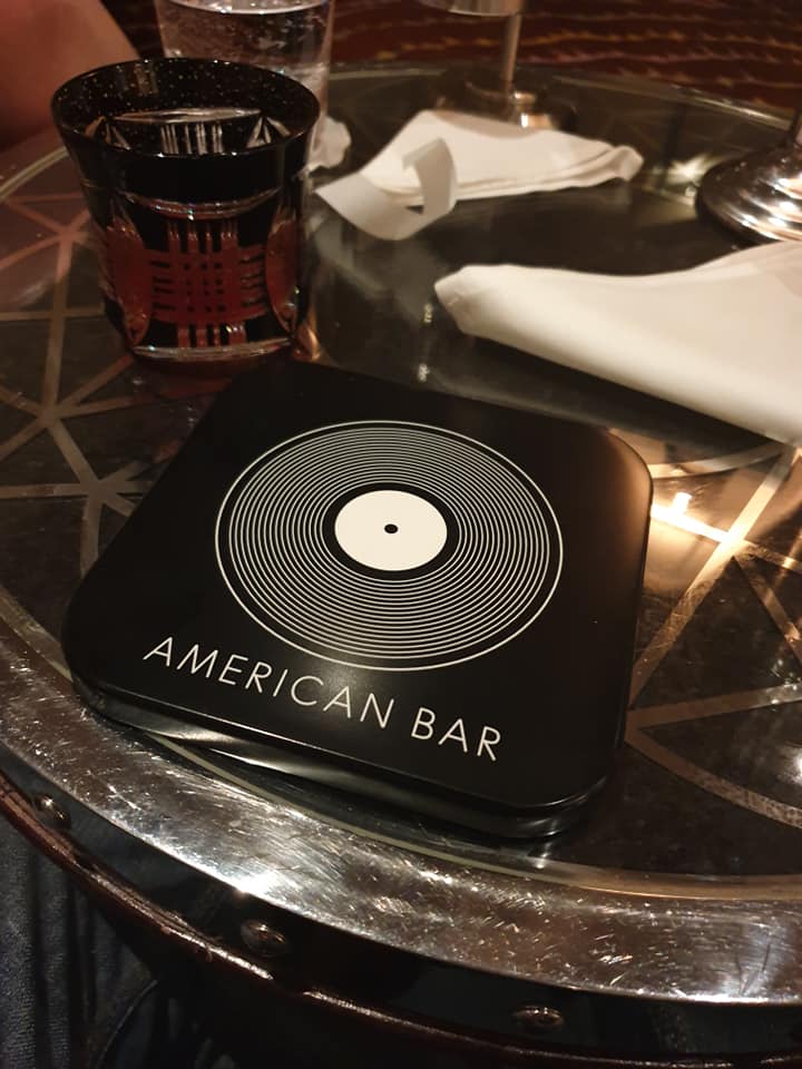

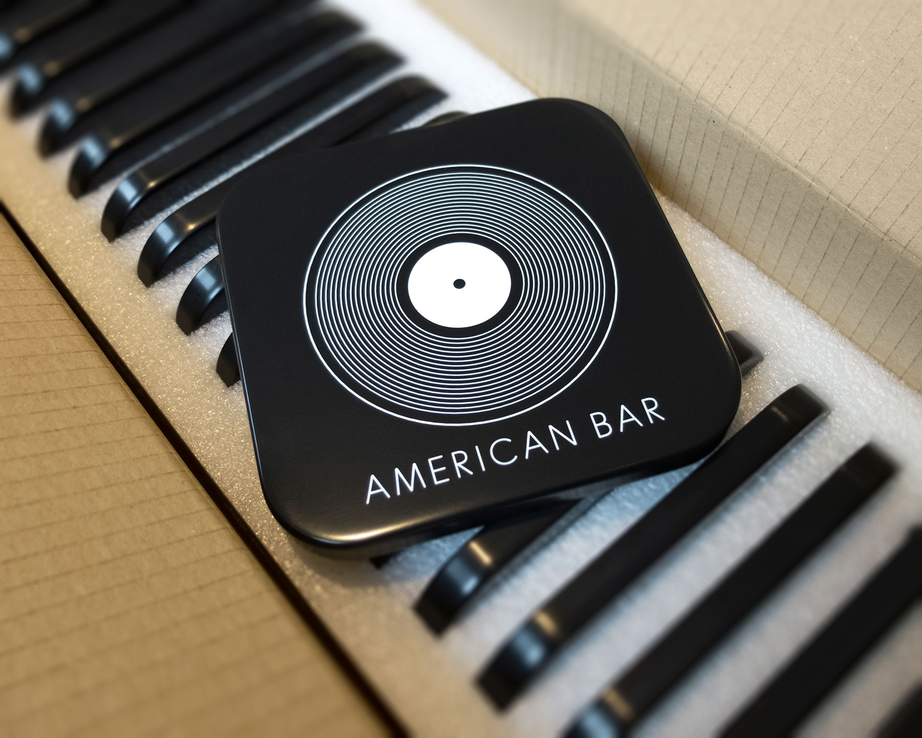

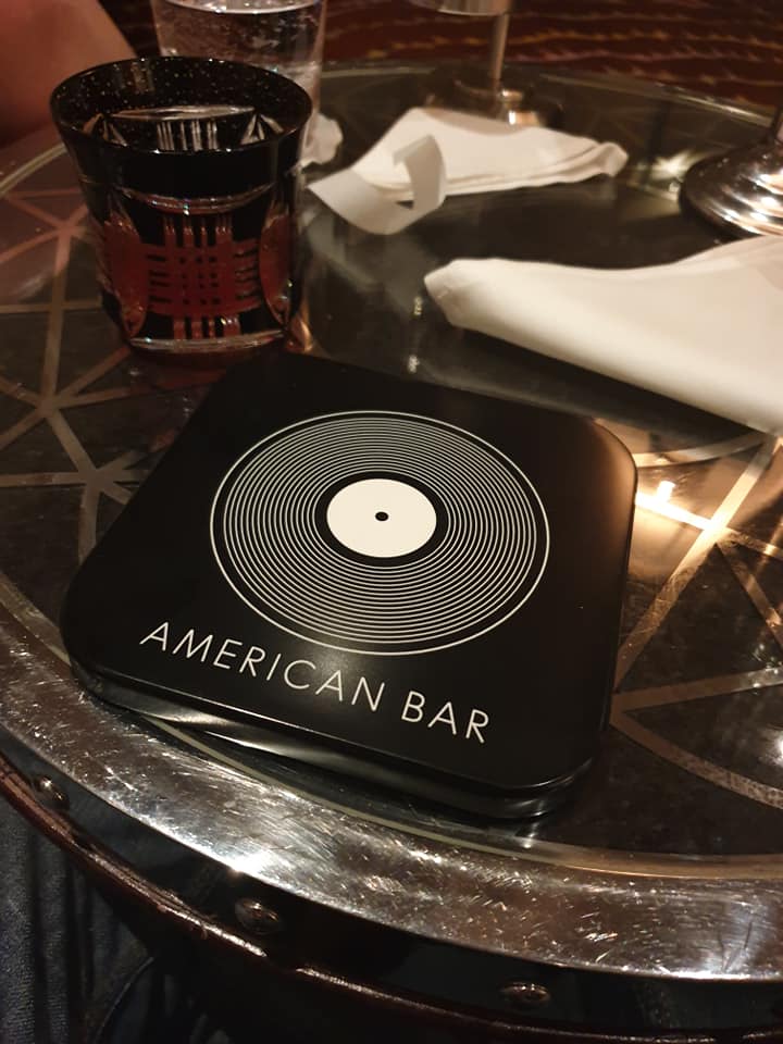

    Hello all.
    This started as a woodworking project before the decision was made that making these in wood was going to be a nightmare - both in terms of finding dark exotic stock in the sizes and quantities that were needed, the ethical aspect of using all that stock and the expense and the wastage (both in time and material) that any tear-out around the details would lead to. In addition to all that, the aesthetics of the overall design asked for something a bit different too.
    Eventually the design team settled for Corian - oh yes, still expensive but a lot more stable and predictable to work with.
    Anyway, I present to you the new cocktail coasters for the American Bar at the Savoy Hotel in London. Yes, that one..!

    This was a real mission of a project. Each coaster is engraved (using 0.6 and 0.4mm cutters) and resin filled. The top faces along with machined edges and transitions into the round-overs all needed to be hand finished through multiple grades of wet and dry before getting rubbed down with Scotchbrite and finally polished. No micro-scratches allowed. I had 125 to make. Days and days of sanding/polishing - my arm barely worked by the end of it..!
    A really nice project to be a part of - must pop down for a drink one of these days..!
