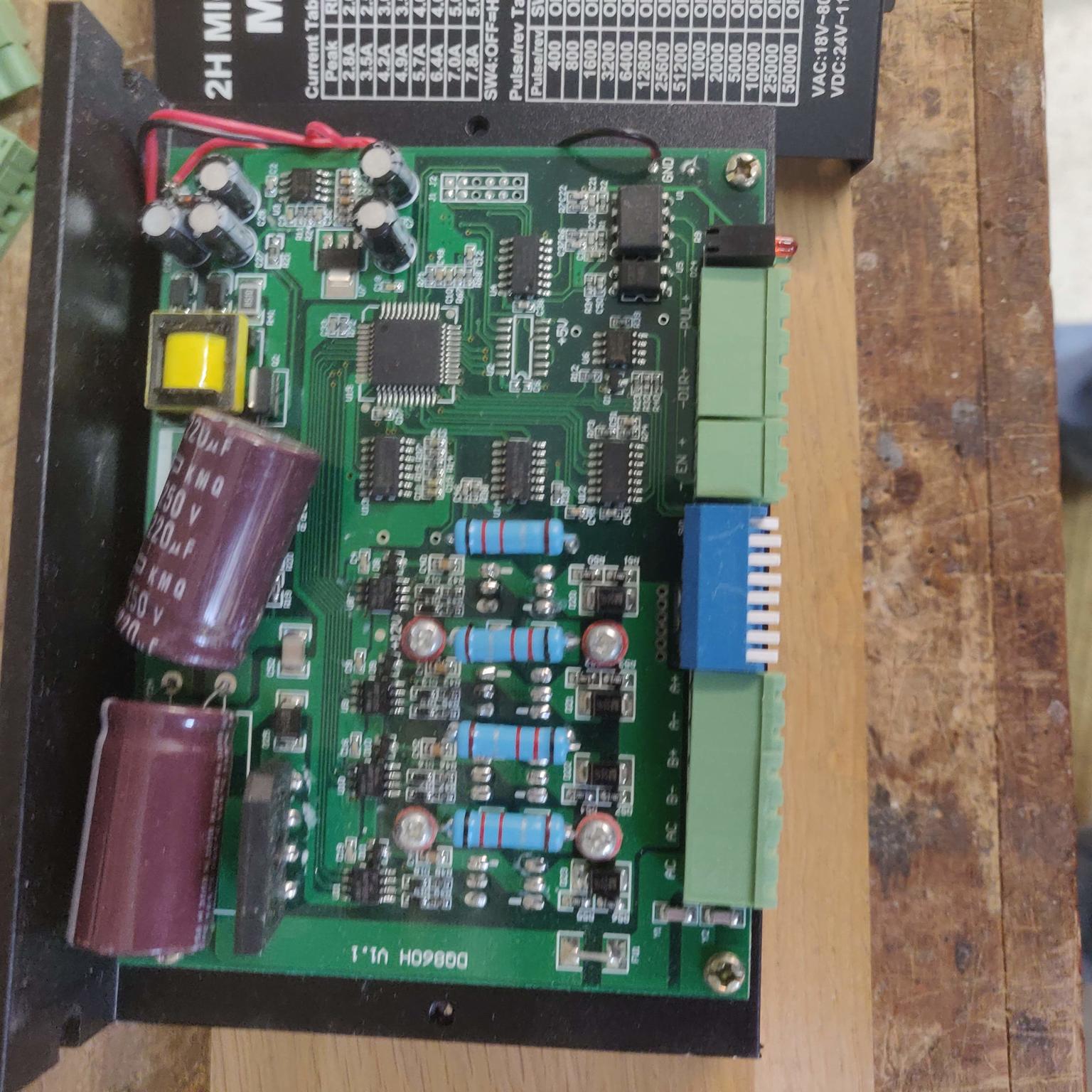

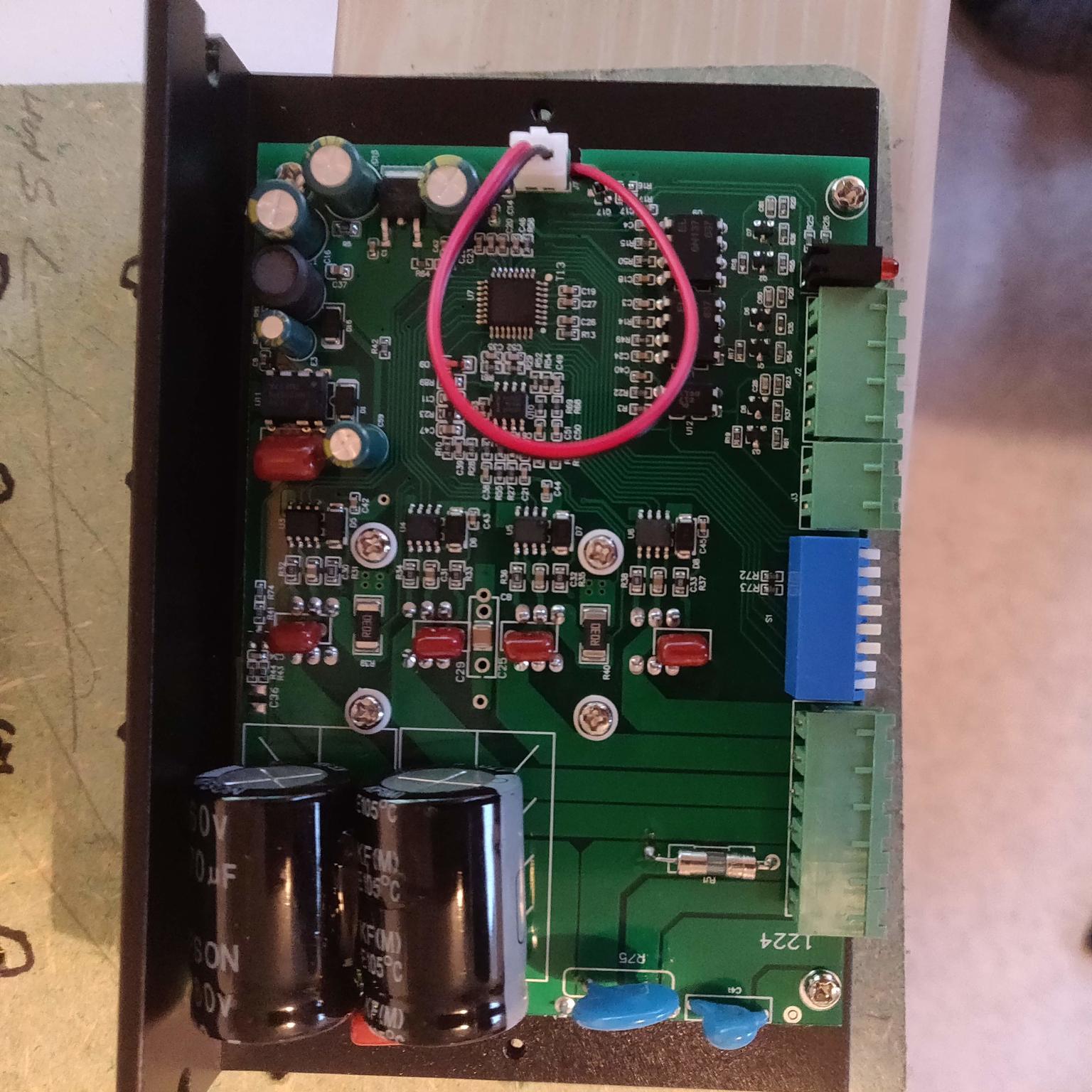

    I have got two drives one was £39 and the other £28 both MA860H are these digital or analogue? Go figure!!

    Not sure mate, noticed it says DQ860H on one of the PCB's, found this as well: http://www.leadshine.com.ua/pdf/ma860h.pdf

    DQ86(left) is asic drive , yes it is analog
    1224 (right) is dsp drive
