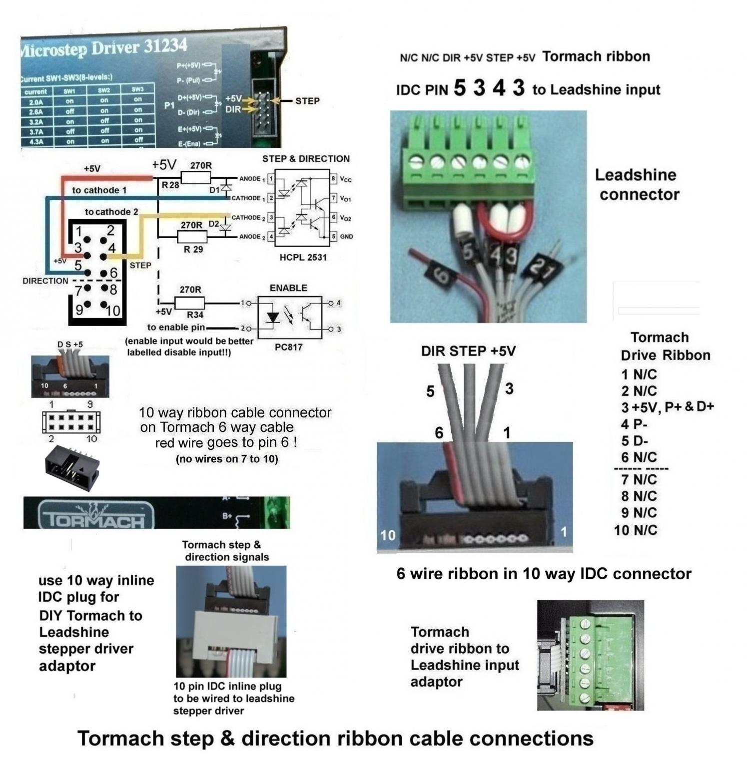

    The photo of the driver reminds me of the Leadshine drivers usd by Tormach
    the Tormach driver having a 10 pin box header instead of the usual 6 way connector for the step , direction and enable inputs
    https://www.cnczone.com/forums/torma...r-pinouts.html
Name:	Tormach Micro Step Driver 31234 B V2.jpg
