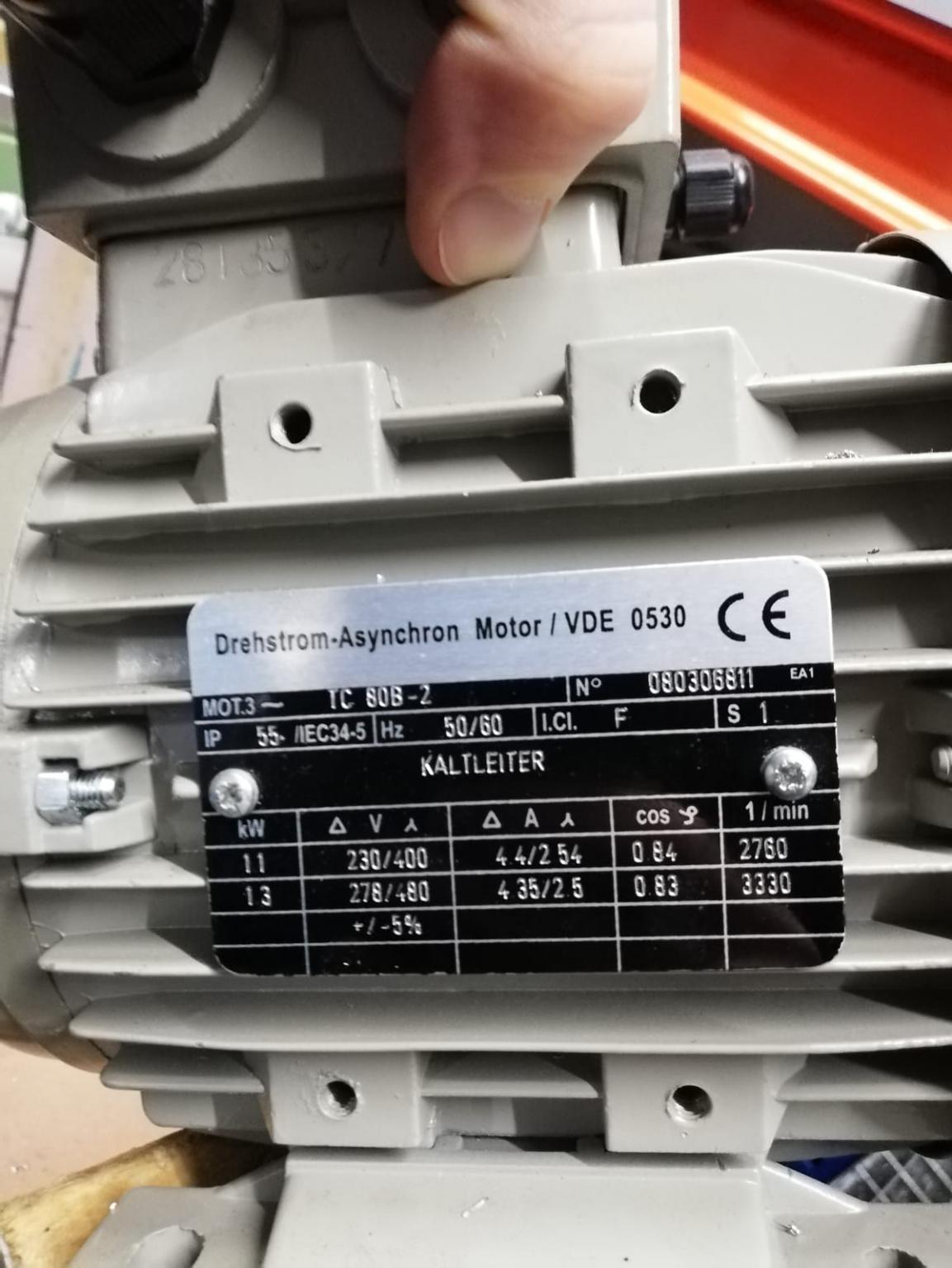

    Hello,
    Thanks for the help, I tried your settings and also other settings, but unfortunately without success.
    I also tried another motor (0.55 KW), unfortunately it shows the same behavior.
    Without load
    With load
    Any ideas?
    Regards Marc

  2. #22
    Hooray, a small success!
    I have now got the motor running under load, for this I had to set P72. Unfortunately, the motor now runs very rough in operation. Can someone help me with the torque settings P70, P71 and P72?
    Greetings Marc
  3. #23
    Quote Originally Posted by Spyke View Post
    Greetings Marc
    Something is not right with the fundamental settings. P72 is just for additional torque at low speed. I did not use mine in the end as there was plenty of torque when I did some test drilling.
    How is this wired to the motor ? Delta pattern I assume ? Is this wired correctly at the motor end ?
    How many poles? I assume 2 poles from the rpm ? Is this set correctly ?
    What is the max current set to P76? Maybe this is too low and the P72 is helping you out but it is not the way to solve it.
    Check all connections are tight.
  4. #24
    It is wired as delta, what do you mean with wired correctly at the motor end? V is V, W is W, U is U.
    Yes its a 2 pole motor. I checked all connections several times and do also a trough check with multimeter.
    Max current is set to 8000.
    I saw in different videos nobody needs torque compensation for starting motor with load.
    It seams that one phase has not enough power and causes the motor stuttering under load. So I think something is wrong with my Vfd.
