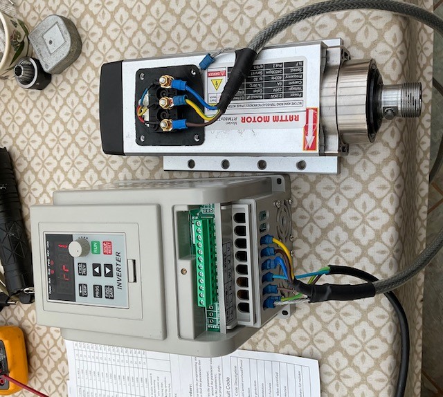

    First of all let me tell you that I am using a very un-sophisticated manually operated duplicating router, using at first, a Huanyang VFD / 1.5kw aircold spindle combination. After a year of service, which by the way was not continuous, the VFD started faulting with several different overload faults. I ended up purchasing two XSY-AT1 VFDs and a spare motor on Ebay. I completely rewired the machine then started on the long journey of programming the VFD. After taking everyone’s advise on different parameters, which got me really close, I finally tweaked the settings where the spindle spins and stops correctly using the onboard commands. If anyone needs them, here are my final parameters. Don’t ask me my logic, because it was all trial and error......mostly error.

    Hi all.
    I'm running a 2.2Kw Vevor spindle motor. When adjusting the Pot to increase spindle rpm I'm getting Error 1 (Current Overload) and the inverter trips.
    I have set all parameters to the latest list posted. Under/Overvoltage is at 220/255 P78 Main current O/load is 7Amps

  12. #10
    Quote Originally Posted by Len-Tikular View Post
    Hi all.
    Any helpers out there ?Click image for larger version.
    Just a thought have you checked the ramp speed seconds parameter
