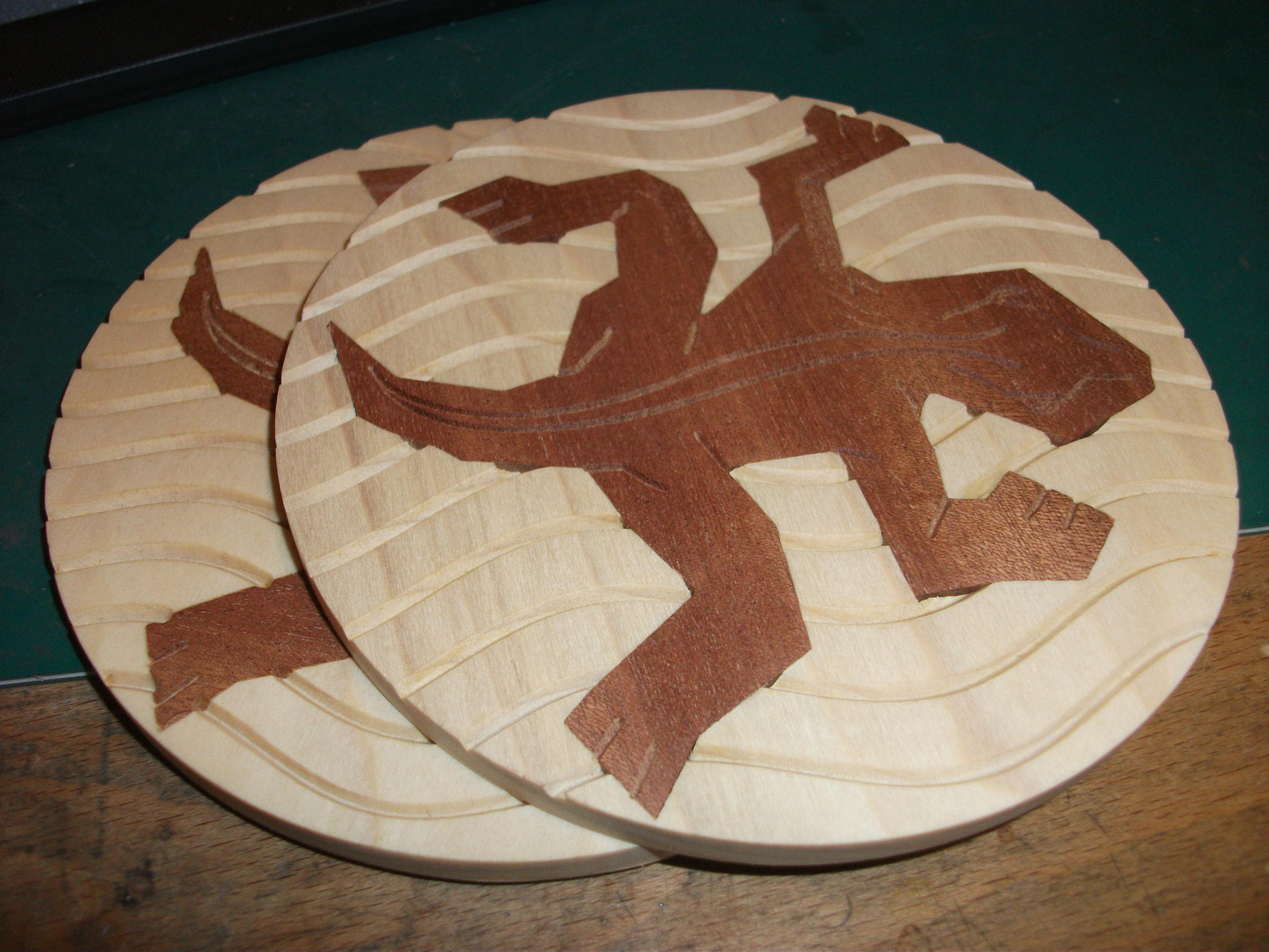

    I work to an accuracy measured in Angstroms +/- a foot.
    This is good enough for me, it is only woodwork
