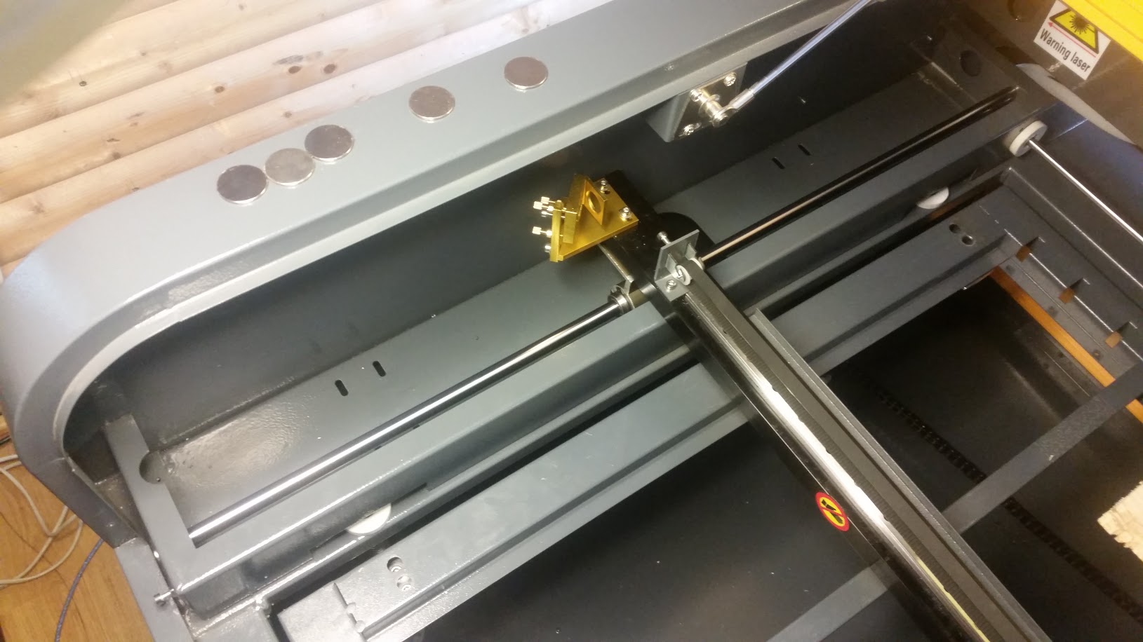

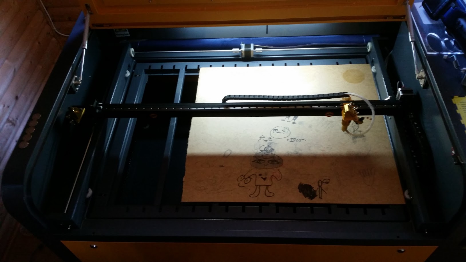

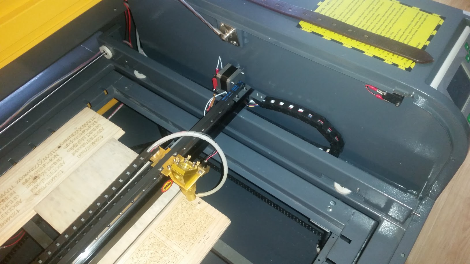

    Electronics are not the problem - Controller+front display panel (RDC6442S), 2x stepper drivers (0.09-1.13A M415DRV), 24V psu, laser tube HV psu (MYJG100W), 2x nema17 sized motors (cant identify by marks). Motors/drivers can be replaced if needed. For now it works.
    The motion is another matter. If anyone is familliar with K40 laser construction, mine is that scaled way up past reasonable limits. K40 is 3020 bed, mine is 9060, runs on same XY essentially. Which is BS.
    Problem is there is so little space and no continuous plane to put down reinforced rail on right side.
    There are bed lift bearings located in the floor of 70mm wide space could have been used for rail. Same 70mm space houses drive belt, drag chain and said lift upper bearing blocks.
    Any way to put down reindorced rails are to raise them off the deck somehow.

    I'm sure they are. My problem with them is i cannot be sure of their specs. Model/serial numbers do not exist on "Smooth" manufacturer website. Nor anywhere on t'intertubes for that matter, aside from what I'VE posted...
    Drivers came preset to 0.5A which suggests weak motors. Looked about the net for replacements, seeing nema17 sized motors up to 2A, 1A being more or less norm. So why 0.5A on mine ?
    Right side is completely unsupported. The only things holding in "in position" are one plastic wheel pulled by gravity and drive belt. I can lift the gantry off the "rail" by 5mm. Right side motion is effectively restrined only on the left rail. So yeah, racking. But not to the point of stalling. I'm getting oscillations in straight and curved cuts. Resonance wave. Changes angle from speed to speed, but always present.
    The engineering issues there are the poor rail and bearings and the belts not being synchronised properly, the plastic wheel is a good engineering solution if the rest were adequate.
    I think you should get someone to look at this for you as you are considering changes which, at best, may not help whilst not addressing the primary issues.
