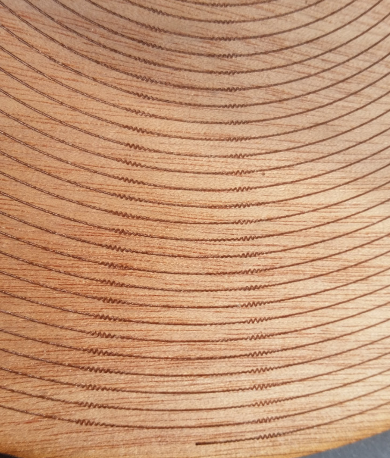

    This is what i'm battling:
    https://photos.app.goo.gl/32mNoD2Wcsz9pnzEA
    Note letter W in my text speed tests. Even straight angled lines getting the wobble.
    Circles (or spirals in my tests) exhibit same vibration patterns radiating out from the centre of ALL cut tests.
    The accelleration has been knocked down in half from factory defaults, lowering them any lower makes machine sluggish and controlling tube power becomes an issue (sharp corner overburn, slow decelleration/accelleration induced).

    This image says a lot...
Name:	Screenshot 2019-08-02 at 13.32.54.png
    It's unclear from some of the other pictures, but this one is particularly interesting as it would appear to show the distortion on spokes projecting radially from the spiral centre, and at a position where the Y axis velocity is tending to zero or accelerating from zero. Is this true of other images? (they are less clear).
    Could this be related to torsional elasticity of the couplings/Ali extension bars on the Y-axis?, is it worth trying to drive the two belts separately with two steppers, and removing the length of Ali bar?
