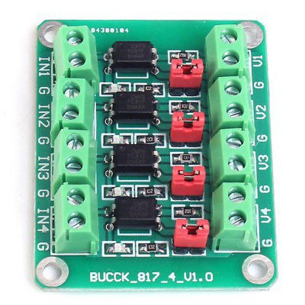

    I'm hoping someone can point me in the right direction. I have an axbb which is great btw, I also bought a cheap 5 axis Bob to connect to port 3 to give me more inputs for the control panel. I thought I would use the additional outputs to light the control switches to show their active state and bought a cheap 4 channel opto isolator for the job. The Leds on the optoboard switch on when I activate the output but I can't seem to get the switch lights to work on the output side of the opto? I connected the output side G to -0v(24v) and the output side to the switch bulb with the other side of the bulb to +24v. Is this correct? Also I checked continuity on both grounds on input and output sides and they seem to be connected....is this right?

    going by your photo of the opto-isolator board it looks like the opto-isolators photo transistor collector is connected to the output terminal (U1, U2 ,U3 ,U4 ) via a resistor
    the photos resolution is too low to read the value
    can you either post a photo that shows the 3 numbers printed on the resistors or just say what the resistors are in your reply

    In operation, the internal LED translates current to light, and the internal transistor translates light to (essentially) current. The device has a characteristic called Current Transfer Ratio - which for an EL817 (cheap) device (and given the markings on the board a likely candidate for the devices you have) is specified between 50% to 600% (the variance is depending on manufacturing deviations, temperature, etc). Let's imagine a CTR of 200% - not unreasonable. Now, examine the resistor on the input to the Opto Isolator on the driver board, and what looks like a series-connected LED for status-indication. The resistor is likely to be rated to provide a forward current through the Opto Isolator between 1mA and 5mA (once upon a time likely higher, but modern LEDs have better efficiency and the trend is to reduce the forward current) - Let's say 2mA. With a CTR of 200% that means you can only expect 2mA x 200%. = 4mA through the collector/emitter junction of the transistor in the opto-isolator. Now, if your 24V panel indicator/switch is an incandescent lamp I'd expect the operating current to be around 50mA or so - so you're not going to get the required current to illuminate the switch. Additionally, there is a series resistor on the collector to the opto-isolator which is going to limit the maximum current available through the device.

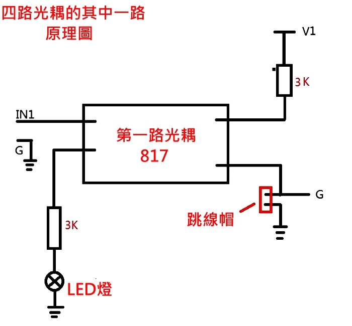

    found this circuit of the 4ch opto-isolator board online

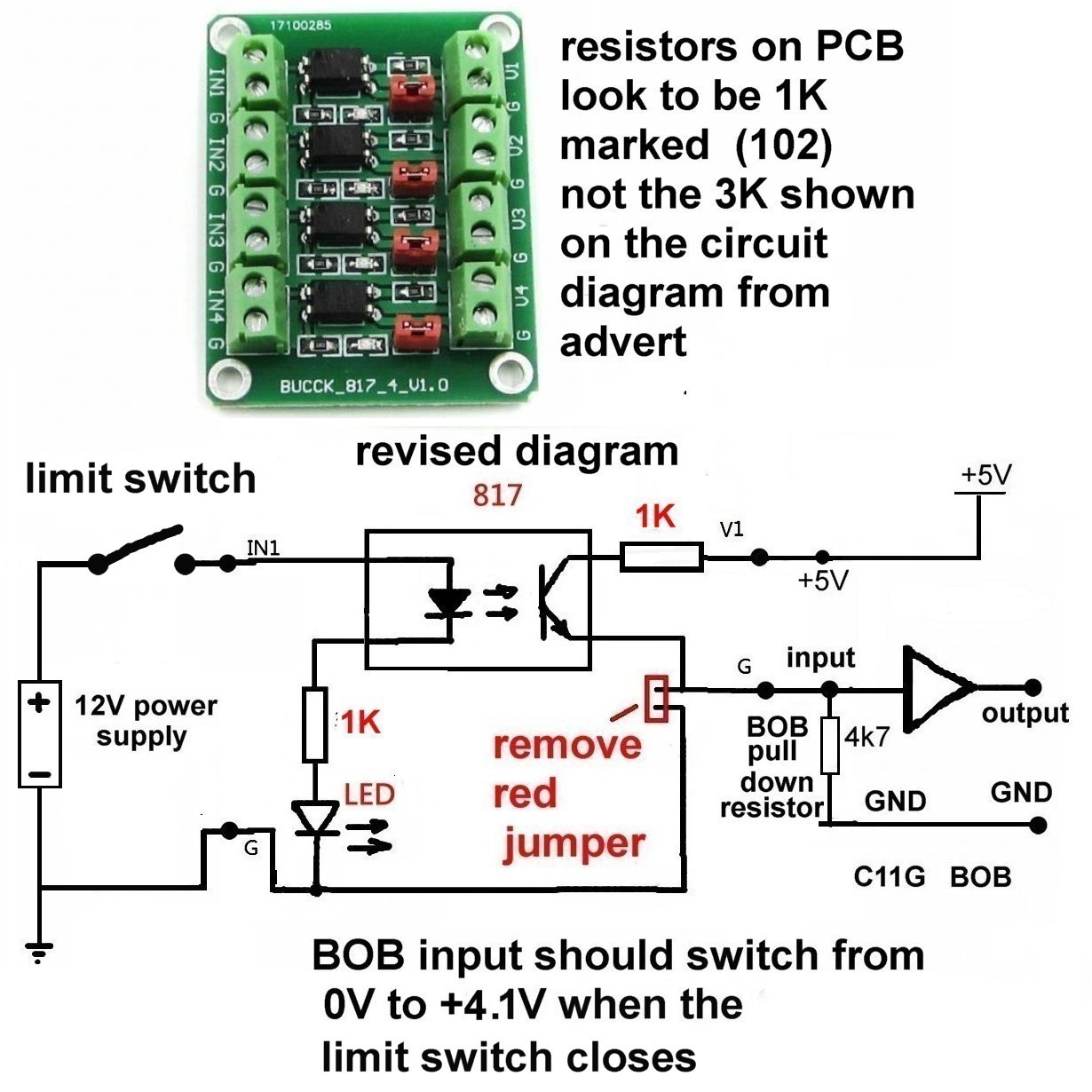

    looking at this photo it looks like the resistors are 1K (marked 102) and not the 3K on the circuit diagram !!!

    John
    PS

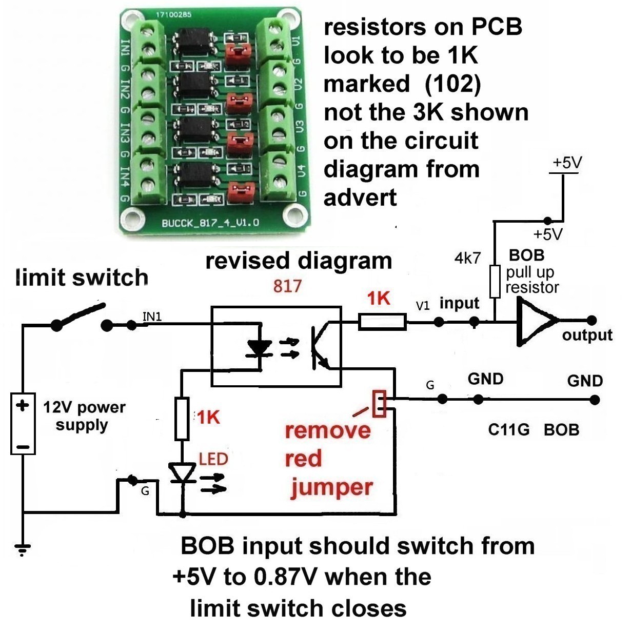

    once the details of the breakout board are known it will be possible to workout if the 1K resistor connecting the photo transistor to the output terminal will stop the BOB seeing the output switch
    PPS
    example
    two possible ways of connecting the opt-isolator board to a C11G breakout board
Name:	revised C11G and opto-isolator.jpg

Name:	revised C11G and opto-isolator v2.jpg
    revised diagram for your BOB can be made once I have details of the BOB
    with the 1K resistor on the opto-isolator board the opt-isolator board limiting the current

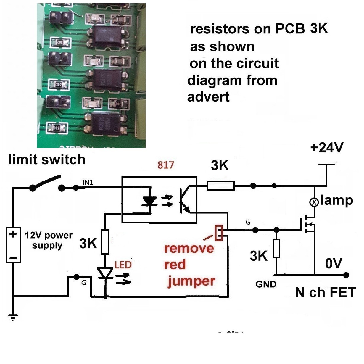

    looking at the photo of the opto-isolator board
    it has 3K resistors fitted as shown on the chinese circuit diagram
    so the output current is even more limited
    with a 3K or 3.3K resistor between the gate and source of the Fets you have you could wire the opto-isolator to pull the gate upto +12V (half of the 24V supply ) to switch the FET on
Name:	opto-isolator with FET lamp driver.jpg

    Cheers John, look what I just found... seems I may as well use them as I have them lying around
    Sent from my SM-G920F using Tapatalk
  12. #10
    it looks like you have all the parts to try it out with the FET
    the combination of the high value resistors and the gate source capacitance is going to slow the FETs switching but for this application it should be OK
    I usually use a 100 ohm resistor to connect the gate to a low impeadance driver
    (very like the 100 ohm "grid stopper" with valve (tube) circuits )
    John
