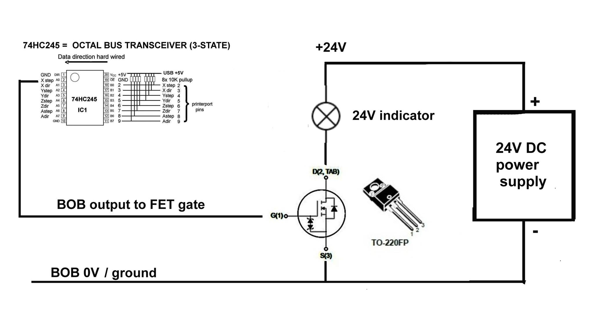

    ... or simplify the whole thing and bin off the board, any isolation and just use the mosfets. What’s the Vgs(on) for the details?
  5. The Following User Says Thank You to Doddy For This Useful Post:
  6. #14
    going by figure 6 on page 5 of the pdf data
    I would aim for a minimum of 5V
    while the absolute maximum ratings for Vgs is +/- 30V
    I would limit the maximum to about 20 V

    So how would the circuit look if I ditch the opto and connected the mosfet direct to the 5 axis Bob? You'll have to excuse my lack of electronics knowledge, I've occasionally dabbled over the years but i always forget what I learnt!
    Sent from my SM-G920F using Tapatalk
  9. #16
    you should be able to connect the BOB directly to the FET
Name:	CNC BOB connection to FET.jpg
    the 2N7000 would be an alternative FET in a smaller TO92 case

    Optically Isolated means the input has no current flow or connection to the output, a lot like a Relay!
    By using one wire on the output you are connecting your wires to a floating point in your circuit!
    The outputs will not work unless both connections are used, you need a common ground or common live to one side of each output in order for there to be any signal at the other side of the output! :D
  13. #19
    I was connecting both :) I would of expected the resistance to drop when the opto was activated but nothing seems to change! Anyhow I'll ditch the opto and just use the mosfets
