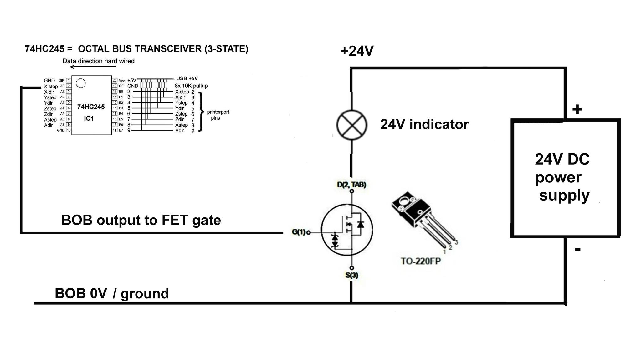

    I have had a quick look at the various arduino boards available
    this looks like a ready made you can use (amazon are out of stock but it appears to on sale from ebay )
    https://www.amazon.co.uk/d/Wall-Sock...ino/B01MRQFYJN
    hi res readable picture from amazon advert

    the small 16 pin IC is a quad opto isolator - part number PS2801-4

    Wouldn't a relay board be easier?
    https://www.ebay.com/itm/1CH-2CH-4CH...H4U4QOng0awJrg
