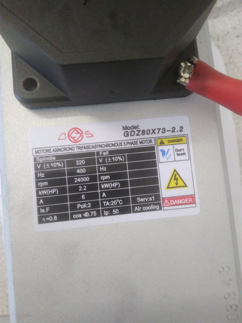

    Hi again ... A P.S. to my first post. On the motor specification plate there is some information that I don't exactly know how to use - and as I am thinking that maybe it matters in this context I have attached a photo of it here ... Hope you may just take a glance at it.
    Cheers & thanks,
    Jesper

    Have you read this forum for the correct VFD parameters?
    Hi paulus ... Thanks for the tip! I have now looked and set up my drive similarly. There wasn't really many differences between the settings that were already in place so I guess this is not what causes the vibrations. But thanks again for the tip ...
    Jesper
