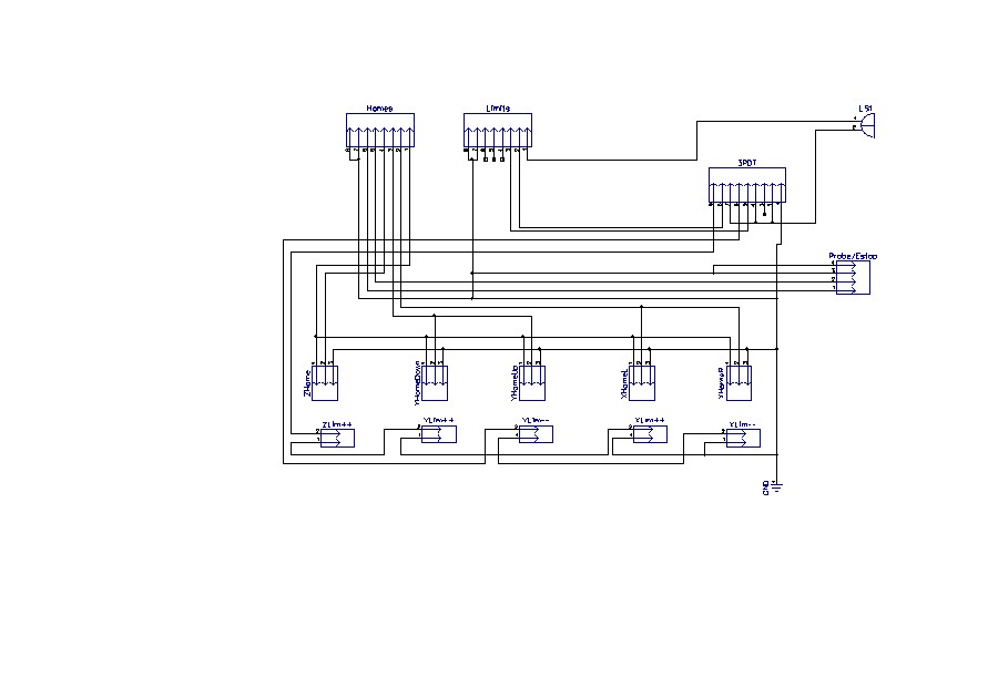

    More seriously, I've recently changed from using Eagle, where I never quite mastered the libraries and creating new footprints for the PCB, to DipTrace which is a bit easier to use and does have a free-for-non-commercial-use version if you look carefully enough at the website. I've only made one board with it so far but I like it so far.
    Kit
    I tried out Dip Trace last night after getting nowhere with KiCAD. Within an hour or so I had learned enough to create a schematic
    and this morning create the Gerber and drill files to manipulate with CopperCAM to give me the Gcode to make the board.
    All I need now is the machine back together to cut the board.
    Cheers,
    Rob-T

    It is not down to clever - Dip Trace is quite easy and there are online tutorials. So for me it was 'Monkey see, Monkey do'. Once I got to the Gerbers then CopperCAM did the conversion to dxf and then Estlcam to Gcode.
