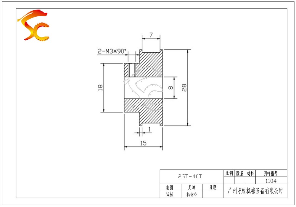

    Re-designing Y axis motor to shaft belted transmission for gt2 belts.
    I need to accomodate existing shaft placement and need 40T pulley dimensions.
    8mm shaft centre is ~30mm off the deck.
    Looking for GT2 pulleys on ebay and no one lists external dimensions for the pulleys they sell.
    Anyone got one to give me outermost diameter ? Flanges and all.
    At the moment trying to do nema23 motor 20T(6.35mm shaft) to 40T(8mm Y drive shaft) 10mm GT2 loop belt transmission in place of inline nema17.
    Dont have much space to play with...

    I think the problem your going to have is not every GT2 40T pulley is going to be the same exact dimensions, so can only suggest you get the one you want to use in your hands first and go from there.
    Looking at what is out there, most seem to be in a close size range to each other, so attached is drawing you could use strictly as a guide to give you an idea of what you may need to accommodate.

    Recently i learned that GT2 pulleys are tricky in my case.
    I need to get a pulley that is 40teeth/10mm wide belt/8mm bore. And i cant, for the life of me, find one.
    It is either gonna be 6mm wide belt or 5mm bore... Starting to pull my hair out (whats left of it anyway).
    I dont know anyone with a small lathe to bore it out, no point going back to 6mm belts as machine is supposed to be fast (not a 3d printer, that crawl.).
    Its a "pick 2" triangle situation. Gah.
    Thanks for the drawing, btw, thats all i needed - an approximation.
    Since shaft center runs about 35mm above "floor" i can stick in whatever doesnt exceed 55-60mm in diameter.

    Is this not the perfect match for what your looking for: https://reprapworld.co.uk/products/...GT2 pulley (40 teeth / 9 mm belt / 8 mm ID)
    £8.20 all in but only 19 in stock so you better be quick lol
    And you do know someone with a lathe who can bore things for you, you have hundreds of members on this forum with lathes ready to help other members for a little bit of bear money, just put a RFQ up when you need one, see link:

    Anyone can bore any pulley to any size.
    Usually, UK suppliers charge 2-3 for boring to whatever.

    Sorry I gave you a link I had stored - Beltingonline do a big range of different types of belt/pulleys and do give accurate dimensions and will bore to order so I thought they might be able to help. AT5 is a larger tooth pitch (5mm vs 2mm) than GT2 and I was advised that they're about the best for backlash at a sensible price. But with the larger tooth pitch, for the same number of teeth they'll be propotionately bigger diameter so you might have fit problems - and if the other pulley in the system is GT2 then you'd obviously have to change both.
