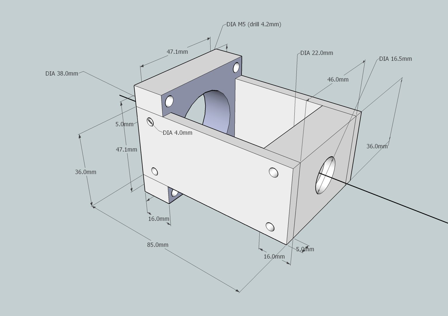

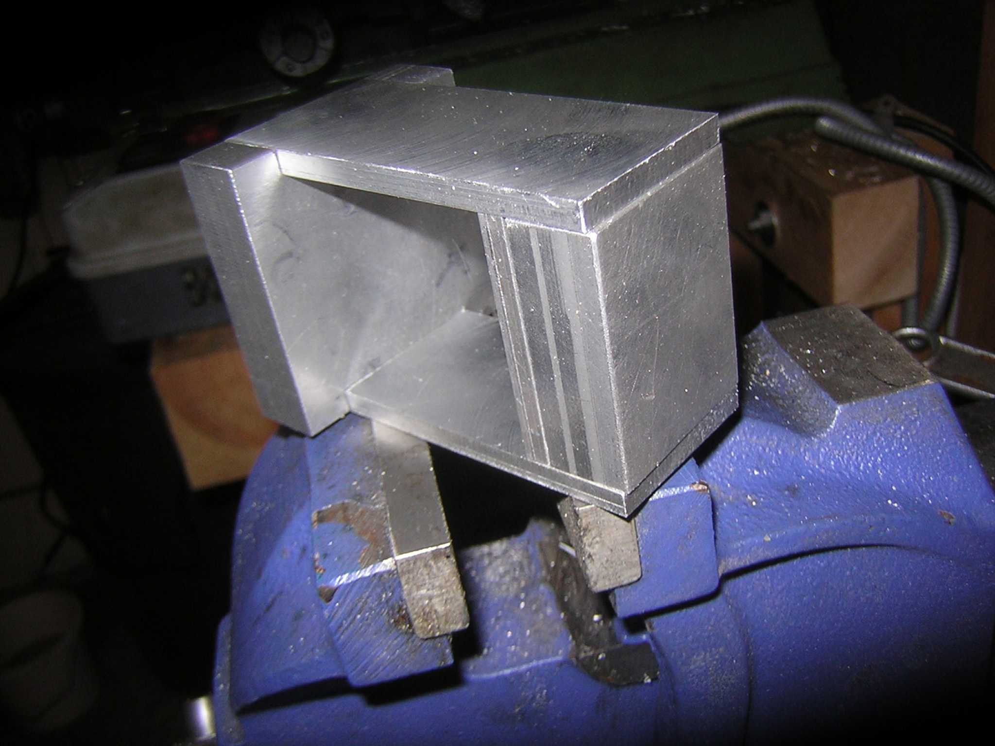

  1. For ages now I have building a small MDF-based mill for making PCBs, as a project it has sort of stalled, with just the base, table and bits of the gantry cut but not assembled. Today I had some time to spare so I set about making my motor mounts, well one of them...
    In the meantime, the base unit as it was a year ago (and still is) can be seen in [ame="http://www.mycncuk.com/forums/showthread.php?t=305"]this thread[/ame], and here are the drawing of the motor mount, and the partially completed mount before drilling and boring...
    I hope to add to this log from time to time and finish it before Sept 2010!
