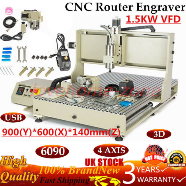

    Thanks for the detailed answer. I have a 32bit PC with windows XP. I know how to switch on the spindle controler and there is a "Thud" from the table then nothing happens. so i turn it off get angry and throw spanners and screwdrivers about. I am useless at following instructions. I NEED to see some one operate one. further info it is a CNCEST 6090. with no istructions for build and what i have found out i have to set the spindle some how? Hopefully someone from south wales see this post.

    what does your machine look like ?
    if its like this
Name:	6090  CNC router.jpg
    It could be close enough to some of the 6040 machines
    some members have for them to help
    Next question is how is it connected to the PC ?
    via a PC parallel printer port or a USB port ?
    because different manufacturers use different electronics
    photos of the inside will help identify what you have
    some use an all in one 3 axis driver and breakout board plus a
    single driver for the A axis /4th axis
    others use four seperate stepper drivers and a breakout board
    the advantage is if you damage a X,Y or Z axis driver you don't have to replace the all in one board
    the down side you have a little more wiring
    newer machines have a built in USB motion controller
    that needs the correct "plug in " (software patch) for Mach 3 to work
    this replaces mach 3's pulse engine that has low level control of a PC's printer port when your using 32bit windows XP to vista if I remember correctly
    Mach 3/4 can not work with 64 bit windows
    or any version of windows 10
    John

    OK
    from the picture of the rear of the control box I see it has a USB interface to the PC
    unless you have installed the correct "plug in " supplied on a CD that came with the machine
    mach 3 will not to be able to control the machine
    a picture of the board with the USB connector may help if a member recognises it
    John

    Hi Brummie,
    I have found a software download for a 4 axis USB Chinese machine. With a ton of luck it could work, but you will probably need a computer whizz-kid to set it up. Anyway, it is the best I can offer for now.
    https://www.chinacnczone.com/en/mach..._l282_p15.html
    Hopefully - and it is big hope - the Chinese machines with USB use the same controller.
    The fact that your machine thuds when you switch it on means the motors are connected and the drivers enabled, so that is a good sign.
    Best of luck,
