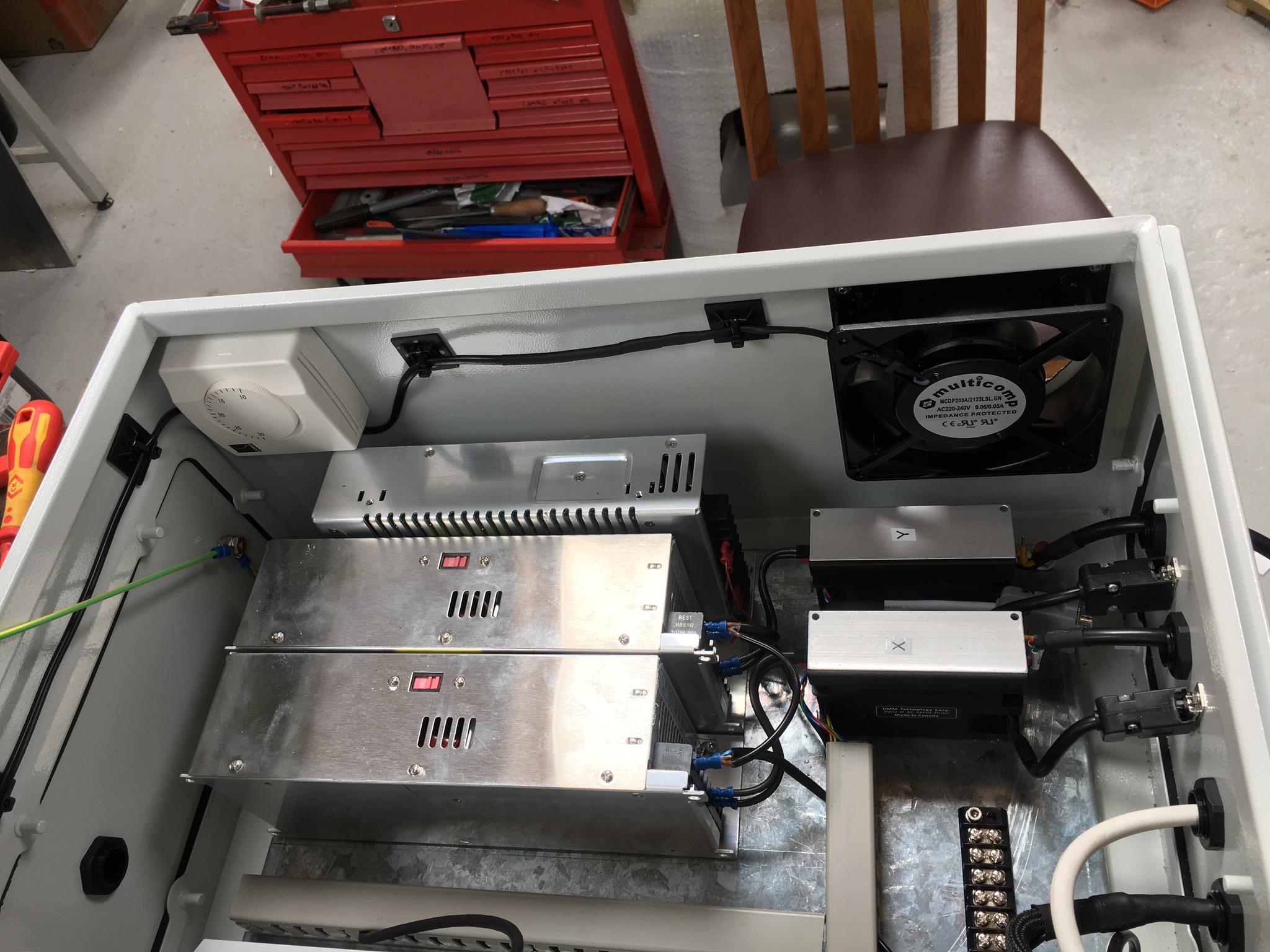

    It's got to be better having the VFD inside a steel cabinet from an EMC (electrical noise) POV, as well as making a neater installation. In both my machines, I have the VFDs mounted inside and have a fan to ensure they can stay cool. Rather than have the fan powered all the time, I have a simple central heating thermostat to turn it on when / if the air temperature exceeds a threshold which is something like 40C. There's an exit grille with a foam filter above the VFD and the fan is mounted near the bottom of the cabinet.

    Inside an enclosure is good, check the manufacturer's requirements though as adequate cooling is essential.
    Unless your VFD is really shoddy the majority of EMI is carried through wiring, not the air, although proximity will mean short cable runs and may require a filter on each mains equipment input in the box and shielded cable from the VFD to the motor is advisable.
    Outside is fine though, I've run a benchtop CNC mill for about 7 years with the VFD mounted to a bracket on the spindle motor without any issues and my lathe VFD is mounted next to the DRO display with a tacho on top of the VFD, that's worked fine for 20 years or so :D

    Most VFDs don't have filtering incorporated, as it's expect you will fit whatever is appropriate for the final installation. Consequently, many hobby installations don't bother unless there is an issue due to the electrical noise.
    I fitted Yaskawa V1000 drives in both of mine. They didn't actually cost a lot more than the Chinesium equivalents and you can buy EMC filters that are tailored for those specific drives. They may not guarantee 100% compliance with EMC regs as such but are going to get you in the right ballpark. Certainly, I have not had any issues. This is how professional installations are constructed, rather than simply locate the VFD on the other side of the shed(!).
    Getting everything into one cabinet makes for a tidier installation and allows you to construct it on the bench where access is a lot easier. It's a personal choice but I like the end result to look reasonably professional.
    One of the main ways in which noise will get coupled between parts of the system is by running cables next to each other. I wanted to make everything neat by having all the cables for the spindle, motors and limit switches running through one set of drag chains but this is obviously the worst case for this. At one point I had the spindle feed looped up with the dust extraction hose to keep it separate but wasn't happy with it. This is why you want to screen all the cables and ground them to a single point at the control box/VFD end. Capacitors in parallel with the limit switch inputs to the breakout board are a great help as well. My understanding is that it's the high frequency, high amplitude noise from the stepper and spindle drives couling back into the limit switch inputs and possibly then into the controlling computer that are the main risk.

    Yes, screening (and grounding the screens) is just good practice. Most drag cables have sets of screened cores within a screened bundle, so you can run signals and steppers etc in the same cable. Good idea to run the VFD>>motor separately though. Decent quality CNC controllers are fitted with noise filtering on the IO, so additional measures shouldn't be necessary if you have a good construction and follow good practice.
