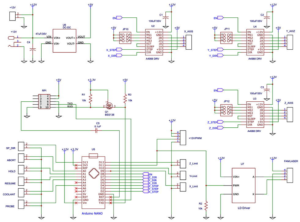

    just found this circuit diagram for one version of a Grbl board
    with plug in A4988 stepper drivers and a plug in Arduino NANO
Name:	Grbl board.png

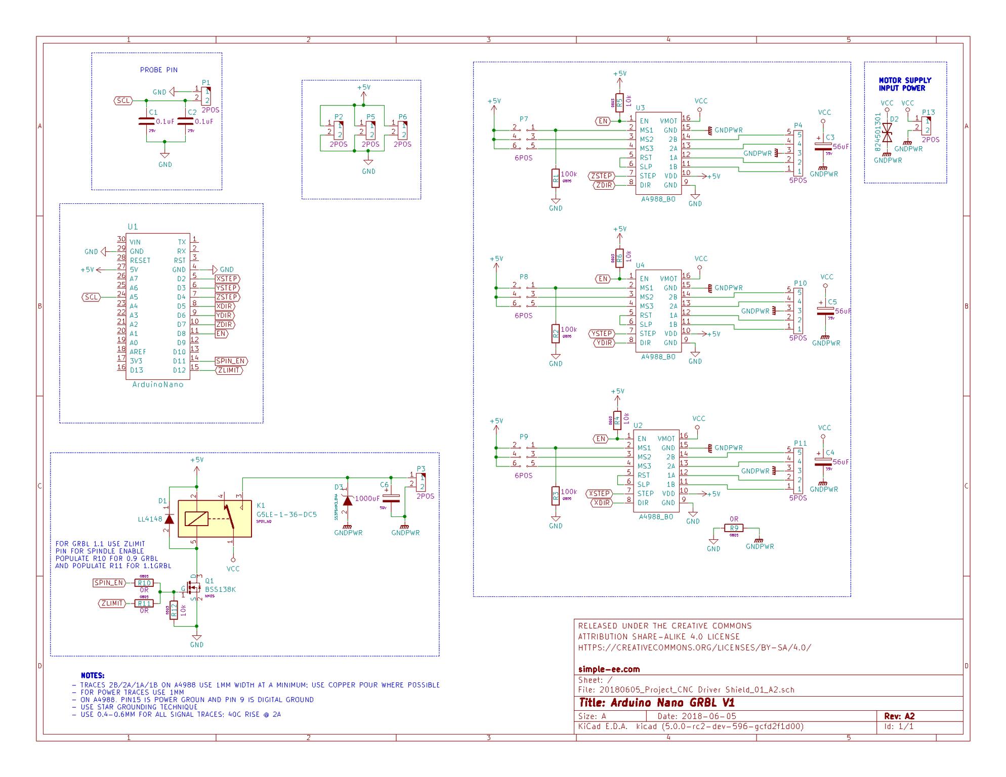

    another Grbl board with a relay to control the spindle motor
    https://simple-ee.com/2018/06/20/pro...troller-board/

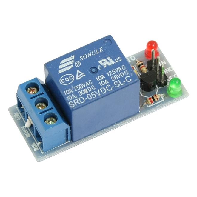

    the only thing missing is the FET to switch the spindle motor on and off
    with the arduino cnc sheild you have just linked to you can connect either a FET module or relay module to add the spindle on/off control
Name:	5v relay.jpg
    John
