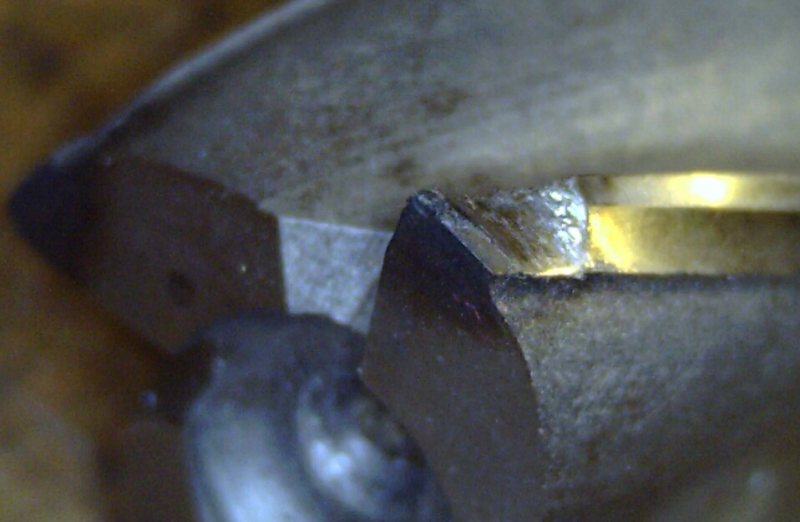

    Thought I'd make the new spindle lock arm for my mill last night, a simple 2D outline in 1" thick steel. 9 cuts on a 2.8mm increment with a 3/4" end mill.
    All went swimmingly until the last cut when the tool suddenly went red hot and blew it's edge. It had dropped below the suds jet and wasn't getting quite enough.

    The mill came with a screw shank collet chuck and I have become strangely attached to this particular cutter for some bizarre reason that I can't quite seem to fathom.
    I usually throw them away when they become blunt. Hopefully I will remember to turn the speed down a couple of notches before resuming the cut :whistling:
