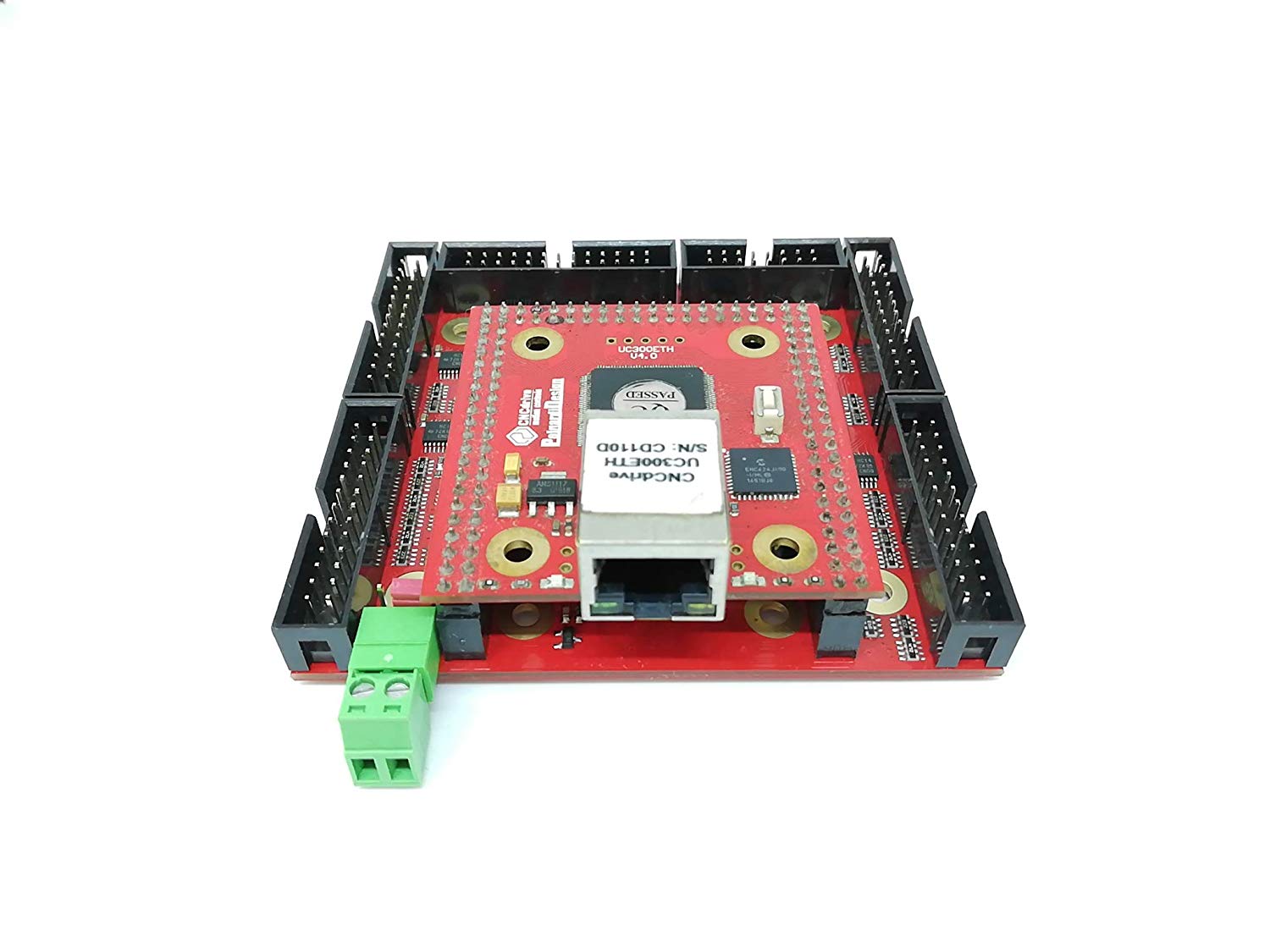

    I have a uc300eth-5lpt controller board. I've been doing a lot of research on it to be careful of not burning the chip. But I reached a question which I don't really know the answer to. Would there be anyone who knows how hot the uc300eth ic can get before it may become too hot? And what I mean by too hot is that the ic may become disfunctional or burn??

    I'm not really sure what's considered hot. When I plug it in (and Don't run anything) it's ic temperature continuously increases and I stopped it at 102°f (38.9°c). I know that's a safe number but I just want to be extremely careful because I don't want it to keep increasing and burn out the chip (considering that I don't know what temperature is considered safe). That's why I asked because I don't want to let it continue climbing in temperature until it's too late. But does anyone know if there's a safe temperature range for the uc300eth ic?? I couldn't find one in the manual....

    For commercial grade semis then you can expect an operating temperature of the silicon die of 85C, and there was a general rule of thumb when I was a lad that you halved the MTBF for every rise of 10C above this. Note, I'm talking die temperature and that is not the same as the package temperature (which will likely be less, depending on environment). Of course what should be measured is the temperature increase - if your ambient air temp is 39C then a die temperature of 40C is less of a concern than an ambient of 10C.
    BUT, the question you should be asking is more why the micro controller is getting warm. Actually, 40C isn't particularly hot, though I cannot recall ever fingering my UC300eth whilst in operation - I don't think it gets particularly warm (and I'm not about to strip it down to check). What you seem to be indicating is that the temperature of yours rises quickly and you expect it to continue to rise if not de-powered. That would concern me a lot. Is this a new device?, do you know if it is functioning correctly?, have you tried this with nothing connected to the input/outputs from the board?

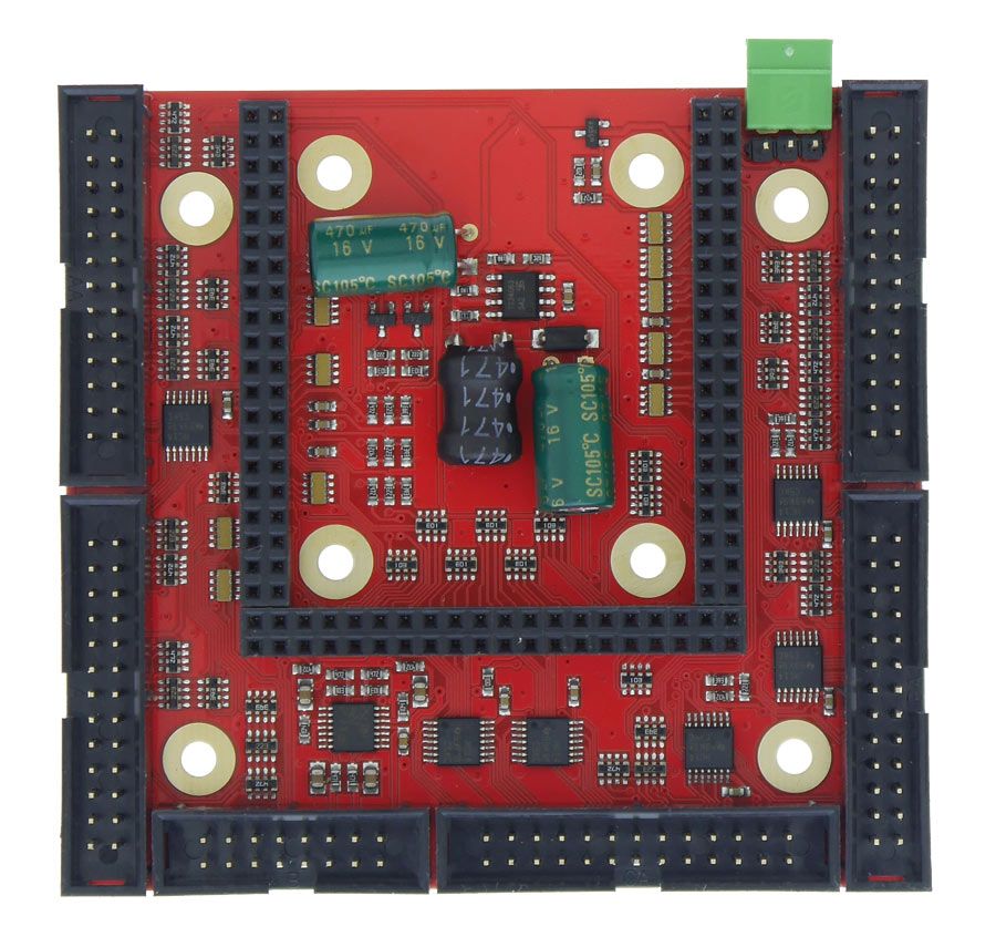

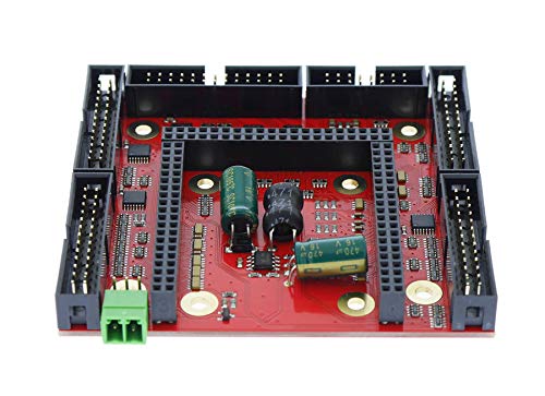

    After a quick look at photos of the uc300eth motoin controller board and
    5lpt mother board board
    It does not look like all of the uc300eth outputs are buffered
Name:	UC300ETH ETHERNET MOTION CONTROLLER.jpg
Name:	5LPT-UC300 Motherboard.jpg
    How are you connecting your stepper drivers to the 5lpt mother board board ?
    If for example your using a breakout board with 74245 octal buffers
    to connect the uc300eth to the stepper driver inputs
    the load on the uc300eth outputs will be reduced and have a measure of protection

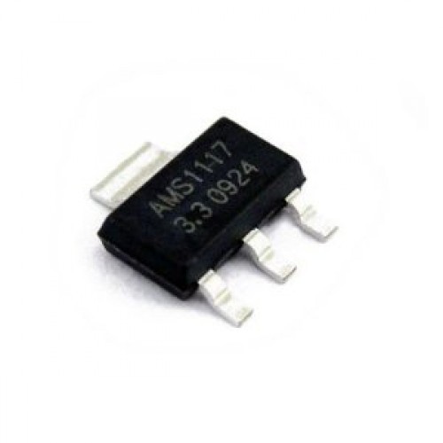

    Reducing the load on the uc300eth will also help to reduce the heating of the linear 3.3V regulator
Name:	LMS117-3.3V SMD Voltage Regulator.jpg

    Hi Doddy
    not sure we are looking at the same board
    the picture of the 5LPT-UC300 Motherboard
Name:	5LPT-UC300 Motherboard 2.jpg
    I am looking at has seven 14 pin IC's
    possibly non inverting hex buffers ? (74HC365E ?)
    [ with 6 inputs , 6 outputs & 2 supply pins ]
    or 7414 inverting hex buffer found on some breakout boards
    octal buffers like the 74245 have 20 pins -
    8 inputs, 8 outputs, 2 supply (Vcc & Gnd) , 1 enable & 1 bi direction data control
    John
    PS
    Just downloaded the UC300ETH manual (again) and see
    2 ports have 12 outputs (like a PC printer port ) and the other
    3 ports have only have 4 outputs
    giving you a total of 36 digital outputs
    so 7 hex buffers gives you 42 digital buffers to be used to buffer the micro controller
