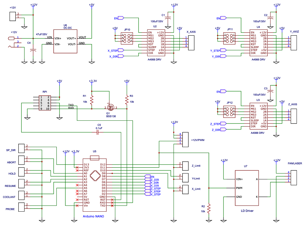

    just found this circuit diagram for one version of a Grbl board
    with plug in A4988 stepper drivers and a plug in Arduino NANO
Name:	Grbl board.png

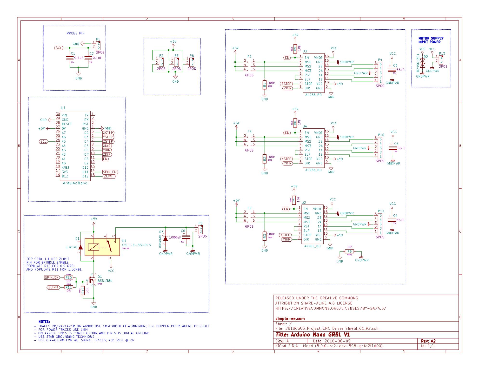

    another Grbl board with a relay to control the spindle motor
    https://simple-ee.com/2018/06/20/pro...troller-board/
