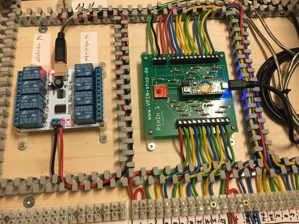

    Looking at ways to keep my cabinet wiring as tidy as possible. It seems to me that cable trays of some description are the way forward, with the aim of setting up a number of 'roads' up and down and left and right across the panel. I like the way Joe used the cable comb stuff, but not keen on covering it all up at the end. I'm also not keen on those cable spirals as getting a cable in or out seems like a nightmare.
    Next option I guess is lots of cable ties, which on my aluminium back plate would require rather a lot of holes... Also the changing the setup problem.
    I've come across this stuff (see attached image) which I quite like....
    https://www.digikey.si/product-detai...987-ND/3815064
    Any comments on that stuff?
    Am I missing a trick? Is there a better solution out there? Come on guys - let's talk OCD cabling solutions!!Click image for larger version.

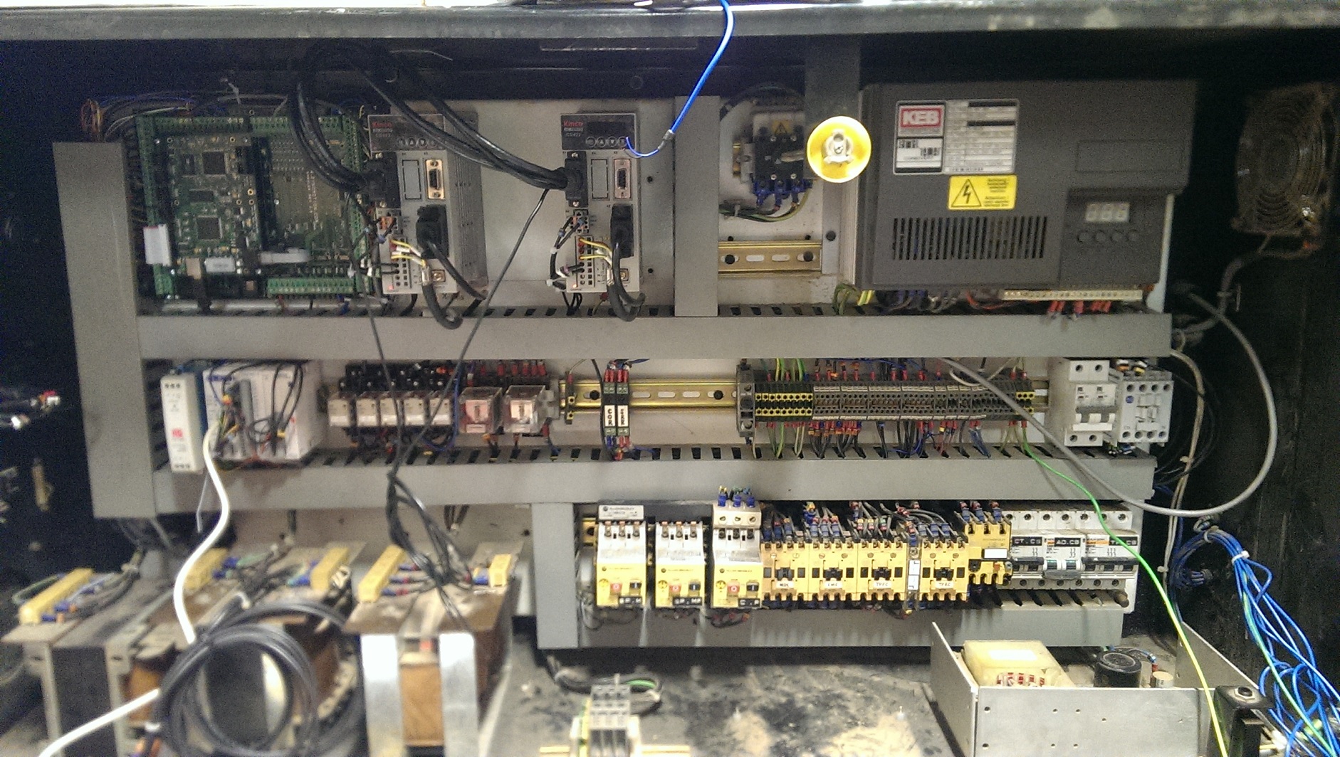

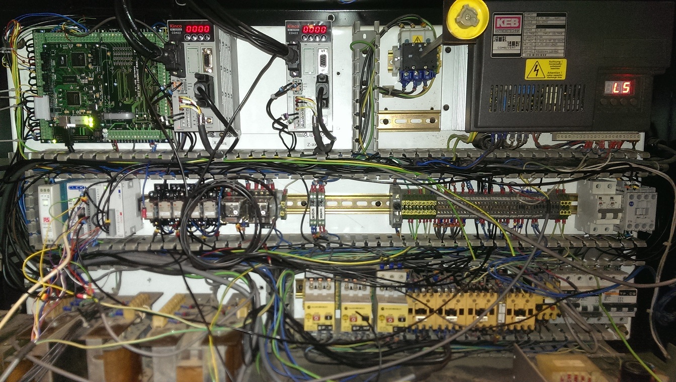

    To give an idea of how good trunking is, here's a couple pics from my lathes cabinet during it's retro -

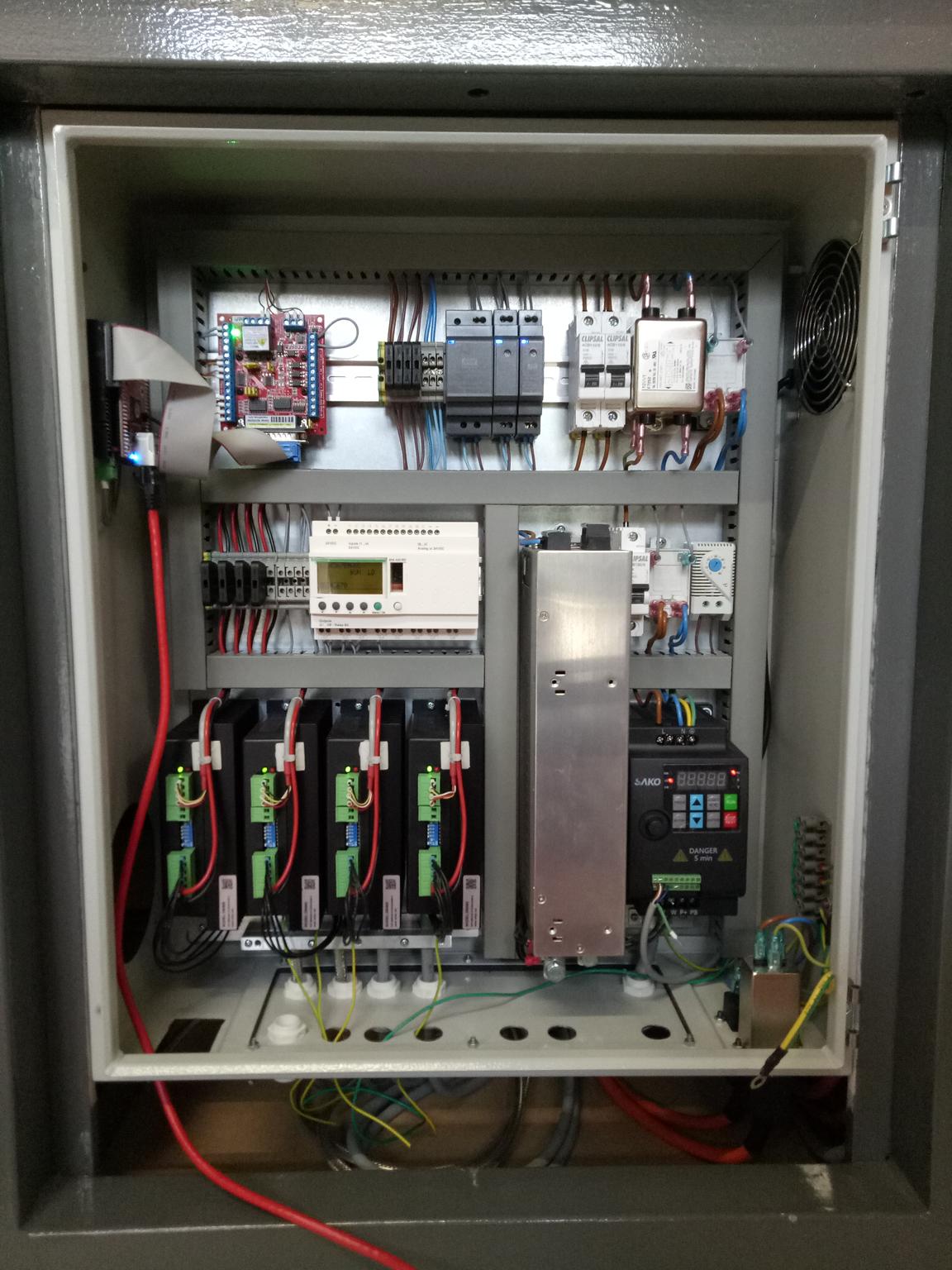

    Slotted trunking is the best for sure. Take not you get different widths of slots, i usually use narrow slotted trunking.

  10. #8
    25 w x 40 H from rs components 878-1148
