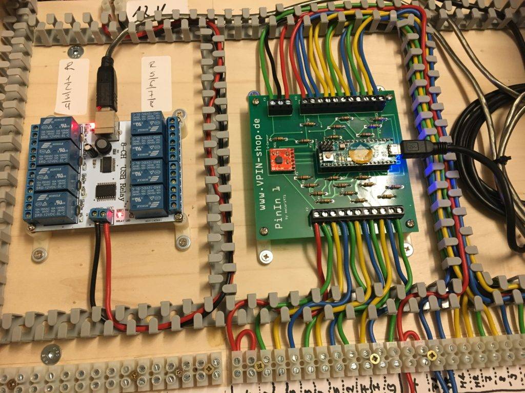

    Looking at ways to keep my cabinet wiring as tidy as possible. It seems to me that cable trays of some description are the way forward, with the aim of setting up a number of 'roads' up and down and left and right across the panel. I like the way Joe used the cable comb stuff, but not keen on covering it all up at the end. I'm also not keen on those cable spirals as getting a cable in or out seems like a nightmare.
    Next option I guess is lots of cable ties, which on my aluminium back plate would require rather a lot of holes... Also the changing the setup problem.
    I've come across this stuff (see attached image) which I quite like....
    https://www.digikey.si/product-detai...987-ND/3815064
    Any comments on that stuff?
    Am I missing a trick? Is there a better solution out there? Come on guys - let's talk OCD cabling solutions!!Click image for larger version.

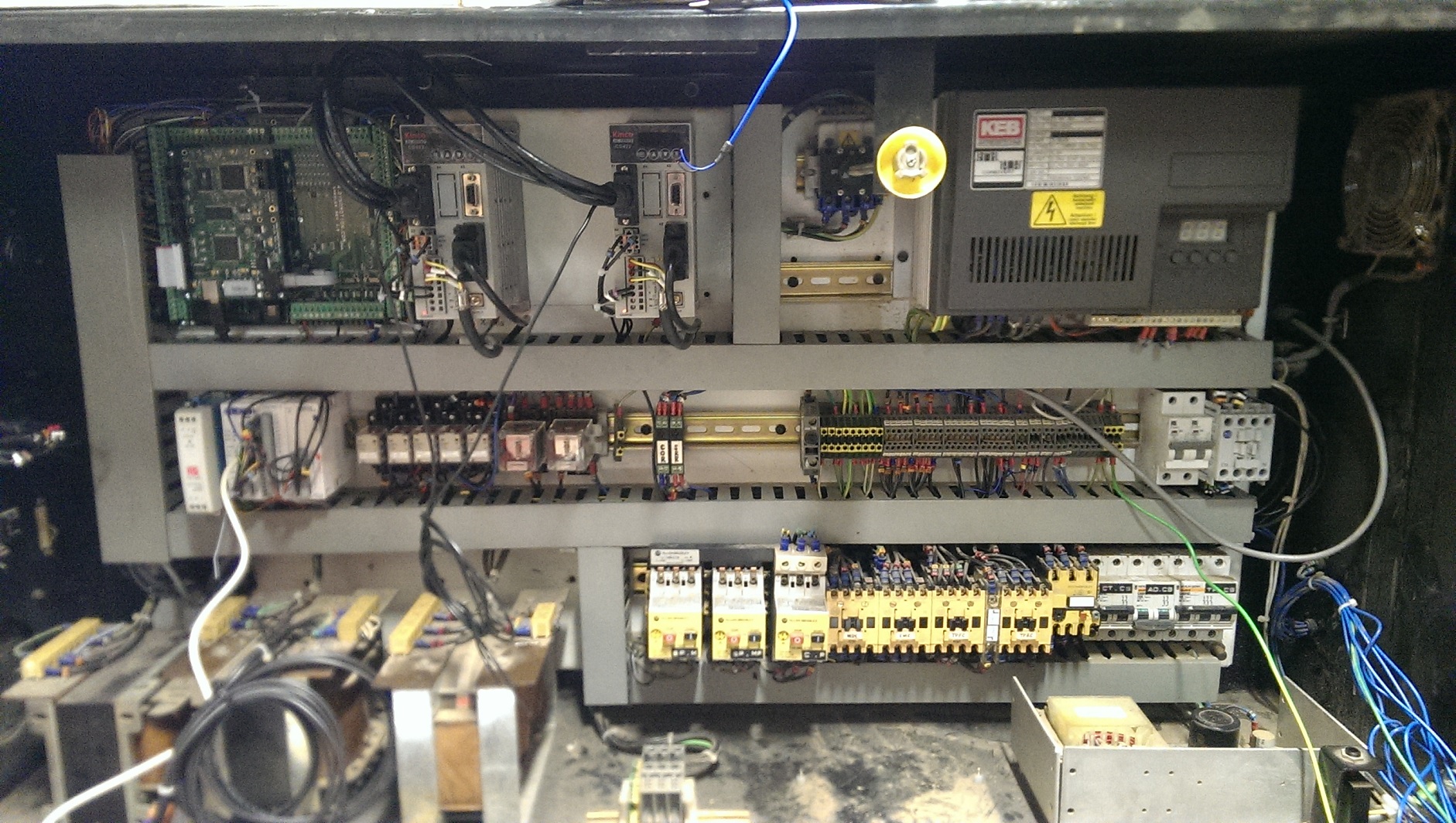

    Cable trunking that Muzzer linked to is far better for hiding excess cable, and is probably the easiest to get into if you need to change anything.
    To get neat wiring with only cable ties involves being very accurate with wire lengths, and if you do need to change anything, you normally need to cut and replace quite a few cable ties.
    To give an idea of how good trunking is, here's a couple pics from my lathes cabinet during it's retro -

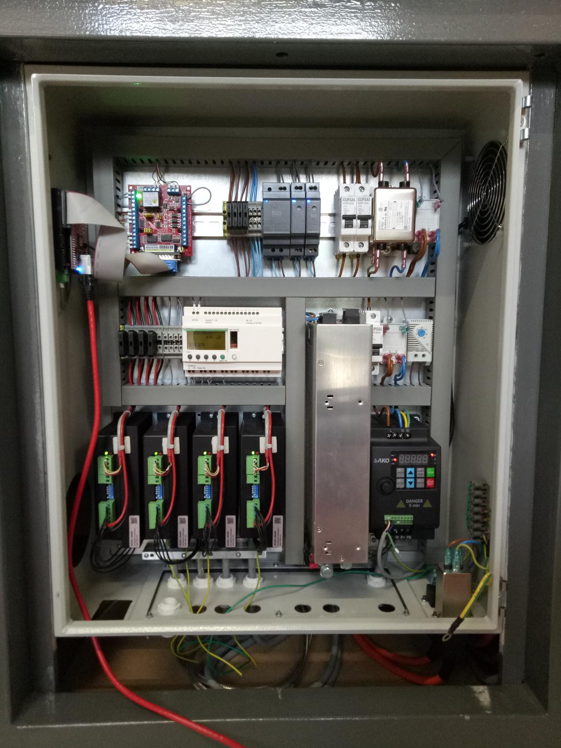

    Slotted trunking is the best for sure. Take not you get different widths of slots, i usually use narrow slotted trunking.

    Thanks Guys, I'll take a more detailed look at the trunking - I think the narrow stuff would work well. I've just updated my build thread with my planned layout, so need to make a decision!
    Ericks, can I ask what the dimensions of your narrow trunking are? Looks about 20-30mm wide?
    Sent from my SM-G950F using Tapatalk
  10. #8
    25 w x 40 H from rs components 878-1148
