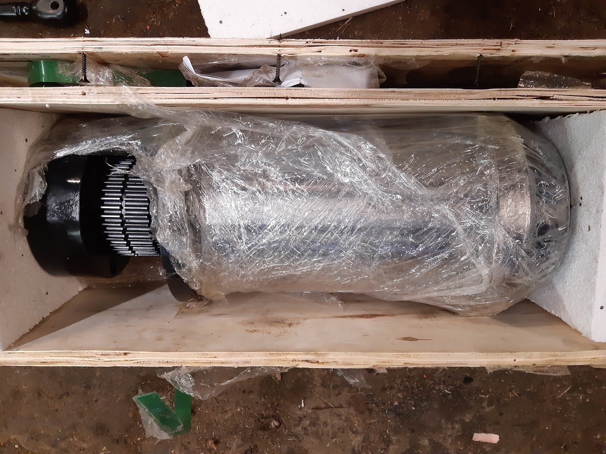

    This little 45kg lump got delivered today
    The basic design is slowly progressing. Not quite as quickly as I'd hoped, due to lots of distractions, and quite a bit of contemplation over what layout to go for, but I think I've now got the basic layout decided on. I just need to design it in Fusion to make sure it's going to work as I think it will...
    That looks expensive.!!!!!!
    Email: [email protected]
    Web site: www.jazzcnc.co.uk
    Lives in East Lothian, United Kingdom. Last Activity: 2 Days Ago Forum Superstar, has done so much to help others, they deserve a medal. Has a total post count of 2,992. Received thanks 376 times, giving thanks to others 9 times.
    Not quite as much as I was expecting, but the 4 servos, 1 three phase stepper drive, and 16:1 reduction gearbox for the mill were cheaper.
    However I did opt for Japanese bearings, and air freight, which was a third of the cost. I did wonder why the air freight was as expensive, until I seen the weight on the delivery label. No wonder the DHL driver didn't want to lift it out his van
