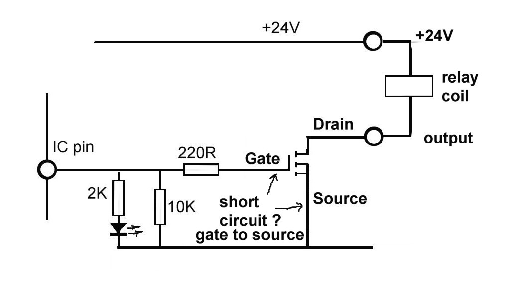

    I wired my machine to use the charge pump output so that the relay would only activate the motor psu if the software was active and not in a reset/error state. This has worked perfectly while testing until I tried it a couple of days ago. When I apply power the relay and therefore the motor Psu all spring to life. I checked all wiring and even stripped it all back to the bare minimum and tested again with the same issue. I have checked the charge pump isolated output and it appears to always be active even if the indicator LED is off? I have checked that the option to always enable charge pump isn't active and am now wondering whether it's faulty...does anyone have any other ideas?

    Assuming the output transtor is open drain and grounds the relay coil terminal to switch the relay on
    With the power off you can use a multimeter to check the resistance between the negative supply terminal and each isolated output
    in the manual
    http://www.cncdrive.com/downloads/AXBB_E_manual.pdf
    see diagram 9.1.2 .Connecting a solid state relay (SSR)
    test between 24V0 and Ox
    You should find they are all open circuit unless the transistor controlling the relay is short circuited

    Cheers John, I'll check the resistance tomorrow but one more thing I remembered. I also tried output 2 of the isolated outputs and that one does read the voltage change if I set that as the charge pump output however that one doesn't activate the relay? The manual states that the isolated outputs can drive upto 500mA so I'm assuming it's not enough power to drive the relay and the output 1 is different.

    what relay are you using ?
    any idea what the coil resistance is ?
    This one from RS Components has a coil resistance of 650 ohms
    https://docs-emea.rs-online.com/webd...6b815856e9.pdf
    If the RS StockNo:450-0425 relay was used with the AXBB and its 24V DC supply only 37 mA would flow via the AXBB output

    It looks like I'm getting approximately 100 ohms on output 1 to ground, all other outputs are open.

    The reference to " other isolated outputs are all capable of driving the relay "
    differentiates the outputs from the 5V logic level outputs that you connect to other logic gates or the stepper driver step & direction inputs
    from the open drain outputs designed to switch inductive loads like the relays

    It looks like the FET for output 1 has short circuited
    I would check you don't have a wiring problem that could connect the 24V DC to the AXBB output
    Did you check the relays coil resistance is 650 ohms as expected
    less than 48 ohms would pass more than the 500mA limit for the output
    John
