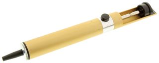

    if you melt the solder on all 3 legs by adding fresh solder
    a Desoldering Pump may well pick it up as well as the solder !
    https://uk.farnell.com/duratool/908-...tic/dp/3125646

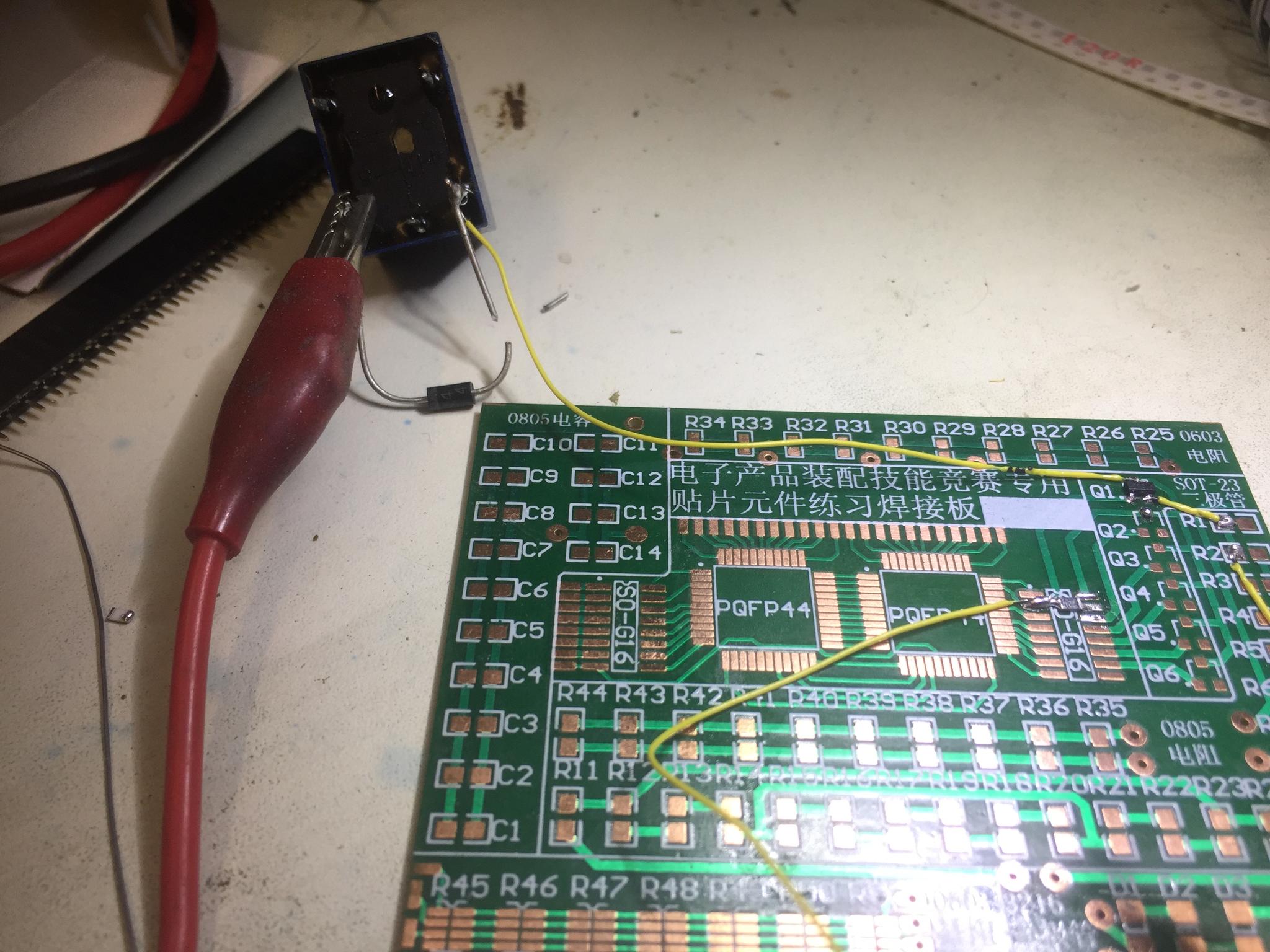

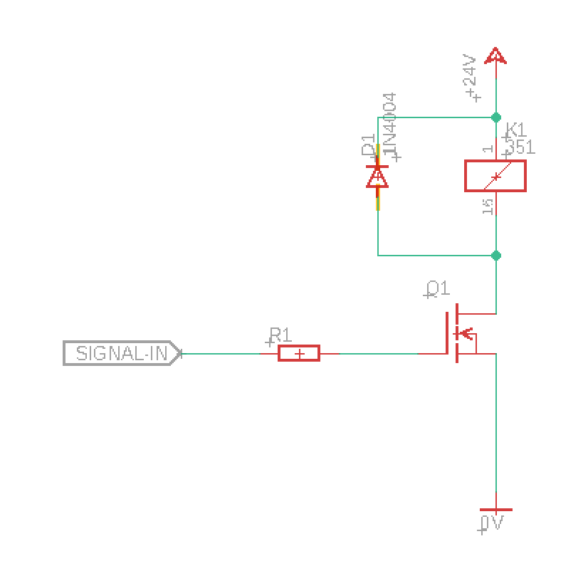

    Right, just tried a quick experiment - I have some 2N7002's in the shed so hooked one up to a signal generator set to 1Hz (though I ramped up to 35Hz out of boredom).
    Basic circuit...
Name:	Screenshot 2019-08-14 at 20.11.47.png
    ...using a practice board for SMDs as a breadboard...
    So, this ran for 5 minutes without fail.
    I then cut the diode (observed in image) to see if the back EMF would pop the transistor. I ran that for 5 minutes at upto 35Hz, with no failure.
    Out of interest, I wet my fingers and placed across the relay coil - this calibrated method of measuring EMF confirmed that there was OUCH! volts of back-emf. Recovering the diode did quench the back emf, as expected.
    I had expected the 2n7002 to fail due to the excessive VDS, but for the duration that I ran this it did not. The OUCH! test did confirm the expected high EMF present on the drain of the transistor.
    So, CharlieRAM - you asked what could cause this to happen again... although inconclusive I'd recommend placing a diode, e.g. 1n4004 across the relay coil, cathode to +24V, anode to the AXBB board output. If you want a couple of diodes and a couple of 2n7002s thrown into the post let me know.
    I'd recommend this for any output driving a relay or other inductive load.

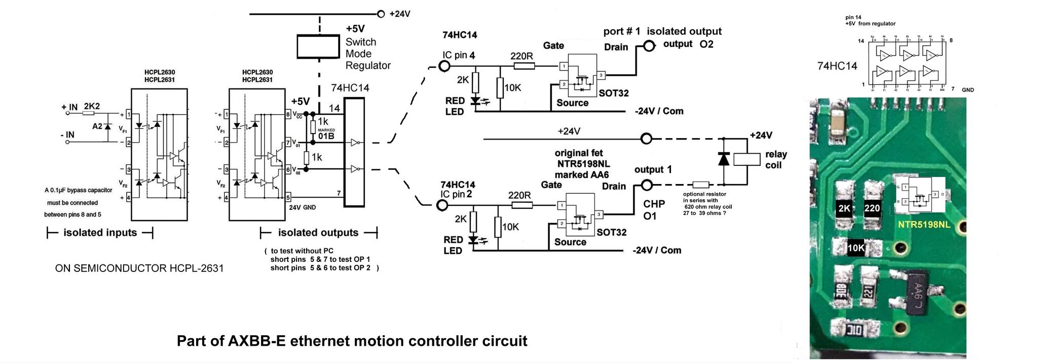

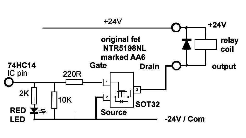

Name:	AXBB isilated output.jpg
    I would look for a wiring problem that could of shorted the +24V to the AXBB output
    As semiconductors fuse faster than expensive fuses thats supposed to protect them
    you could try adding a 22 ohm 1/4W resistor in series with the relay coil
    ( the resistor should only fail if the relay coil is shorted )
    The only issue I would expect with tripping the RCD will be corrupting the PC hard drive
    If you have not shut the PC down
    John
    Last edited by john swift; 15-08-2019 at 12:29 AM. Reason: add ref to adding 22 ohm 1/4 W resistor
  12. #40
    Another diagram to expand on the one in post 39
Name:	HCPL-2631 AXBB opti-isolator.jpg
    John
