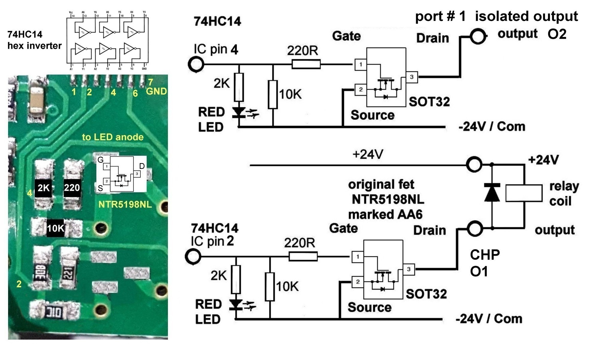

    Guess what...its gone and done it again I don't understand what is causing it! I had the 27ohm resistor directly on the charge pump output then through two e-stop switches and onto to 24v- on the relay. The relay 24+ goes direct to the 24v output from the PSU . I also have the diode across the coil of the relay
    It is behaving slightly different this time though in that the relay doesn't switch on until the charge pump is active. The problem comes when the reset or estop is tripped. The charge pump led switches off but the relay stays active ( the relay led stays lit but dimly when the charge pump output should be inactive?)
    I thought It was going too well I had done a couple of trial parts and was working on reducing backlash and and alignment when I noticed the estop didn't cut the power, I am wondering if it's the actual relay causing it

    So the LED on the AXBB is off, but the relay remains energised and another LED on the relay is on/dim?
    That suggests the FET is conducting, when it should be off. No disrespect to John but worth a visual around the replacement FET and a wipe down with IPA if there's any flux residue, but I doubt that will resolve anything (the gate is tied to ground via resistor so can't really believe any parasitics will be able to draw the gate high). Worth measuring the voltage on the gate of the FET (report here) and the voltage ACROSS the relay coil when it should be off - my guess is you'll have a few volts there and if the voltage on the gate is essentially zero then, with the circuit as shown, it can only be the FET. Replace again. If it fails again then replace with a bigger bugger. Or haywire the 74HC14 output to the adjacent FET and use that output instead.

    Hi Charlie
    I am surprised the the charge pump output has failed again
    I would of thought the combination of the diode added across the relay coil to control the back emf
    and the 27 ohm resistor to limit the current if the relay was ever short circuited
    would of protected the FET
    Can you measure the voltage between the CHP O1 and -24V terminal
    when the output should be ON and OFF
    and if possible the voltage across the 10K resistor on the PCB
    knowing the voltage between the 74HC14 GND pin 7 and output from pin 2
    will help
    I would expect it to be 0V when OFF and +3 to +5V when ON
    from the FET data
    Gate Threshold Voltage = min 1.5V to max 2.5 V
    John
    will help
    from the FET data
    John

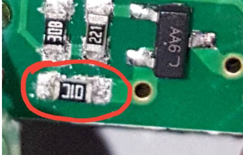

    Just to clarify....
    voltage between 24V- and output one with charge pump active on and off. (Relay and resistor connected or disconnected?)
    And voltage across resistor circled, again with charge pump on and off.

    Sorry, been up to my elbow in a Myford since 9am. Anyway, V(OP1) with Relay / Resistor connected. And, yes, across the resistor marked 01C (one side is ground, the other is the output from the 74HC14), the signal that drives the FET On/Off. I expect that to be either <0.5V / > 4.5V - assuming the local logic (HC14) is supplied at 5V.

    yes
    that's the resistor
Name:	AXBB isilated output PCB & circuil.jpg
    unless the FET has gone low resistance between the gate & source
    the voltage across the 10K resistor should be the same as the voltage across the FET gate & source
    as the static FET gate current is virtually zero ( leakage current 100 nA )
    the volt drop you measure across the 220 ohm will be zero
    you will find the via (plated through hole ) in the copper trace connecting the 10K resistor and FET source is the – 24V supply - making it an easy test point
    with a damaged FET
    a fault current with the relay connected could leak out of the gate and alter the gate voltage you measure
    John
    PS
    the FET was replaced by the original part
    NTR5198NL from FARNELL
