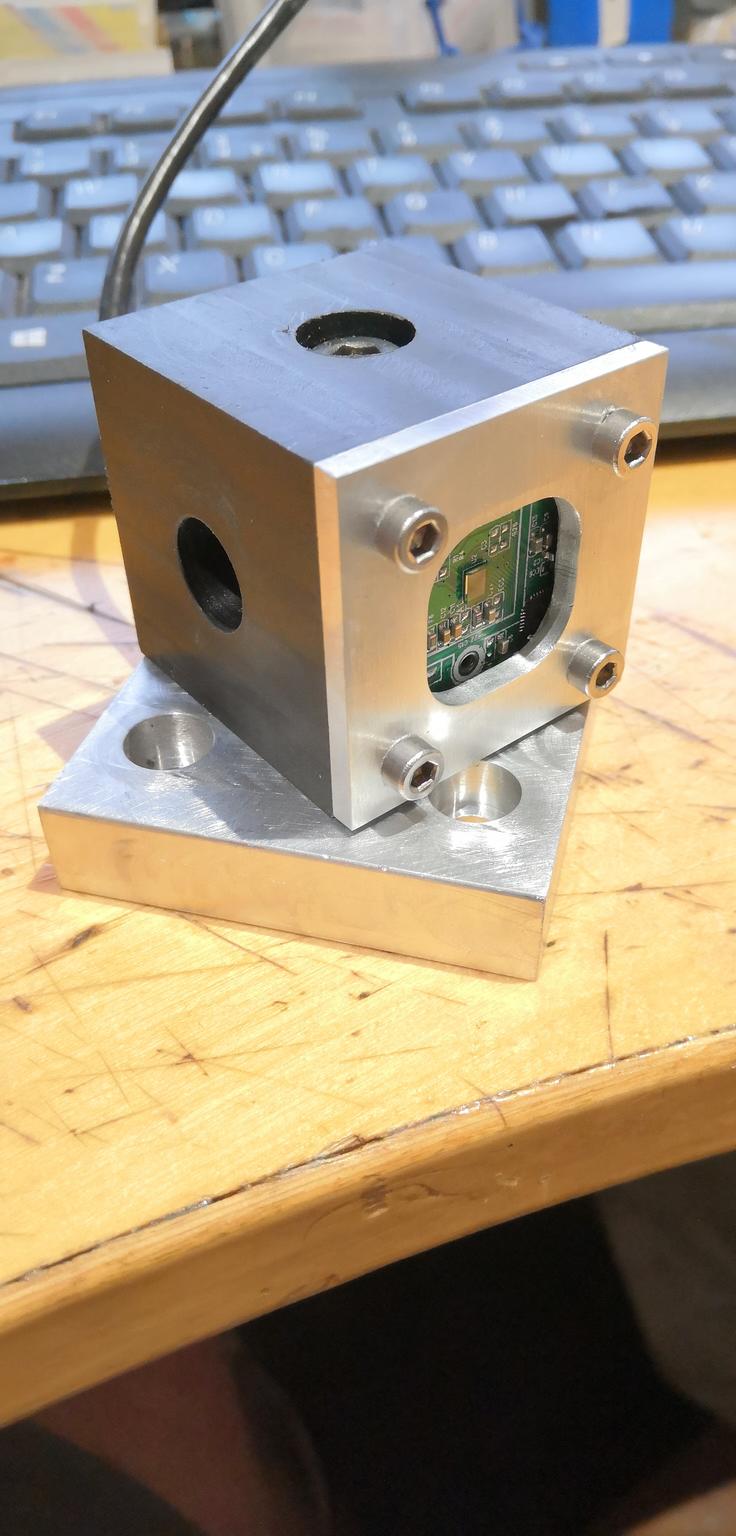

    Hi Bert,
    No I just use the bare sensor in a milled fixture, see:

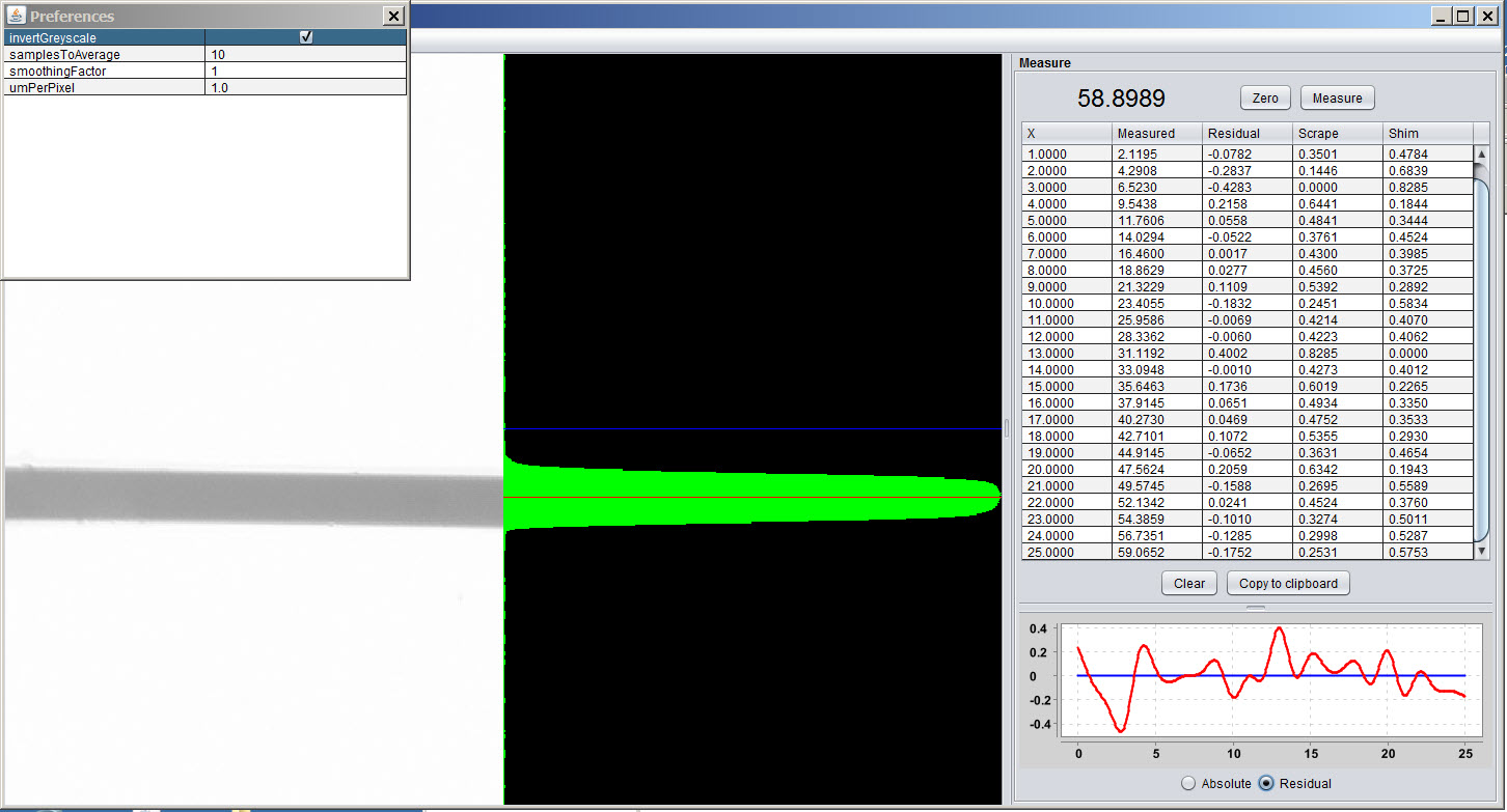

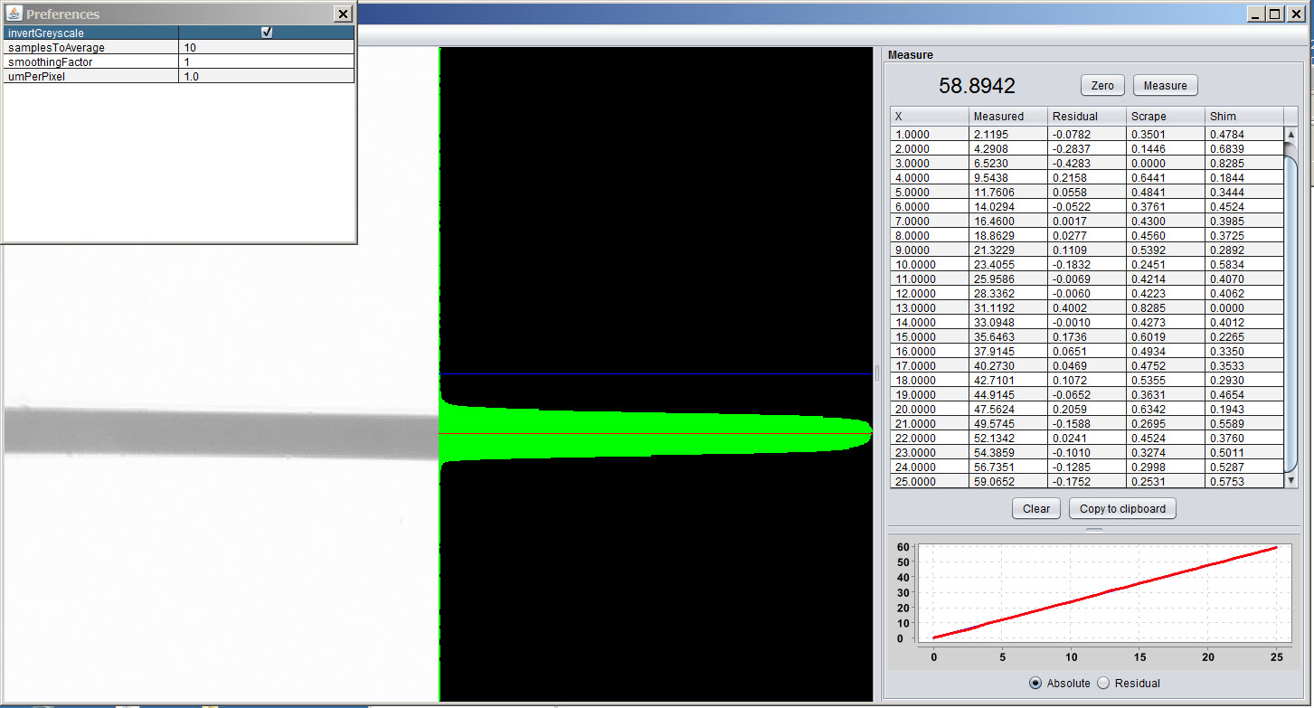

    Hi Joe
    Hi All
    Below two images of a test of 0.25mm in 0.01mm steps.
    The Dial indicator used was a Mitutoyo 0.01mm resolution unit. Ideally I should have used a higher resolution unit. I have one but I would need to make a mounting base for it. This would reduce the Measurement error slightly. Having said that the residuals look pretty reasonable. I guess I am splitting hairs here.

  5. #95
    Hi John,
    Let me just sanity check your methodology. You have the sensor or wire on a precision positioning system. You move the system in steps based based on your dial indicator and click measure at each step? Is that correct? Just wanted to check you aren't moving the system until the measure value increases by one step then clicking measure as this would always produce a straight line, I don't think you are doing this but just want to be 100% sure.
    You have the umPerPixel set to 1 therefore the numbers you are recording are in the units of pixels, this means anything to the right of the decimal point is to a sub-pixel accuracy. This ok to an extent (say 1 decimal place) but will soon deteriorate into noise. The gaussian fit will be afffected by a single intensity point change of a single pixel that is why you get jitter at extreme sub-pixel resolution. To remove all jitter you would probably have to perform the test under lab conditions in a vacuum to avoid dust particles and with a lab quality camera with high precision pixel exposure times. The exposure times (and therefore the intensity readouts) of these cheap sensors with rolling shutters are not perfect, when a pixel/row is exposed for slightly longer its intensity values will naturally be higher. Couple this with the onboard image processing pipeline that is probably trying to do all sorts or AGC and white balance adjustment and noise is inevitable.The image is then compressed onboard to a jpeg adding all sorts of artifacts before being shipped to the PC.
    All that said your 0.01mm test run shows your residuals are within +/- 0.4 pixels or 0.0016mm (think you sensor is ~4um per pixel) of a straight line, this is pretty good isn't it? Shimming or scraping in the 1 micron range is most likely impossible for us and probably completely overwhelmed by the thermal movement of the frame.
    The 0.0016mm could as you say be down to trying to position the sensor using a 0.01mm dial indicator, quite difficult to judge 1/10th of one division...and outside the tolerance of the indicator.

    Hi Joe
    The measuring system is just a manually driven XYZ platform
    Once set up I only move the webcam The light is at this time fixed and non moving. This is wrong! it should move with the webcam sensor although a 0.25mm movement is pretty small slightly less than 0.010 inches. I am going to work on the light next.
    And yes I clicked measure after each movement to the next tick on the dial indicator. The straight line is proof that the system is linear. Subject to my possible manual positioning errors as detailed in my previous post.
    And the results we are getting are better and better, once the lighting is sorted I am certain the repeatable accuracy can be improved. Once this is done I really want to try a higher resolution webcam.
