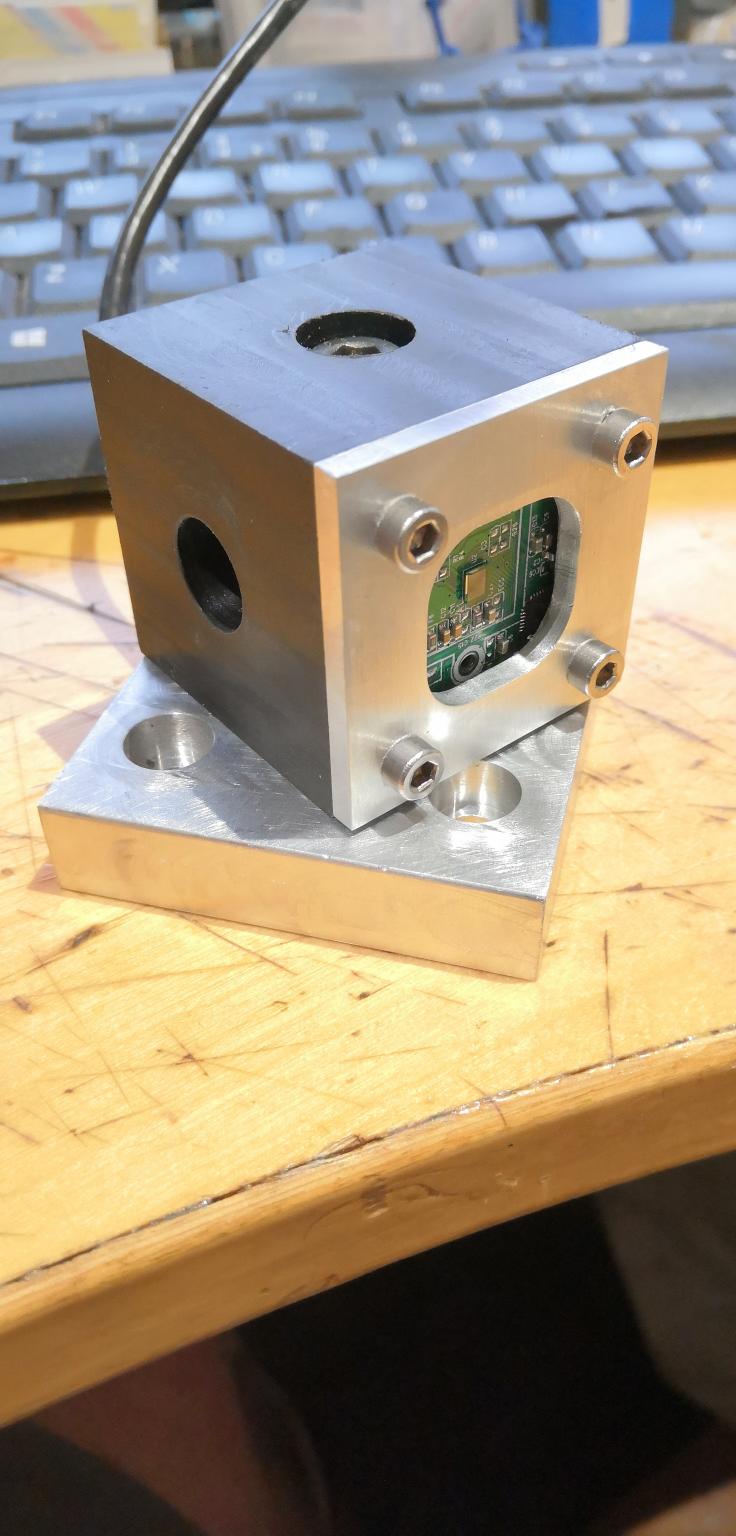

    It could be aliasing from reflections on the lens holder thread, I got much better results with the sensor mounted with nothing close to it in the near field. See picture below, that window started off as a 6mm round hole, it caused aliasing hence I opened it up so no reflected laser light could hit the sensor.
    I don't know much about dslrs but maybe it could have lens distortion correction built in which would be warping the image non-linearly across the sensor. Have you got a cheap web cam to try with? It is also unlikely that sensor pcb is hard fixed to the body, the ones i've take apart are usually on soft mounts that let the board move around to absorb shocks.

    It's cheap Sj4000 clone distortion is massive, if there is correction it does very bad job. I have cheap webcam and 0.08mm steel wire on order. Will try both laser and wire to rule out sensor nonlinearity errors.

    One other thing that occurred to me, how did you ensure you moved the sensor/vice assembly absolutely in a straight line? Any deviation in this procedure would show up as non-linear errors in your linearity measure since it would have been impossible to get the laser perfectly planar with the granite. This applies to both types of laser dot and line. I think you need a precision straight edge as well as the reference surface to check the accuracy of the system.
