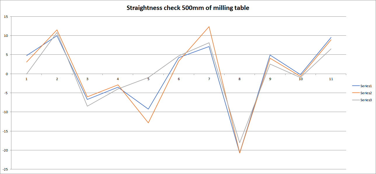

    One final test, I repeated the straightness test on my milling machine table, again 10 stations over 500mm, 3 runs again eyeballed off a ruler bolted to the table. The table is pretty straight within +/- 0.01mm over 500mm.
    It is certainly much straighter than my kitchen island !
    I did this test very quickly and it wasn't performed perfectly, for example the laser was really too close sensor meaning that the sensor was saturated or nearly saturated around the beam, this would lead to a little inaccuracy as the maxima is effectively on a flat peak, it would be better if the laser was further away reducing its brightness.

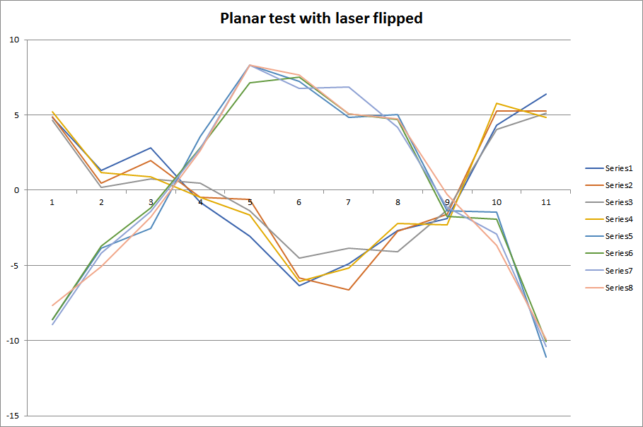

    So I have 'borrowed' a much higher quality line laser with decent optics, and believe I have verified that line lasers are not straight. Setup was with the sensor on my milling table moving along 10 stations over 500mm against a ruler that was clamped to the table. Note the sensor was moved, the table was stationary to avoid any rocking on the saddle block.
    The laser was setup in a fixture about 2m away so that it projected its line across the top of the table hitting the sensor. The fixture allowed the laser to be rotated so I did 4 runs then flipped the laser 180 degrees axially (so the projected line was now inverted wrt the first runs) and did 4 more runs.
    I think this suggests that this laser has a parabolic error in its cylindrical lens or the lens alignment, what do you think? Chart shows all 8 runs, you can clearly see two groups of 4 parabolas, one group the inverse of the other, this parabolic error is greater than any error in table straightness.

    Joe,
    I doubt I will ever be measuring to a few microns in my own workshop but I love the way you are making such precision achievable in a DIY environment. The revelation about the non-straight laser is important but presumably the ability to invert it means the error can be quantified and allowed for. Does this mean a cheap line laser mounted in a suitable rotating/inverting housing could be virtually as accurate as the high quality one?
