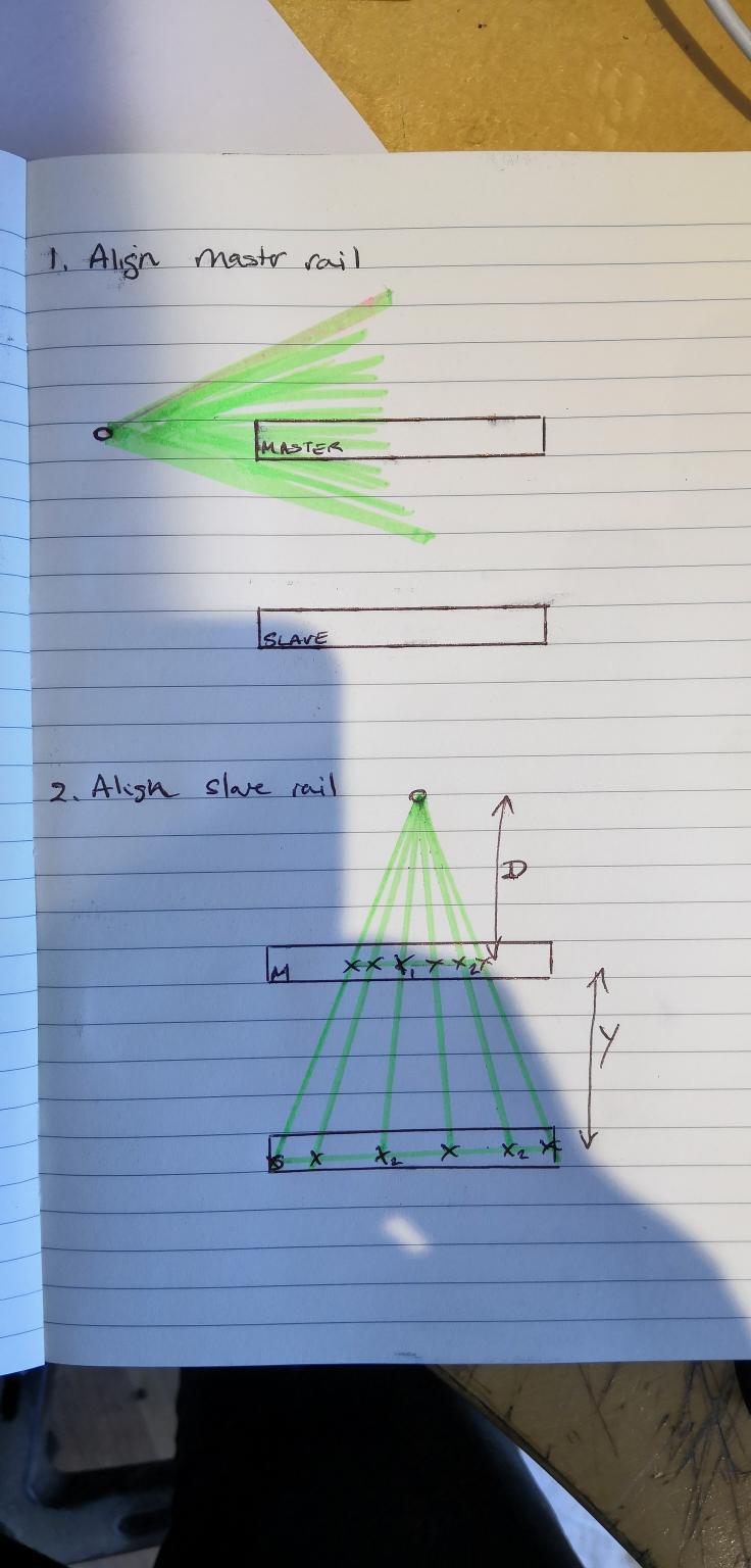

    I have had an idea, or maybe remembered something previously discussed here. To get around the error in the laser line which is proportional to arc length how about first flattening the master rail in isolation with the laser projecting along the rail, this uses less that 1 degree of laser arc. The master rail is now flat. Now move the laser so it is orthogonal to the master rail and projecting across the frame as to encompass the slave rail we want to bring into plane with the master.
    The height deviation from flat caused by the error in the laser line now we are using say 30 degrees of arc can be measured and the true deviation calculated for stations along the known flat master rail and then projected using simple geometry to stations on the slave rail so that it can be also be flattened bringing it into plane.
    Sketch:
    This should work shouldn't it, if we consider that a ray of light travels straight and that a very small arc of laser line is 'ray like', and if we consider the laser as a point source (which it isn't). Thoughts?

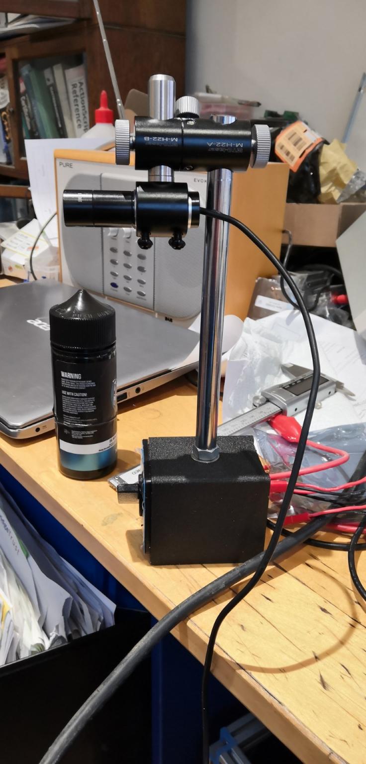

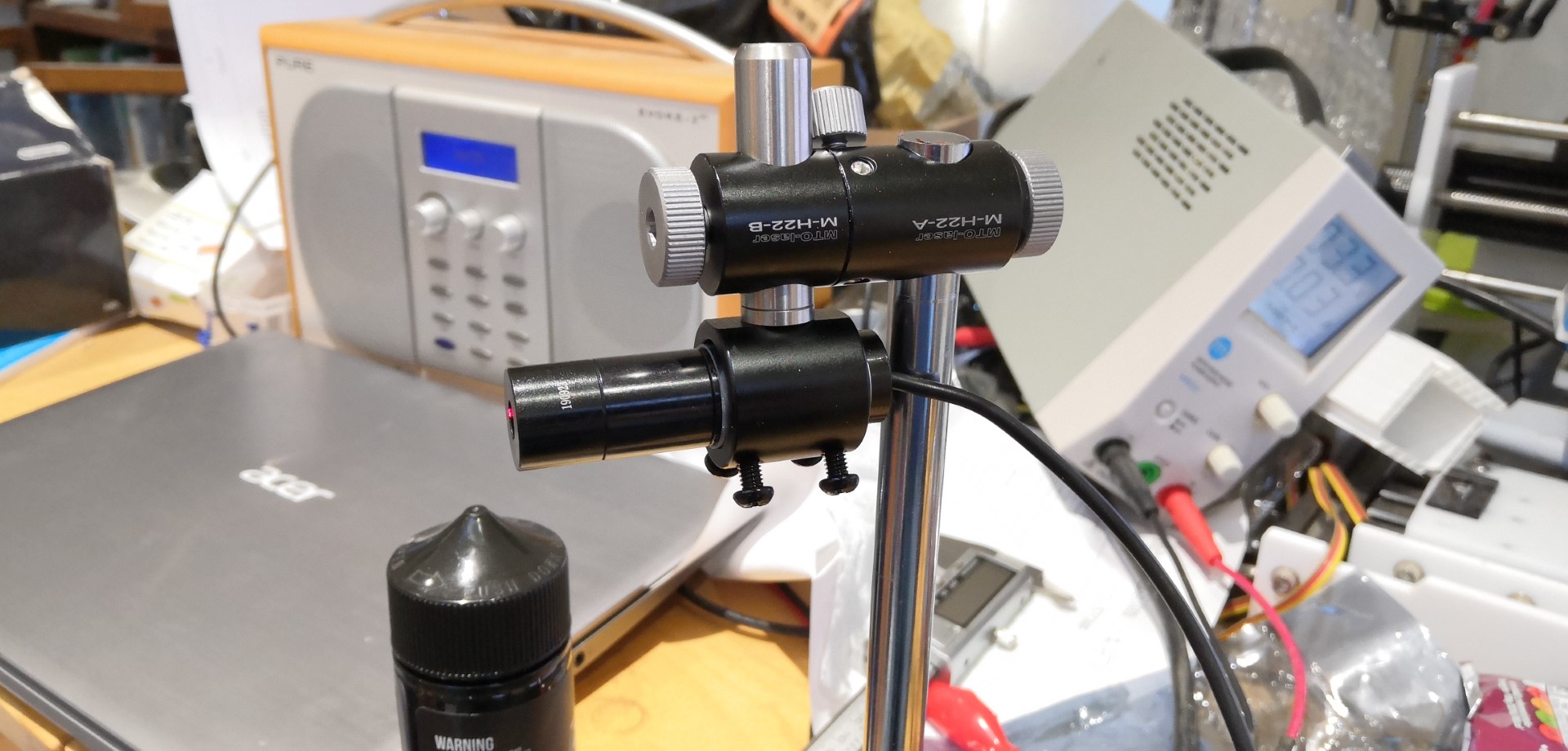

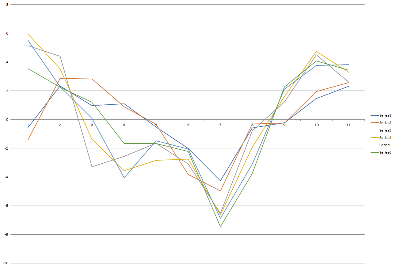

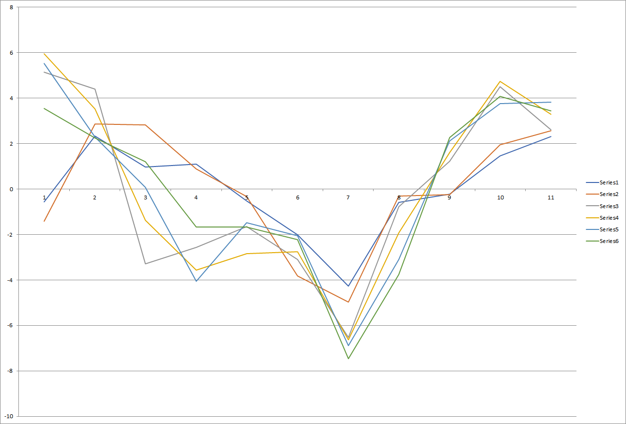

    In the pursuit of madness I have just done another test on the milling table with the better quality laser, I did 6 runs each with different parts of the laser line some with the laser inverted, with the angle of incidence to the table random, etc. Again 10 stations over 500mm. Results are very consistent which makes me think there was something wrong with my last test.

    I don't think the laser mount is anywhere near stiff enough, it takes a few minutes for it to stop moving around on the screen to start a run and by the end of the run it has drifted by at least half the error of the run. Note that I haven't been testing with the laser on that desk rather out in the garage on a heavy bench over the bench leg.

    I think this laser needs to be clamped to a vblock attached to a lump of iron. It also has a focusing ring attached which works well other than it wobbles the laser all over the place. This might need to be locked in place as well.I have now gone from 'borrowing' the laser to owning it so it might well get some locktite on the focus slider.
