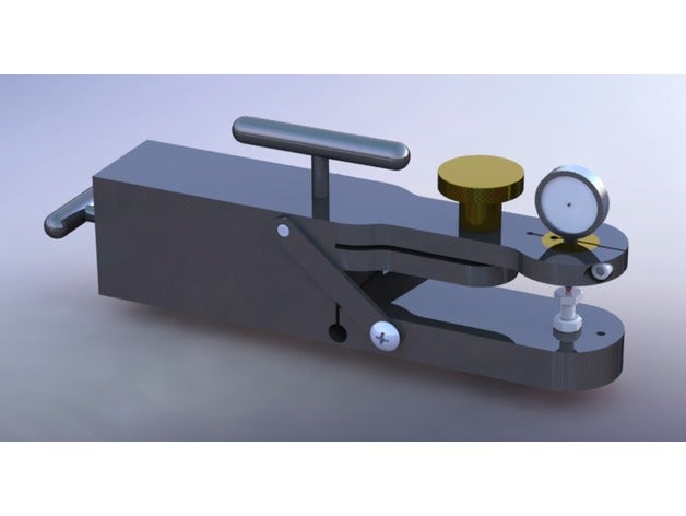

    Hi Bert,
    I have had an idea of how to create a tool to check whether the rails are planar that doesn't matter if the laser line is bent.
    It is effectively a large scale repeat-o-meter using the laser rather than DTI and thereby avoiding a very long infinitely stiff top bar:
    The setup would consist of 4 spherical feet arranged in a square. 3 of these feet would be rigidly mounted on a triangular frame, the fourth foot would float on an arm that can pivot up and down on a hinge at the centre of the square. The camera would be fixed above this forth foot and the laser fixed to the triangular frame diagonally opposite. None of this would need to be high precision, the only requirement is that the triangle be stiff.
    To calibrate the tool you could use any reasonably flat surface, it doesn't have to be a perfect plane but shouldn't be pitted.
    Lay the tool on the surface and mark where the 4 feet touch as accurately as you can. Take a height reading of the laser on the sensor. Now lift the tool and rotate it 90 degrees such that the feet sit back on the 4 marks made and take another height reading. I think that the middle of the two height readings will be the point where all 4 feet are in plane, so we zero the tool to this mid point.
    If this is a new machine then you would level the master rail bed in isolation using the laser projecting along it.
    Now place the new calibrated tool on the machine frame such that two feet of the triangle rest on the master rail bed and the other two on the slave rail bed. Now adjust the slave rail bed under the floating foot until you read zero. These four points on the machine are now in plane. You can check the tool is still calibrated by rotating it 90 degrees on the machine frame and checking for zero.
    We now have two points on the slave rail bed that are planar with the master so the slave rail bed can now be levelled in isolation to a line passing through these two points.

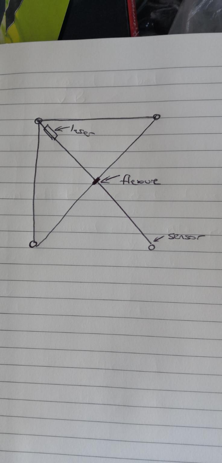

  7. #247
    Hi Bert,
    No nothing needs to be centred on the diagonals, the only restriction is that the device can only check a square not a rectangle, but this doesn't matter as we can always define a square ontop of the rectangle formed by our pair of rail beds.
    The reference surface doesn't really exist. What we are doing is defining a square as four points on the device, call them A, B, C, and X:
    AB
    XC
    With [A,B,C] fixed in relation to each other and X able to move up and down. Since [A,B,C] are fixed relatively to each other (in a triangle) they form a plane. The laser is fixed to this plane on the device near B pointing towards X. The camera is fixed to X.
    Now define a square the same size on a table top or the machine frame or whatever, label the corners of this square 1, 2, 3, 4:
    12
    43
    Place the device over this square such that A==1, B==2, C==3, X==4. Measure the laser height on the sensor at X. Now rotate the device 90 degrees so that say A==2, B==3, C==4 and X==1 and measure the new laser height at X which will have changed because your surface defined by [1,2,3,4] you drew on your table is not a perfect plane.
    Now if you were to move X up or down so that the laser measured height is half way between the two heights measured then I think that X will be planar with A,B,C. So zero the software at the mid height between the two X heights measured and you now have a calibrated device which will read zero when placed on a true plane and a signed error when placed on an untrue plane. In other words [A,B,C,X] will be planar when the newly zero'd X is at zero. You can use this to check a machine is in plane and adjust the machine as required until it reads zero.
    I haven't tested this only thought about it, I might be missing something, will draw it in CAD and check the theory is correct.
    Cheers, Joe

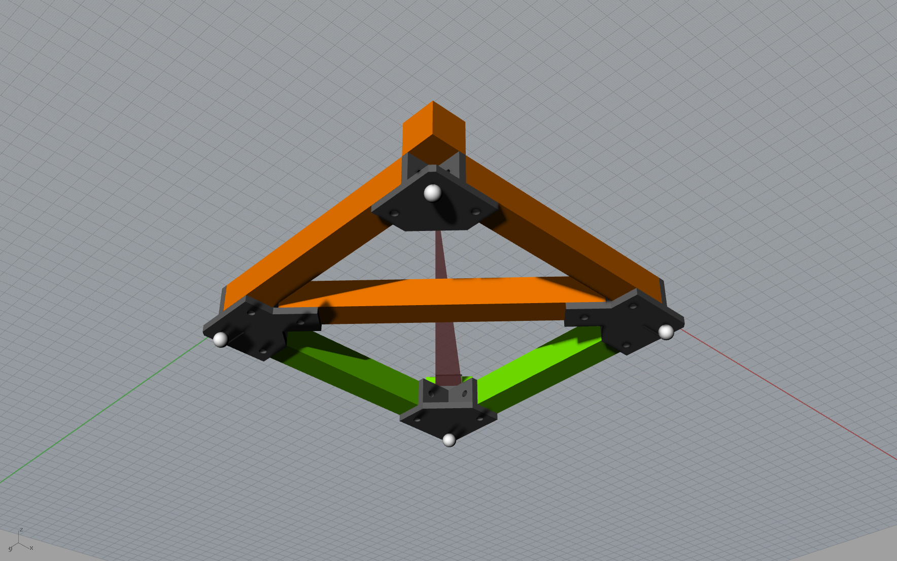

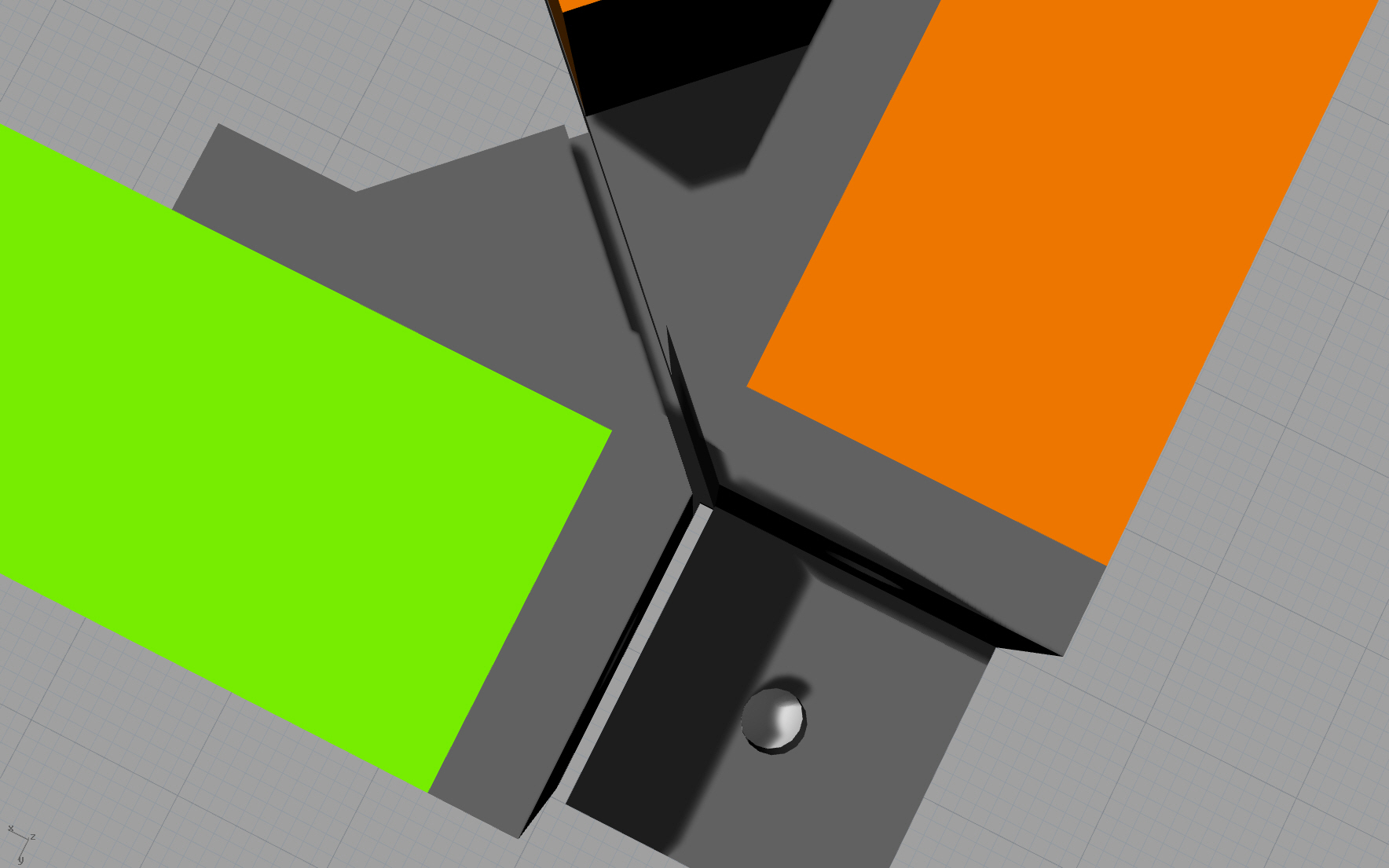

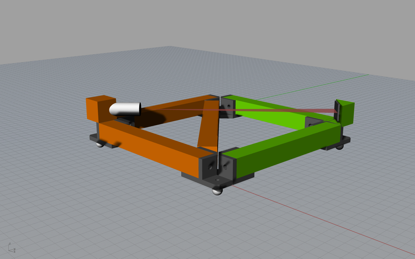

    Hi Bert and everyone,
    Here are some renderings of the laser-plano-meter I've been trying to describe.
ID:	27468 Click image for larger version.
    It consists of a square device sat on 4 spherical feet at the corners. 3 corners of the square are rigidly connected to form a triangle (orange part) with laser attached. The forth corner is attached by the green arms to the triangle with flexures that allow it to pivot up and down with respect to the triangular plane, effectively the square is allowed to fold along its diagonal. The camera sensor is attached to the forth corner.
    The laser will project a line on the sensor, the height of this line is related to the angle of the fold. The goal is to find the sensor reading where ALL 4 feet are in the same plane thereby providing a method of measuring the error of any surface from a plane. We will call this sensor reading ZERO.
    To find ZERO we place the device on any surface, doesn't need to be a plane. We then take the laser height measurement H1 in this position. Now rotate the device 90 degrees about the Z axis and replace it on to the same surface so that each foot is in the same place as its predecessor was in the first position. Now measure laser height H2.
    With both H1 and H2 we can calibrate the device. ZERO is the mid point between H1 and H2.
    Now place the device on the surface to be measured, e.g. the pair of X rail beds of the CNC frame. The deviation from ZERO will tell you how much to adjust the frame under the 4th foot in order to bring the surface into plane.
    An alternative way to think of it is if you just placed the non-zero'd device on the machine frame and take the laser height measurement, then rotate 90 degrees and repeat, if the heights are different you need to adjust the frame. Make the adjustment, rotate the device back to its original position and repeat until the height readings match.

    Yes, that really helped.
    This is a clever design.
    I will try this later. I think a simple laserpointer will do i guess in this scenario.
    Thnx Grtz Bert.
