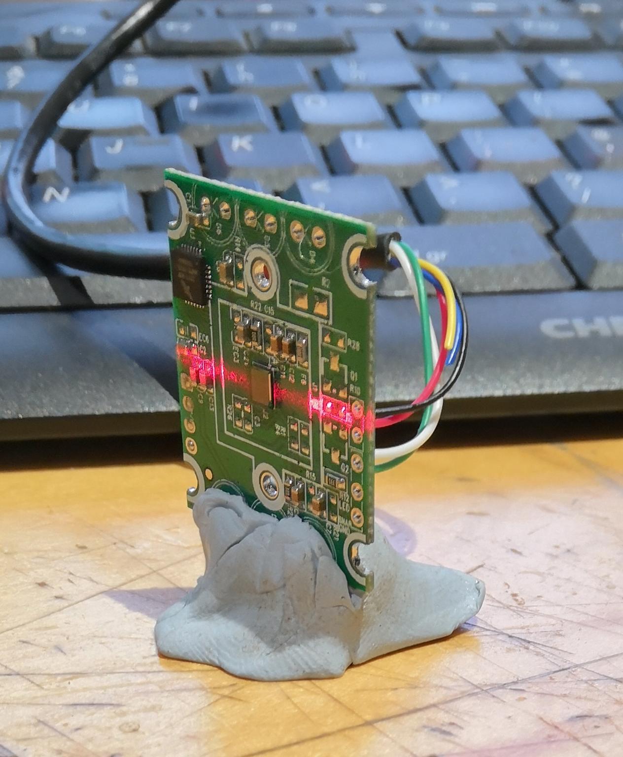

    I want to try this too John.
    As for the sensors, certainly the one i'm using, the resolution is simply amazing. This sensor that came from a £7 webcam from amazon has an active area ~2mm wide, this is 640 pixels, so ~3um pixel spacing. You can quite easily with the averaging achieve sub pixel accuracy. That thesis is excellent, looks like he averaged a few thousand frames.
    I've decided to use this new sensor as it is easier to mount and seems to behave exactly the same with the laser as the one I was previously testing.
