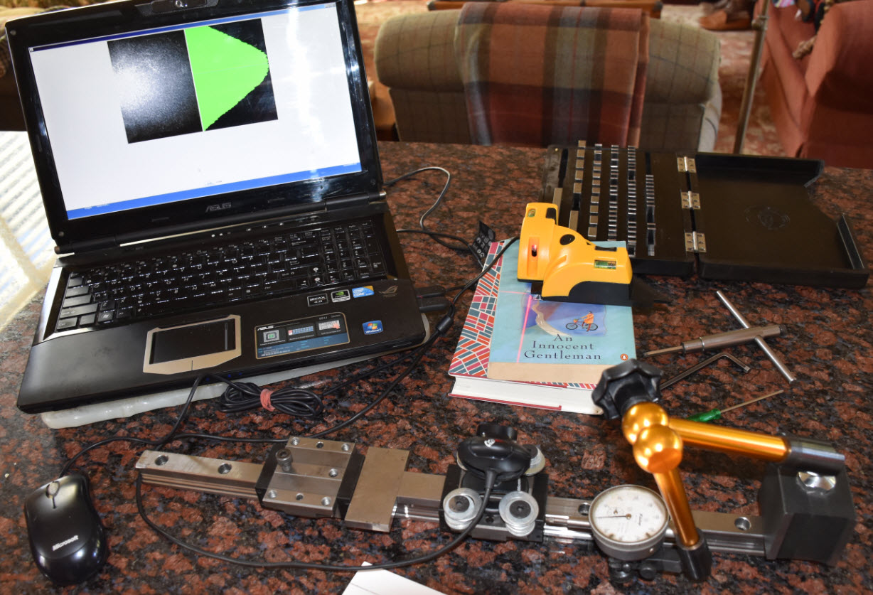

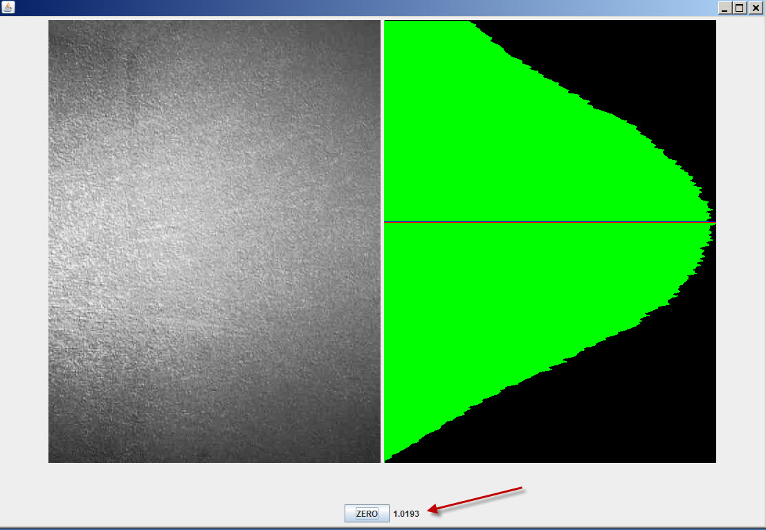

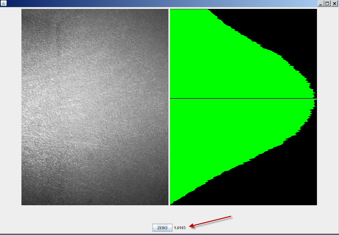

    First tests!
    Today I set up a quick test to determine what sort of accuracy might be achieved using a Webcam and laser.
    I mounted the webcam on a linear rail slide, I was going to use gauge blocks against a stop to measure the resolution of the device using a cheap laser that I picked up from Aldi one day. it is the only line laser I have. That did not work because the hard plastic ends on the linear rails were too flexible, I could not get constant results.....
    The Webcam is a 640 x 480 resolution Microsoft LifeCam VX -1000. It has an adjustable lens that I was unable to remove quickly so I just used it as is! Pointing the laser directly at the camera produced horrible flare. However angling the camera did work! I am not sure why? Probably something to do with the lens. The next tests will be done without a lens.
    I think you could say that the tests were a bit of a comedy of errors!
    Fortunately I has also set a magnetic base 0.01mm indicator on the rail. It saved the day. By simply pressing on the linear slide I was able to move the slide laterally about 0.04mm with medium pressure. when i released the pressure the indicator went back to zero. This is all I needed...
    Now for the exciting part; Hidden at the bottom of the Gaussian graph there is a tiny numeric value, It followed my indicator movement when I moved the slide. very roughly a value of 1 to 4 on the graph value to 1 to 4 ticks on the 0.01mm indicator. I assume this correlation may not have been planned however with the particular camera I used it was very convenient.
    I ran the test several times and it was repeatable.
    0.01mm is equal to .00039" (about 4 tenths)
    A very good result from a crude setup.
    The following improvements will no doubt greatly improve the results.
    A better camera with the lens removed.
    Controlled ambient light. moving around the room can move the graph also sunlight entering the room moved the graph.
    The sensor needs to be shaded as much as possible.
    The numeric values at the bottom of the screen needs to be enlarged. Optional rounding and time averaging settings that can be applied to the displayed number would help to reduce the flicker.
    I have yet to test the device with wire.
    John

  4. #44
    Hi John,
    Yes the tiny number is the deviation in pixels from where you pressed zero.
    I don't think it was ambient light affecting your setup, the laser saturates the sensor. It is so sensitive it will easily pick up deflections in your floor from walking about. This happened when I was testing too, I had to sit completely still. It is less sensitive to walking about on a 6 inch bare concrete slab but you can still move it a few pixels.
    You don't need a better camera you just need to rip the optics off that one. The difference in quality between webcams of the same resolution is simply the optics.
  5. #45
    Hi DevMonkey
    I just did this calc in Excel
    sensor size in mm 2
    / pixels 640
    Space between pixel lines = 0.003125 mm
    I got roughly 1 integer value change to 0.01mm div on the Mitutoyo indicator.
    Quite a big variation?
    John
  6. #46
    My setup works out at the predicted resolution of 3um per pixel. I don't think you can trust this at all with your setup as the optics are still attached but with nothing to focus on. You are also getting a load of noise on the gaussian, this is probably either a function of the crappy optics on the camera or the laser line is using a diffraction pattern rather than a cylindrical lens.
    Rip the lens off the camera, then you will also be able to see if the sensor is indeed 2mm.
    If you think about it, without optics and the laser projected directly onto the sensor moving the sensor 1 pixel will shift the maximum intensity one pixel, there is no other option as the sensor and beam have moved relatively and the intensity profile of a cross section of the laser line hitting the sensor has not changed.
