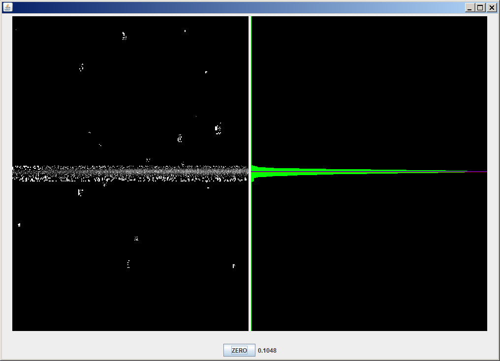

    I've put a new version up with some major improvements, starting to turn into a piece of software I might use!
    So it will now allow you to record a bunch of measurements against a particular zero, and you can export these to the clip board for pasting into excel or whatever. It will also allow you to average the samples used in taking a measurement, this is set in the preferences and defaults to 10. Remember once you have calibrated it you can put in the scale per pixel so you get real units displayed and measured rather than pixels.
    Get the latest version here:
    https://github.com/betzuka/laserleve...r.zip?raw=true
    Cheers, Joe
