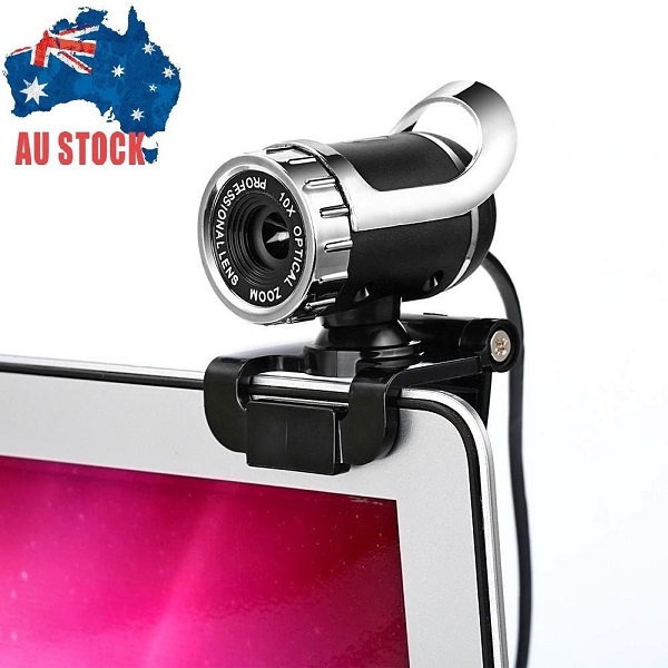

    Does the software work with a lens-less camera pointed directly at a laser pointer? I'm thinking you could arrange the pointer to provide a straight beam at a set height above a rail and detect how the spot moves around on the sensor as the camera backs away from the source on a carriage. Turning the camera 90 degrees allows measurement of horizontal and vertical errors. This is the quantum version of John's taught wire and requires a rigid, adjustable mount for the laser on the bed of the machine under test.
    All,
    I advise against trying to remove the optics from your cylindrically shaped, metal bodied, Mircosoft, auto-focus webcam. They're actually very solidly put together and mine is now a small pile of mangled bin-fodder. I've ordered a much more flimsy looking manual focus version from eBay (and a laser pointer).

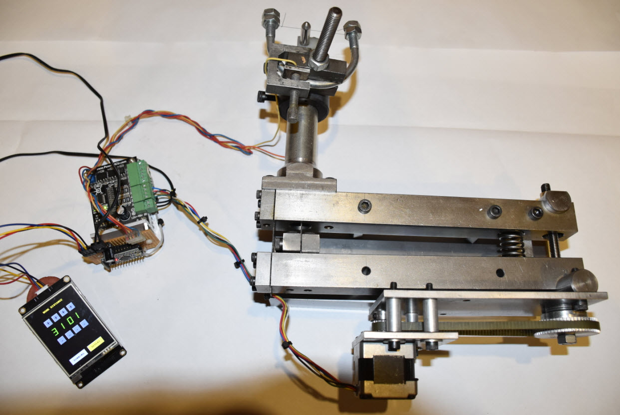

    A mate and I made this device a while back, The test device searches for and senses the position of a wire electrically to .0001" The stepper and 3:1 timing belt driven screw attached to a Flexure hinged 10:1 ratio lever provided repeatable accuracy. The only variable was the contact resistance of the wire. It sensed on the break of contact naturally. This occasionally led to false readings, I left the test running for hours.
    This is where the non contact camera is very attractive.
    Automating positioning using a webcam the laser or wire sensing requires accurate mechanicals. This test machine was bulky It was designed to move a cutting head with an attached sensor, it cost very little.
    I guess a ball screw would be the obvious answer. surprisingly small ones are not inexpensive. That is why I used a flexure for the first stage of amplification, Flexures have effectively no backlash. Have to think on this.....
Name:	0787 30-08-2019 6-35-05 PM.jpg
    It was driven by a baby Arduino with a small attached display for settings.
    John

    The camera I've ordered is this one, it looks suitably flimsy at the front and is even cheaper than yours!

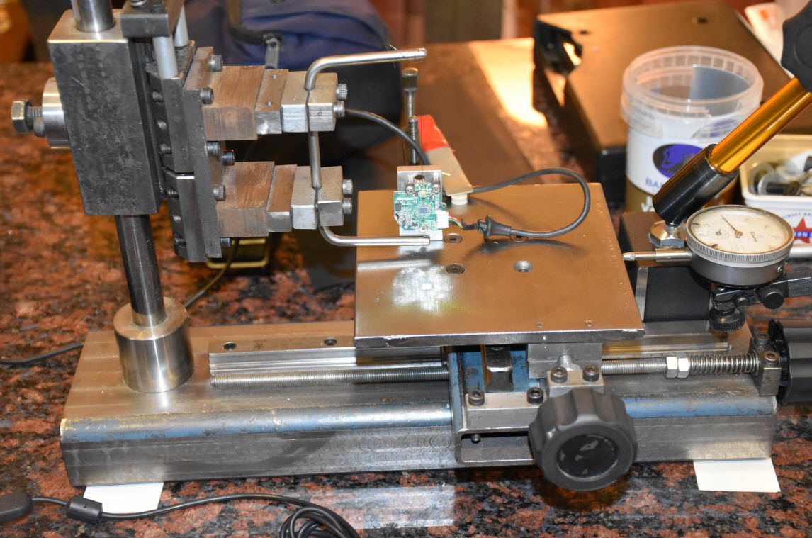

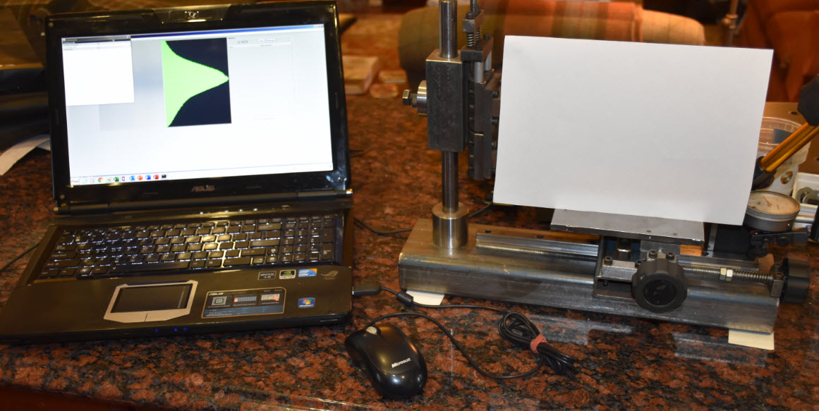

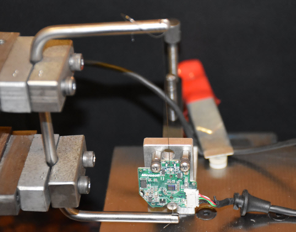

    Today I tested the software using a 640 x 480 VGA webcam without a lens and #2 Roslau Music wire (0.0010" thick).
    Digging around the workshop I resurrected an accurate XYZ jig table I lashed up with some star linear bearings and preloaded 8mm screws some time ago, this enabled me to precisely position the webcam now stripped from it plastic housing and mounted on in an aluminium bracket securely clamped on the XY stage of the jig. Measurements were taken with a Mitutoyo 0.01mm per division dial indicator.
    The wire was positioned about .0015" above the face of the Camera sensor.

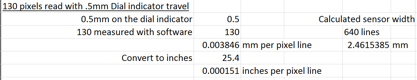

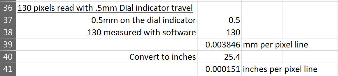

    Calculated resolution achieved was 130 lines used to measure 0.05m = .003846mm per pixel line 0.000151") see Excel Image below.
    This was repeatable I performed the test several times. however there are some issues measuring small values. It was difficult to measure .01 increments repeatably due to the software constantly recalculating very slightly different values. the source of this error needs to be tracked down. It may not be a software issue, I suspect It may be a combination of hardware and software issues.
    From various tests I have observed changing light conditions cause the measured value to change in a very substantial way. I also observed this using the laser in earlier tests although to a lesser extent.
    In the image below notice the paper tent covering the sensor this is essential to reduce the effect of stray light while providing somewhat even illumination of the sensor. It is not Ideal. I need to enclose the sensor in total darkness apart from an even illumination source behind the wire. I think this light source needs to be variable intensity to provide the correct grey scale balance for the software.
    Once the correct lighting conditions are achieved I will run the tests again.
    The tests today have proved that the Webcam software is already capable of very good repeatable accuracy. and that there is still plenty of room for improvement. Very exciting!
