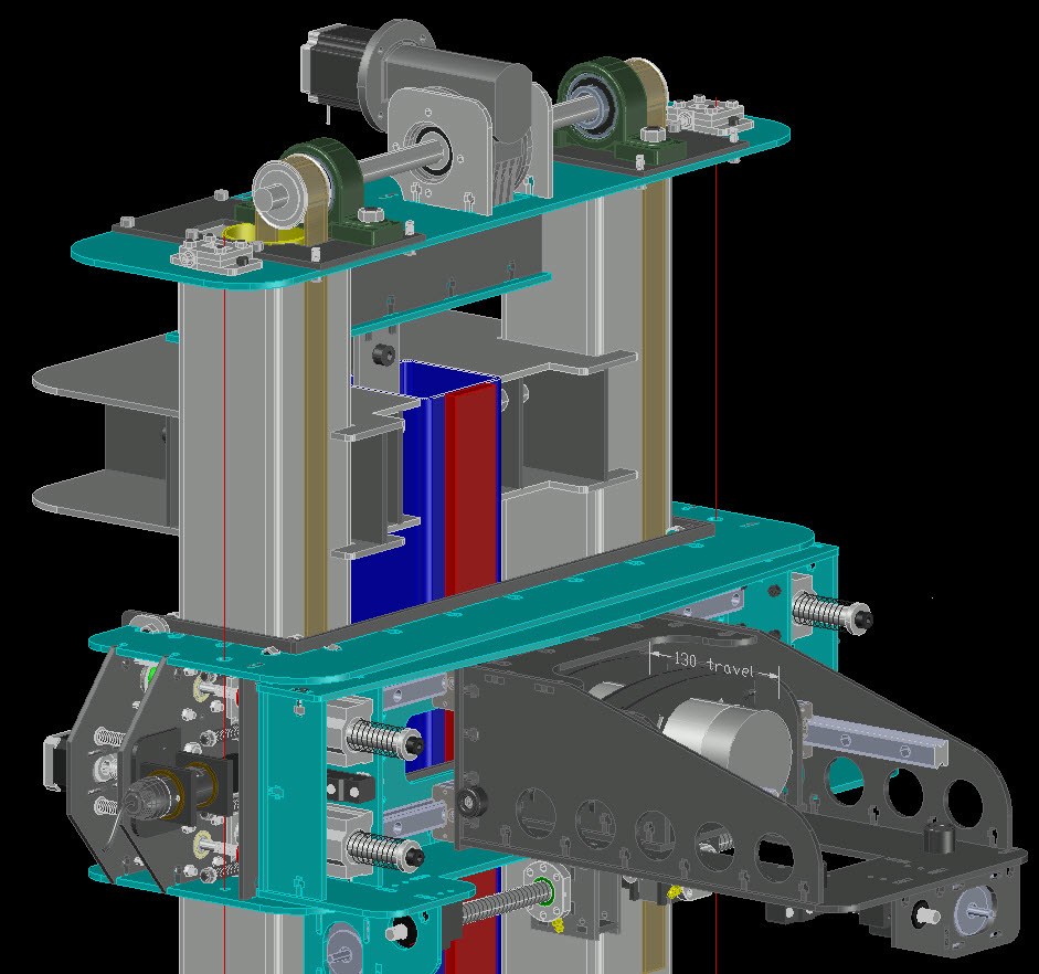

    Hi All
    Hi Joe, (Devmonkey). I hope all is well with you, I have not seen you around here for a while.
    I have upgraded the files stored on GrabCad to version 35. https://grabcad.com/library/machine-...linear-rails-1
    This is a major update many of the laser cut joints have been placed.
    It provides a good example of the possibilities made possible by laser cutting.
Name:	VIEW 3-02-2021 1-56-12 PM.jpg
    John

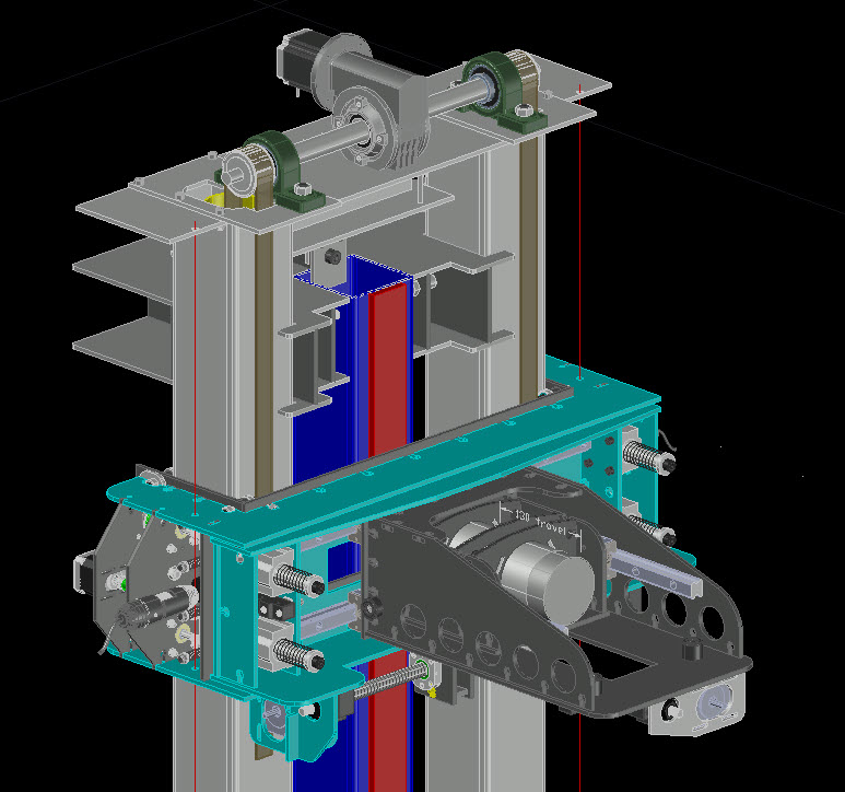

    Hi All
    The model is coming along nicely, Nearly build able at his stage. Next step is to sort out the computer interface.
Name:	View 16-02-2021 4-28-24 PM.jpg
    The files have been uploaded to Grabcad
    John
