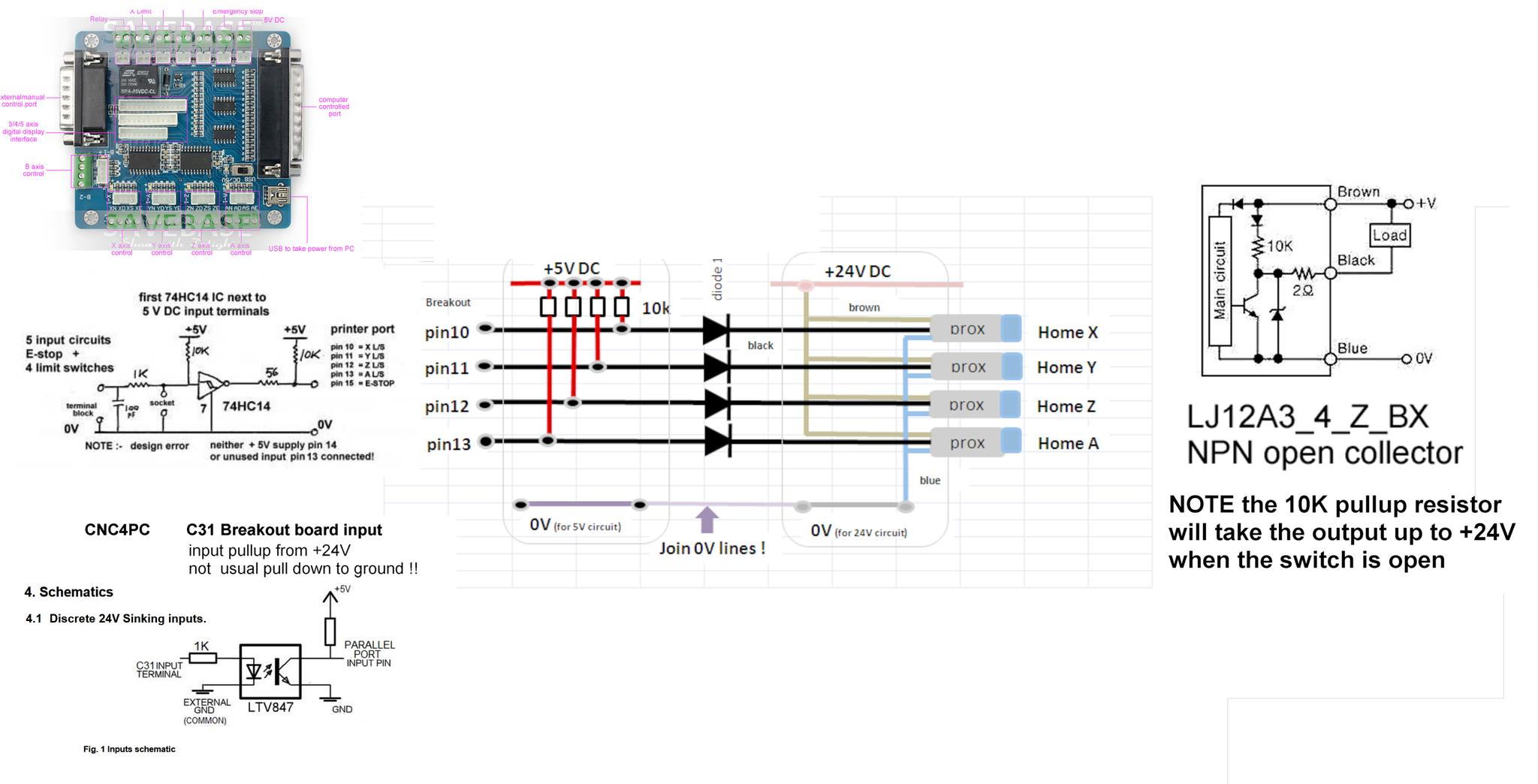

    As you are using CSMIO, as Paulus mentioned, this will take the prox sensor 24V directly. It has taken me a while to find my original drawing but for anyone with a cheap 5V BoB this is what I had to do to get it work. Without the diodes it was very unreliable at triggering. With the diodes it is 100%. Maybe these should be fast acting types, but mine were regular types and the homing is very repeatable. Sorry for the side track on the OP.

    for instance the LJ12A3_4_Z_BX proximity switch does not have the simple open collector NPN transistor output you may expect going by some adverts and data sheets
    It has a hidden 10K pull up resistor connecting the output to the positive supply !Click image for larger version.
Name:	LJ12A3_4_Z_BX Data Sheet.jpg
    with ref to the diagram in post 24
    adding the diodes works with the usual TTL inputs found on most BOB's
    that requires the switch to either ground the input or go open circuit
    some Chinese BOB's have opto isolated inputs with a PC817 input LED and current limiting resistor connected to +10V
    the Geckodrive G540 has its opto isolator connected to +12V and has a 2K2 current limiting resistor
Name:	G540 inputs.jpg
    so you don't always see 5V across the BOB's open circuit input and ground terminals !
    BOB's like CNC4PC's C31 need a positive 24V input
    so if you are using proximity switches you need one with a PNP output
    to pull the BOB's input up to the positive supply
    many Chinese BOB inputs connect to either a 74HC14 or 72HC245 logic
    IC input
    (see the upper left hand corner and centre of this diagram for the Chinese BOB input
    Lower left hand corner for the C31 )
Name:	proximity switch , C31 and chinese bob.jpg
    ( I prefer N/C switches because a broken wire will be trip the axis limit
    with N/O switches a broken wire will not be detected )
    John

    As per reply #17 to this thread:
    John, this topic was discussed (with the internal circuit you reprint) in 2016, till I got sick of it. The LJ12A3etc is designed for industrial 24v control sensing, but it works equally well switching amateur 5v (without diodes) if your BoB pulls the pin to logic 1 at 5v. The supply voltage to the device electronics has to be min 10v max 36, it will work below 10v, but not reliably, presumably because the oscillator duzzn't buzz. It has an internal 10k, but even so, the thing operates for practical purposes, just as if it is a NO relay on the blue and black wires. I happily use them with a 12v supply with the black wire connected directly to the BoB input.
    Peace and Love
    Rob-T
