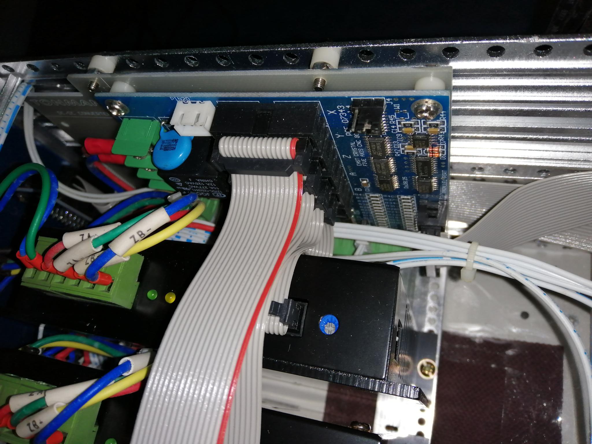

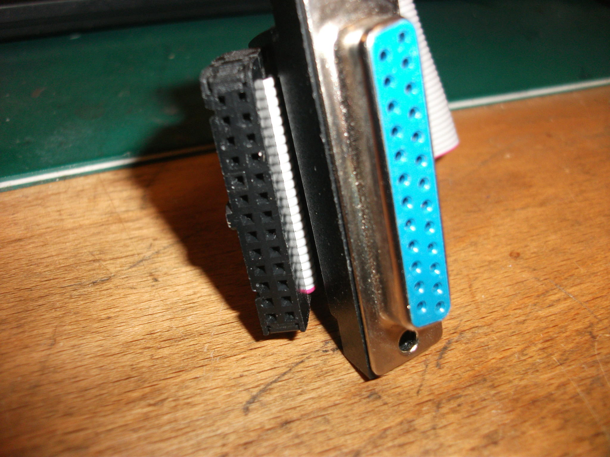

    Now I have seen the pics, I get the bigger picture. The QTCL BoB is a parallel port BoB - BUT - in this case it is being driven by the PCF08094 which is an ethernet interface.
    You have two options :-
    Set up the Ethernet address as Jazz says (which is the better way to go!)
    or plug the QTCL BoB into your printer port with an appropriate printer cable adapter like this one - If you could find one (I am not selling mine!)

    The printer port connects to the PCF08094 board - which then connects to the Bob via a ribbon cable ( This is how it was when I bought it and worked).
    So are you saying to unplug the ribbon cable that currently connects the print port to the PCF08094 board and connect it directly to the bob?
    I have uploaded a video which mite make things clearer

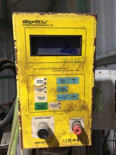

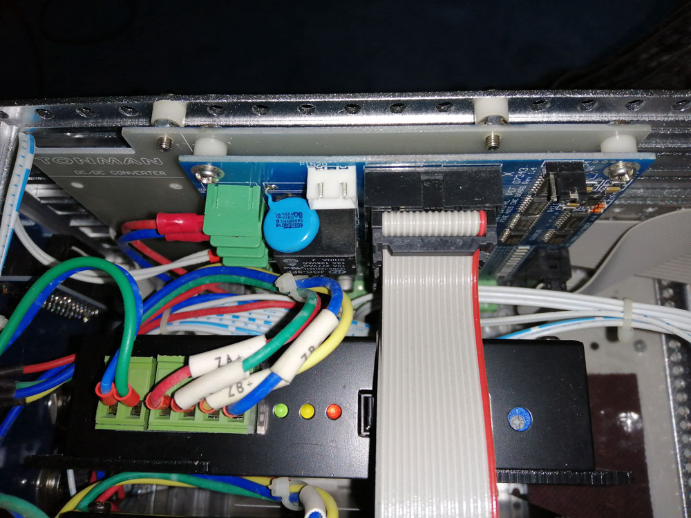

    Ok nowhere do I see a Parallel port cable but I do see an Ethernet Cable going to what looks like a Controller board with ribbon cables going to Breakout board so are you sure it's using Parallel port.?
    If it's using Ethernet then it won't work untill you set the Ethernet address and it would be Dead just like your experiencing.!
    One of the ribbon cables connects to the parallel port. The Ethernet cable runs to the control panel on the front of the machine - the board the Ethernet cable comes from is
    PCF08094 DS0809
    EAST CRYSTAL Rev:1.0
    And the one below it which connects to the parallel port is
    PCF 07483
    EAST CRYSTAL Rev1.1
    Ds0807

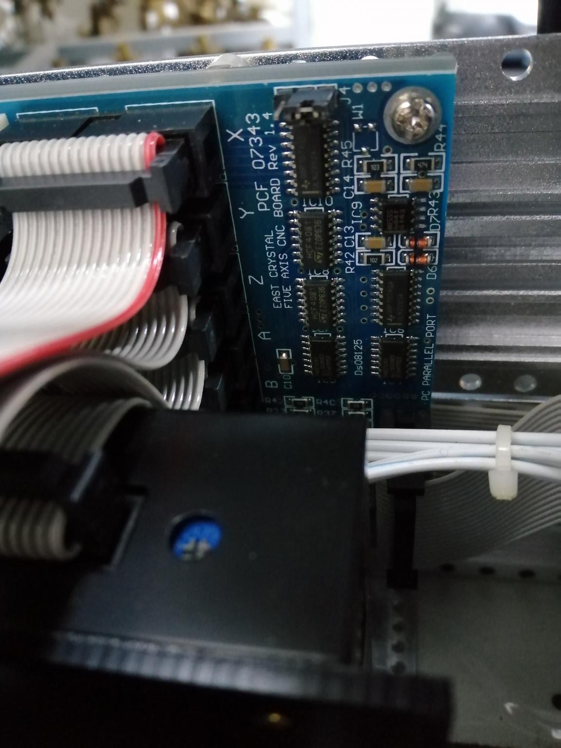

    Hi all, I am new with CNC, but I have try to get my CNC working but apparently if I don't have the conexions from the board os the picture to the drivers, it is impossible to make it work, So there is any has found the pins and dir conections that I can put on Mach3 to make my CNC from Marchant Dice Ltd. working? See pictures attach,
    Do I need to disassemble the box to find out how they are connected?Click image for larger version.
Name:	tarjeta CNC 1.jpg
ID:	29612Click image for larger version.
Name:	Tarjeta CNC 2.jpg
ID:	29613Click image for larger version.
Name:	Tarjeta CNC 3.jpg
    thank you very much in davance for your help, I am going crazy, I can not find any information about this card: Bazyx east crystal pcf 07343 five axis cnc board Rev. 1.4

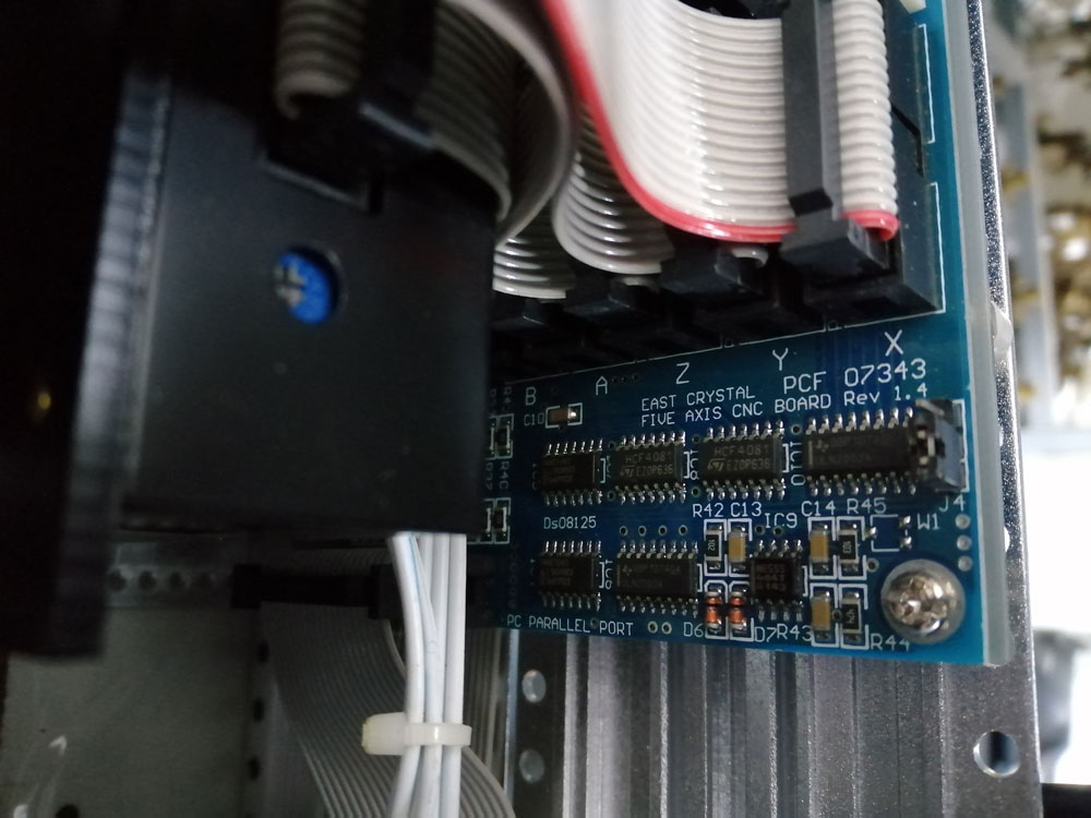

    It looks like I have the old fashion card, but does anyone has the pins and dir conections for the step-motors fo the CNC machine from Marchant Dice Ltd. I can not make it work, and I can not find any information about it, only this post and the card doesn't look the same. Can you help me? see attach pictures Click image for larger version.
ID:	29615Click image for larger version.
ID:	29616Click image for larger version.
