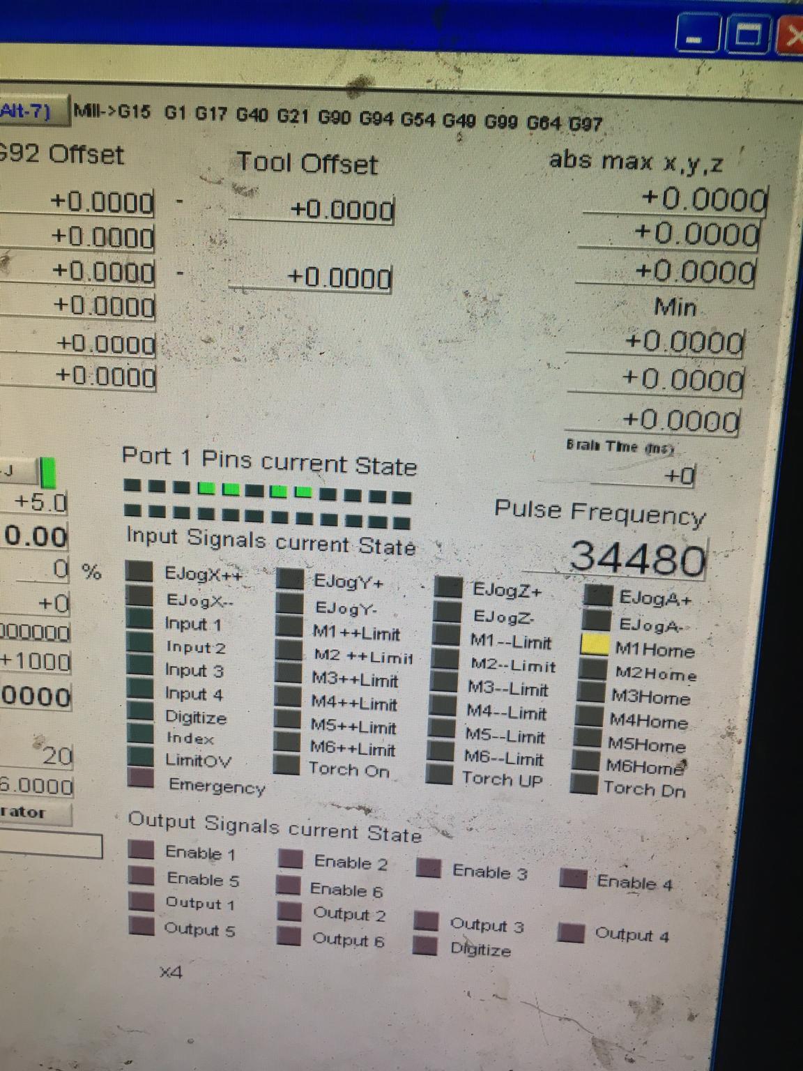

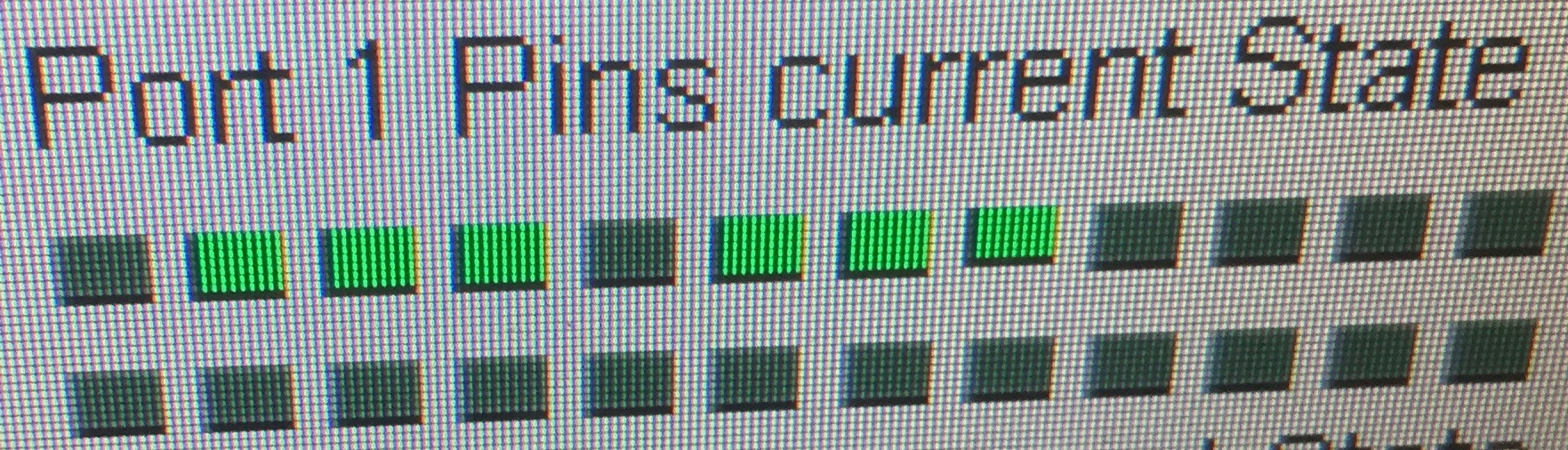

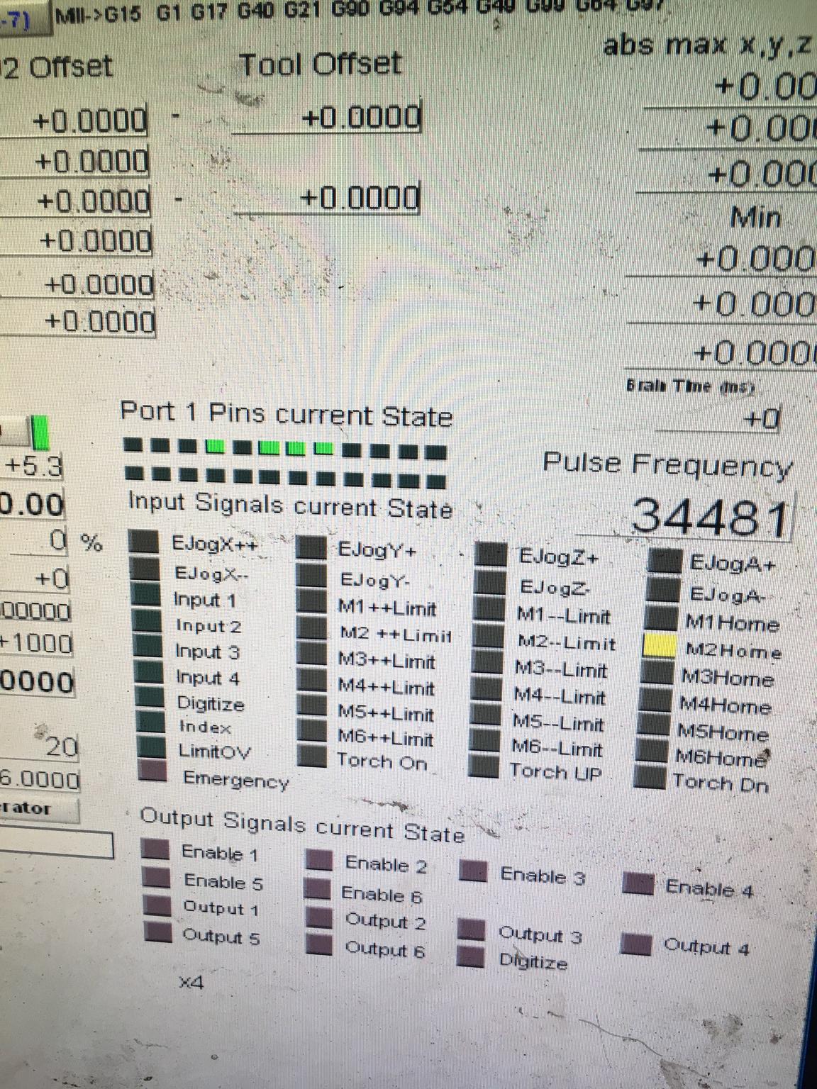

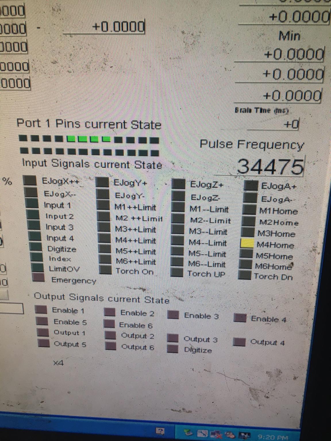

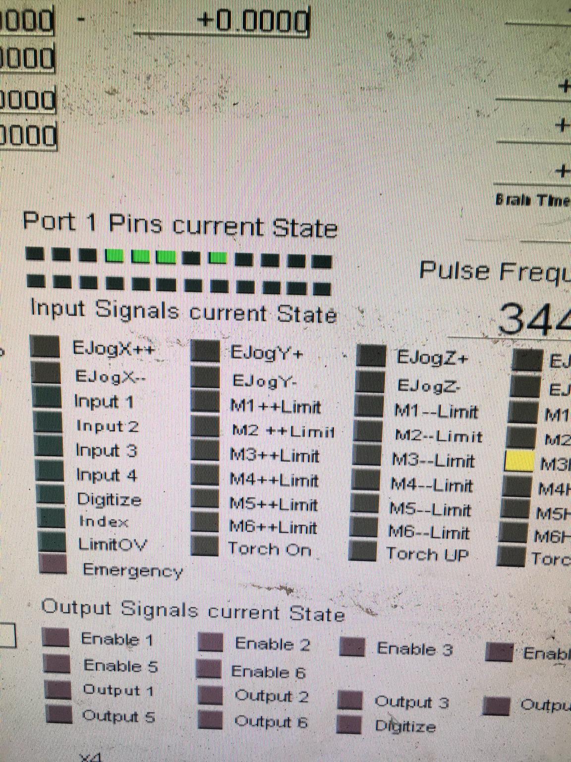

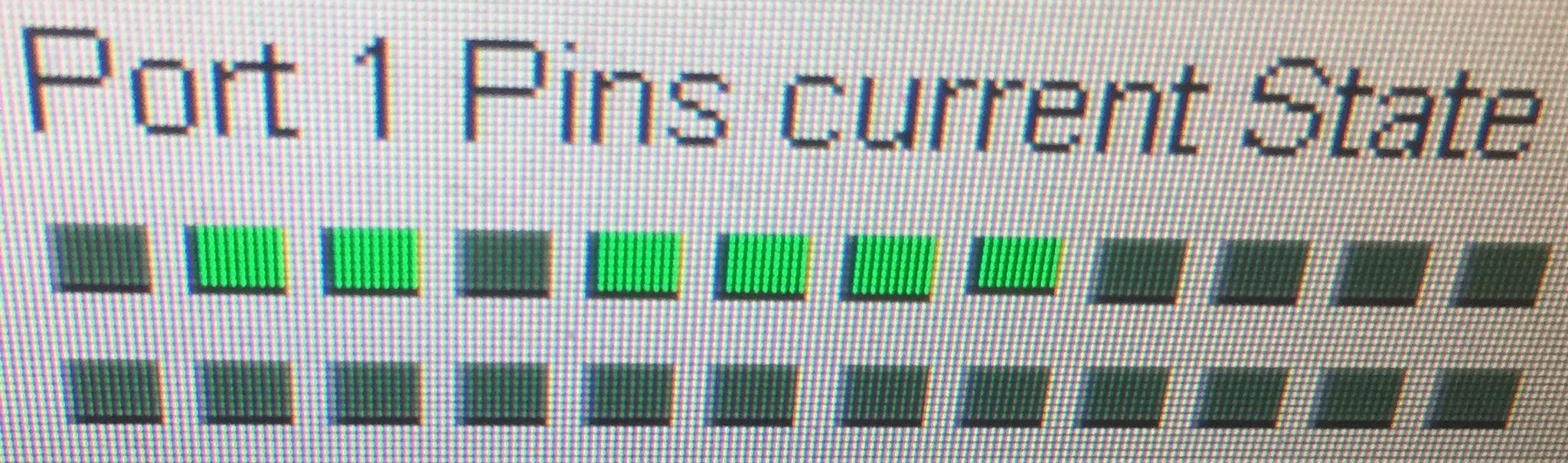

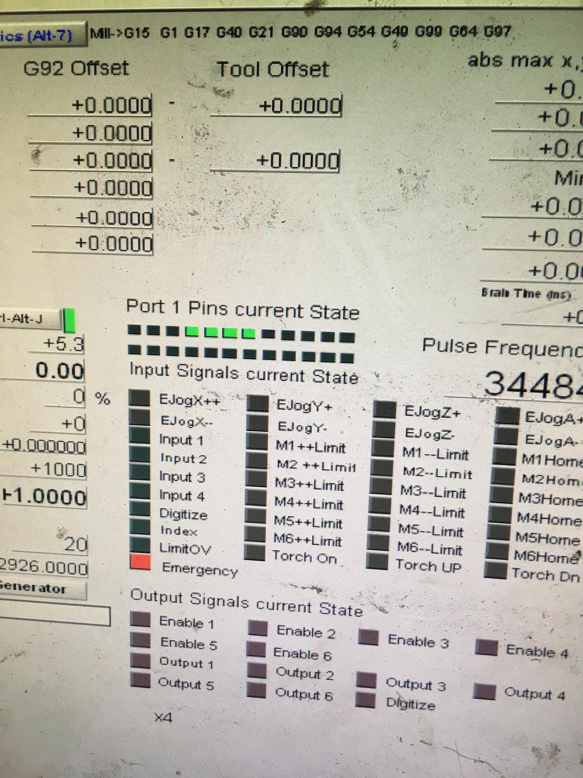

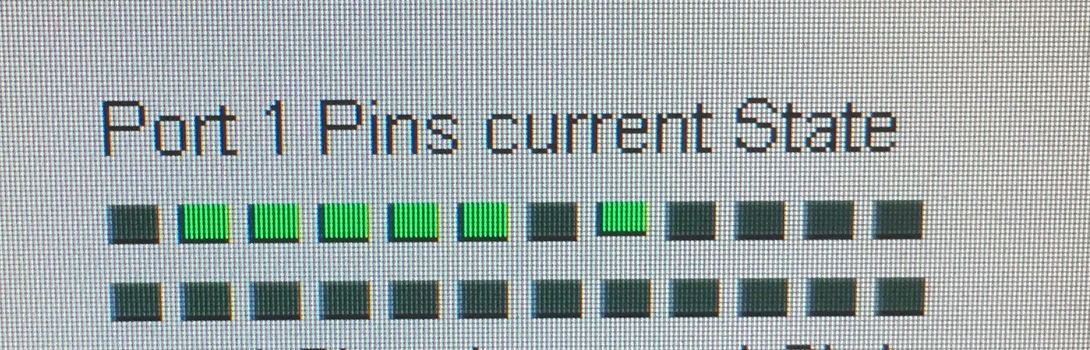

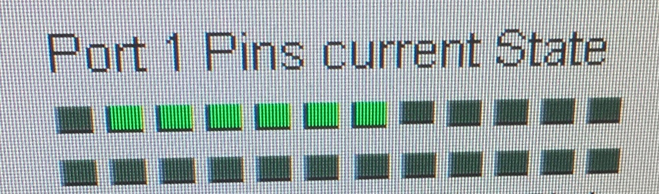

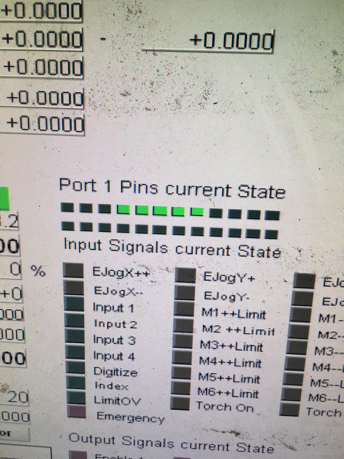

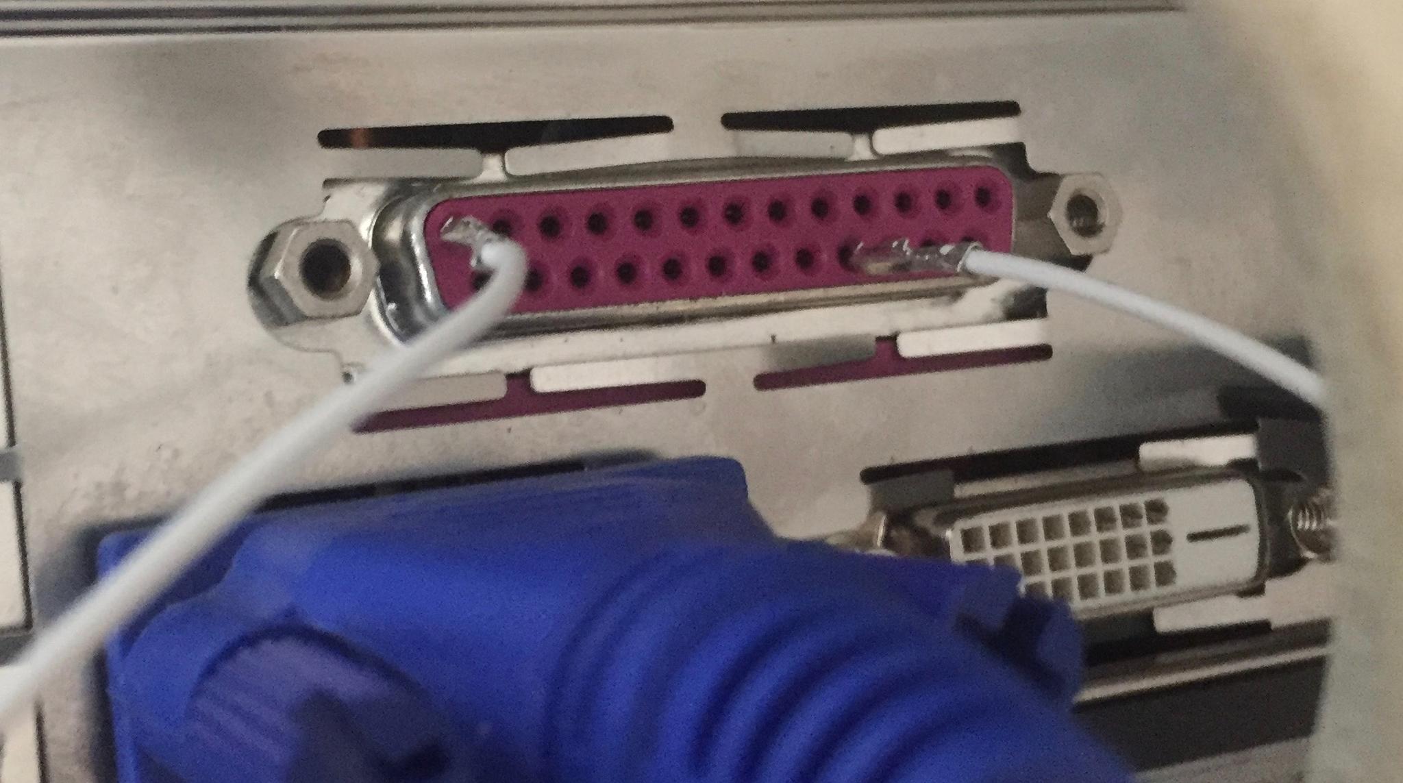

    Let's test that the inputs into the parallel port are being read correctly by Mach3.
    Use a jumper to short from pin 25 (GND) to pin 10 - on the PC's parallel port...
    Attachment 26297
    On the diagnostic page...
    Attachment 26298
    Move to 25->11
    Attachment 26299
    25->12:-
    Attachment 26300
    25->13:-
    Attachment 26301
    25->15 (NOTE: skip 14 - that's an output!, not input):-
    Attachment 26302
    Confirm that behaviour then we're confident that the parallel port inputs are able to be monitored by Mach3.

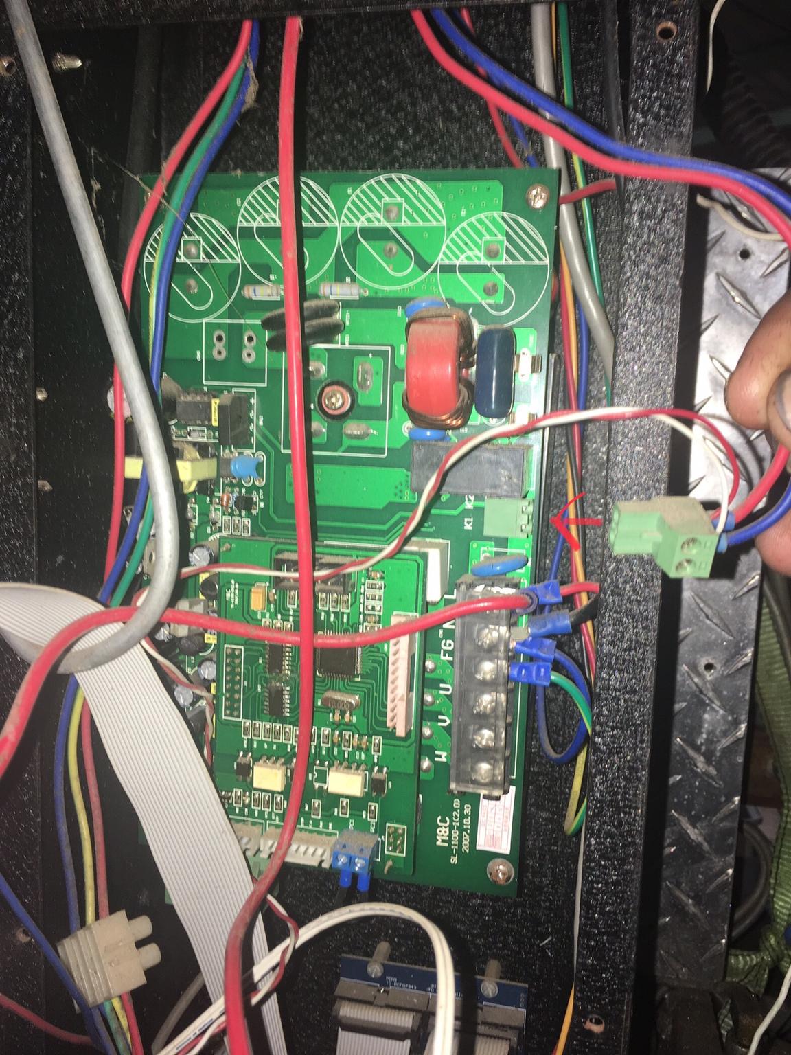

    Now I'm confused. Have a look at the electrical schematic here (Syil X4)
    https://www.peu.net/syil/X4_User_Manual.pdf
    If the schematic is to be believed, the E-Stop button will only isolate the power to the BOB when active, with the E-Stop input to the BOB wired to ground. Is this true of the actual machine wiring? (I think the OP suggested otherwise).
    I’m not sure if this is anything but yes the estop is wired directly to the bob - however
    There are 2 wires that run from the bob to estop -half way along they are inserted into a ‘plug’ then continue onto the estop.
    The plug is male and there is its female companion vacant nearby on another board - is this a coincidence or should it be plugged in?
    So white and red go to bob and the red and blue go to estop button

  9. #69
    Quote Originally Posted by IhateDoug View Post
    This worries me a bit. I would NOT plug the connector into the board - from the schematic and the legends on the board I do think that the board terminal is carrying 24VAC for the E-Stop relay, plugging it in could throw 24VAC into the BOB input channels. You've already established that power is present on the BOB which means that the schematic and the E-Stop isolation of the BOB isn't effective (wired).
  10. #70
