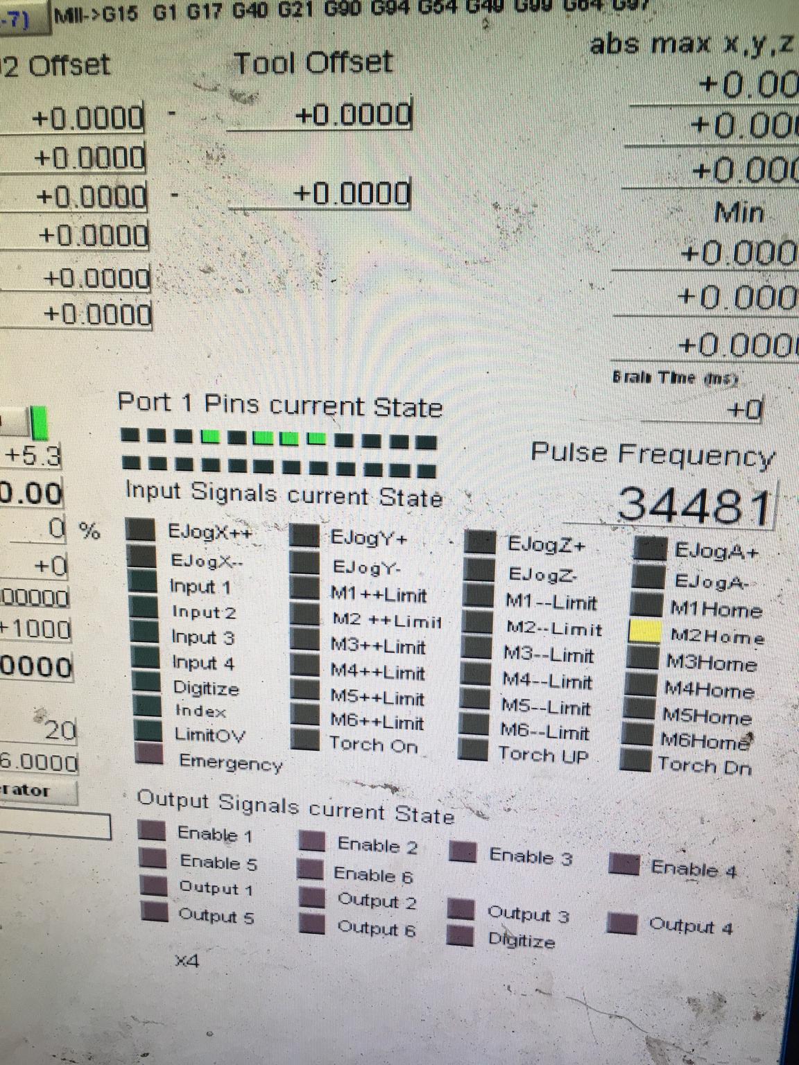

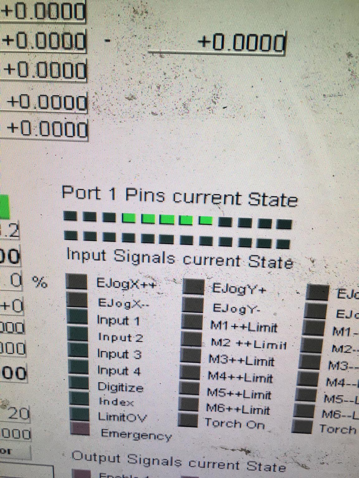

    Let's test that the inputs into the parallel port are being read correctly by Mach3.
    Use a jumper to short from pin 25 (GND) to pin 10 - on the PC's parallel port...
    Attachment 26297
    On the diagnostic page...
    Attachment 26298
    Move to 25->11
    Attachment 26299
    25->12:-
    Attachment 26300
    25->13:-
    Attachment 26301
    25->15 (NOTE: skip 14 - that's an output!, not input):-
    Attachment 26302
    Confirm that behaviour then we're confident that the parallel port inputs are able to be monitored by Mach3.

  2. #62
    If that works, short the X-DIR pin to one of the inputs, for example I shorted 17 to 13...
    Attachment 26303
    Now, by using the cursor left/right and verifying the change in the "X Pos" on the diagnostic screen, I can toggle the state of the pin 13 LED. This verifies that the Mach3 X-Axis Direction output can be set correctly by Mach3. Note, I'm ignoring the X-Step signal because this is a very short duration pulse that won't be shown on the LED status on the diagnostic page.
    Ignoring the Step signal - which is critical to this, but noting the difficulty in measuring it. If the X-DIR signal and X-Step signal work then the X-Axis of the machine when plugged in should work and should be under user control with the Cursor Keys. If not, then we move to the Syil.
    The ‘m2Home’ led turns on and off
