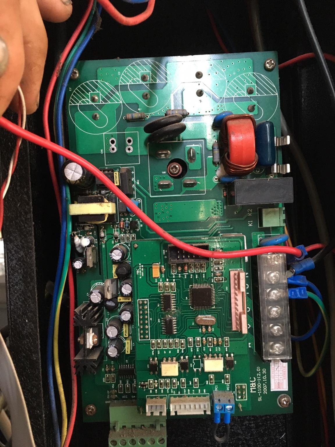

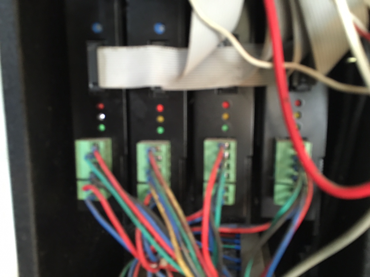

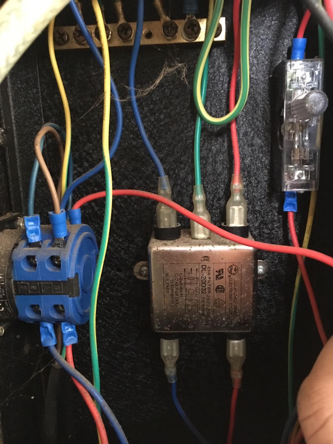

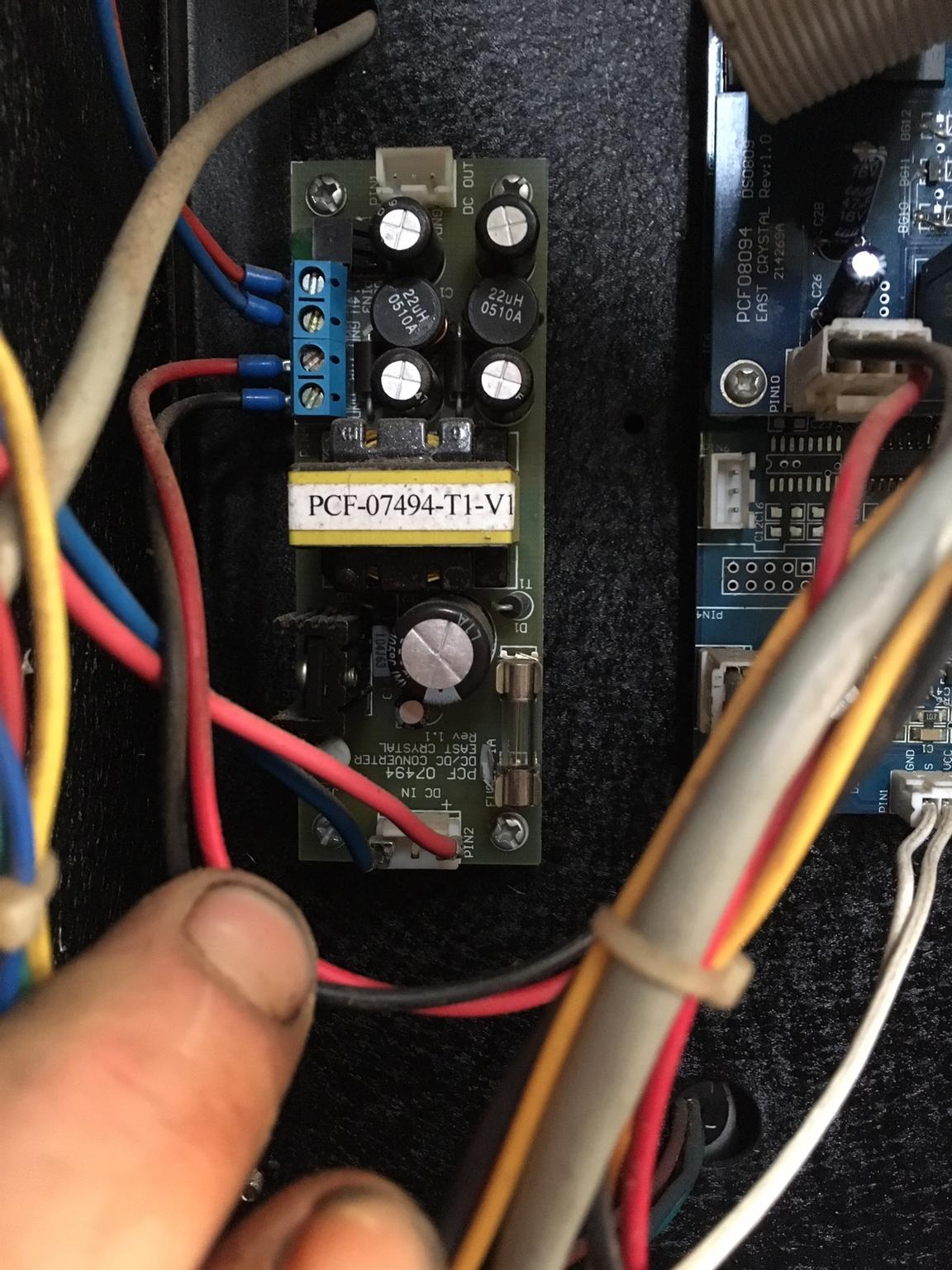

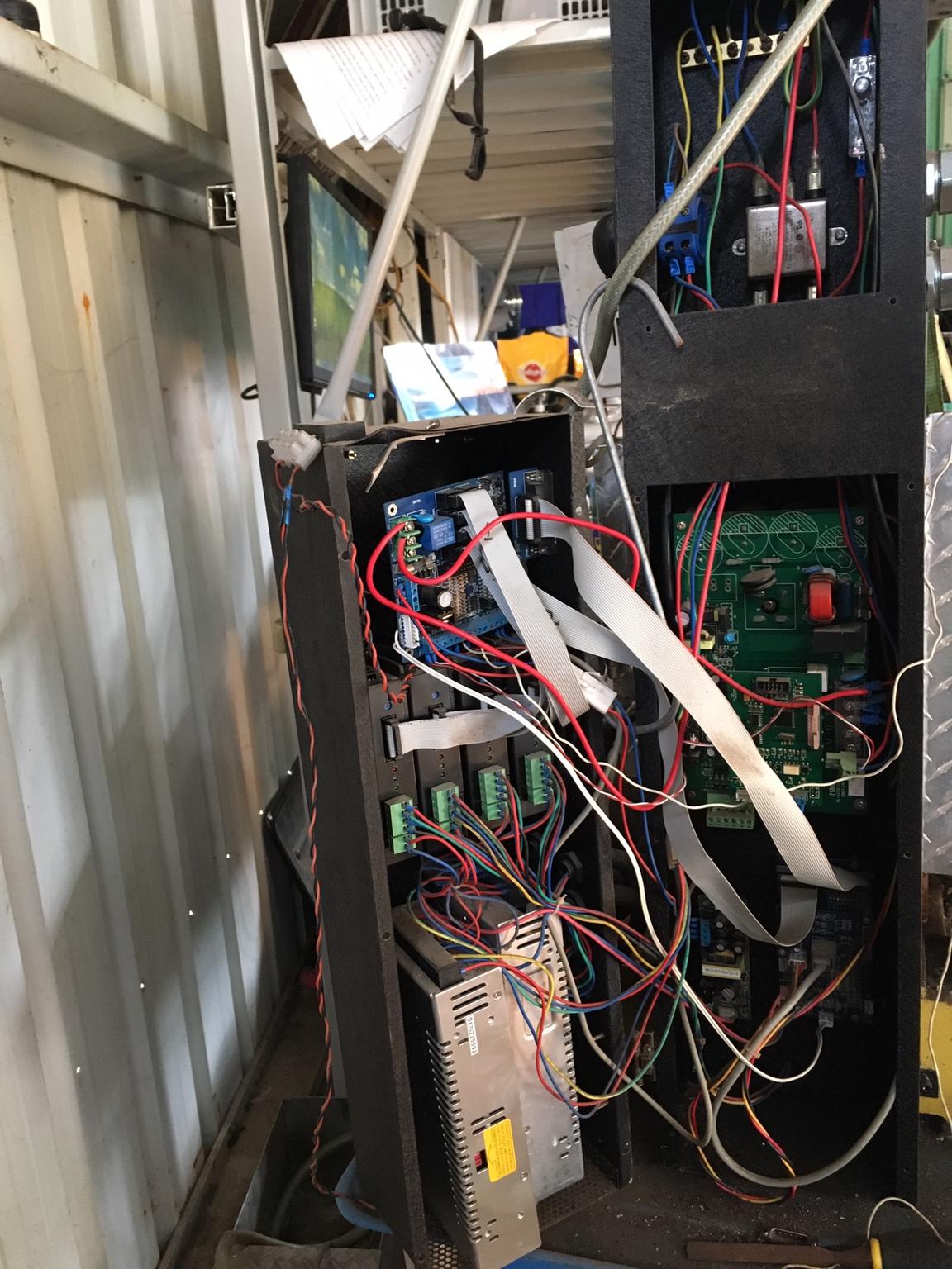

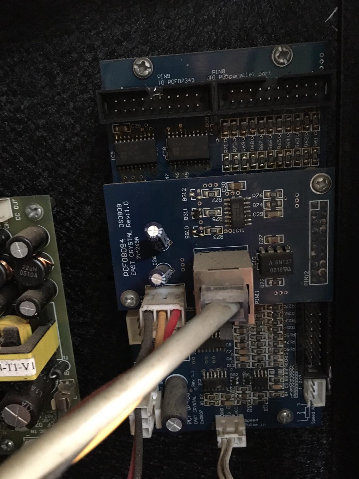

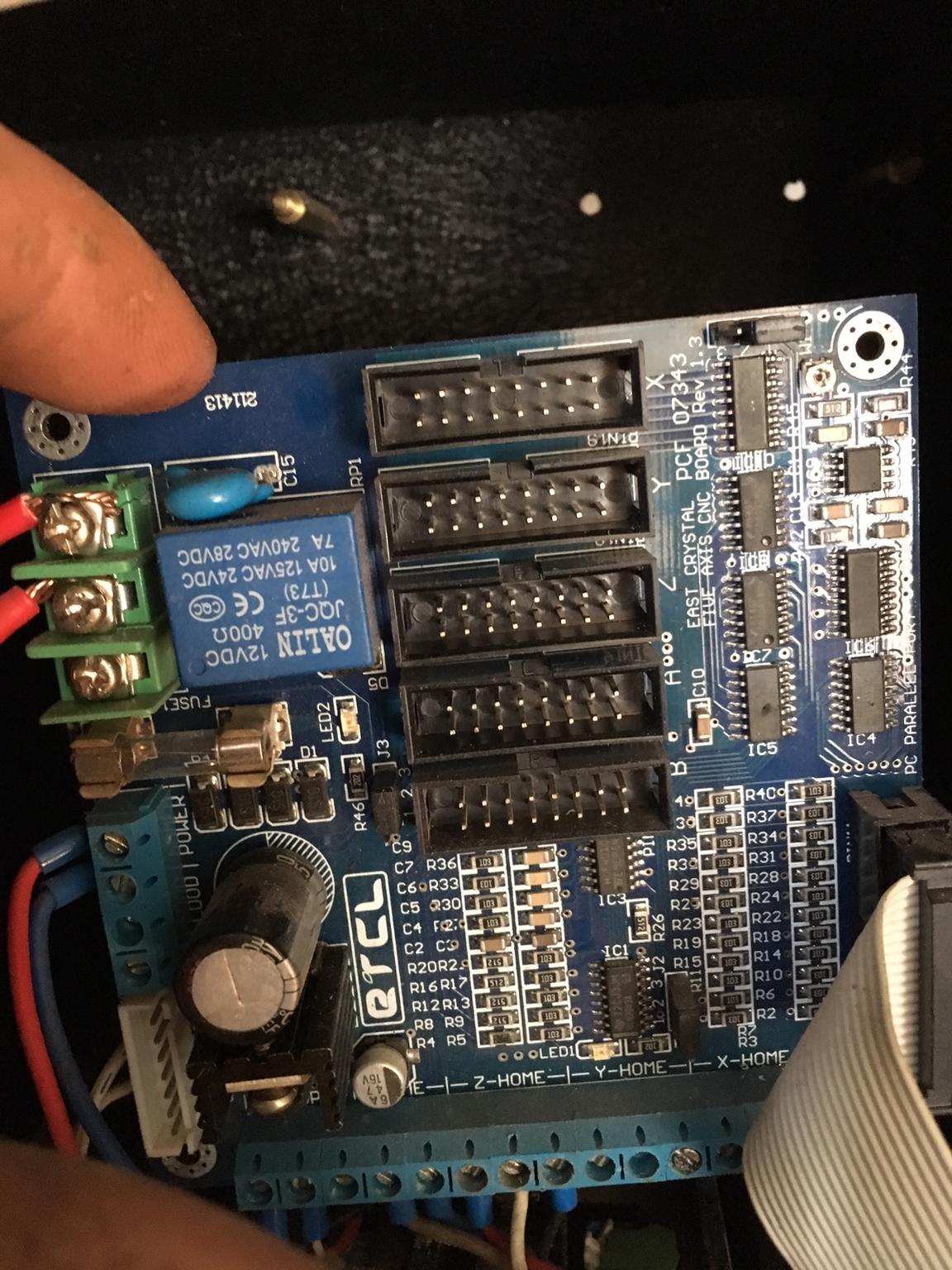

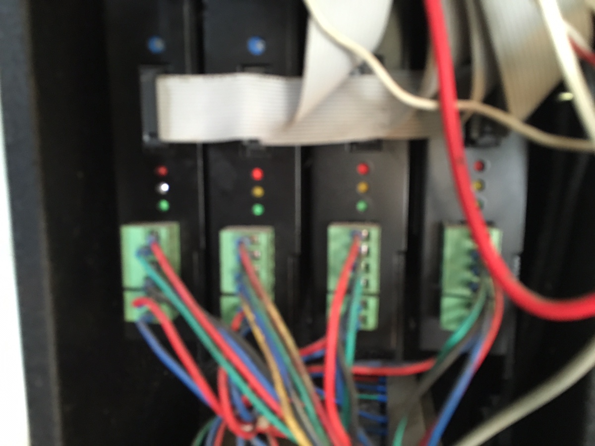

    This is my point. If all you did was move the machine which worked before the move then it's highly unlikely that the Bob or Drives are broke. Worst case you'll have lose or broken wire.
    The fact you changed the pc gives much higher chance your problem lies here.
    It's certainly the first place should be looking and testing PP is working.
    Regards the machine itself then it's very basic machine so won't be difficult diagnose any fault. However first need know exactly what you have in control box. Or better put how hacked up it's been from standard.?
    In it's basic form to get movement all you need is power for bob and drives and signals from PP. Everything else can be left disconnected and replaced at later time when got movement.
    Show us pics of inside control box and each of the boards.
    Sent from my SM-T580 using Tapatalk

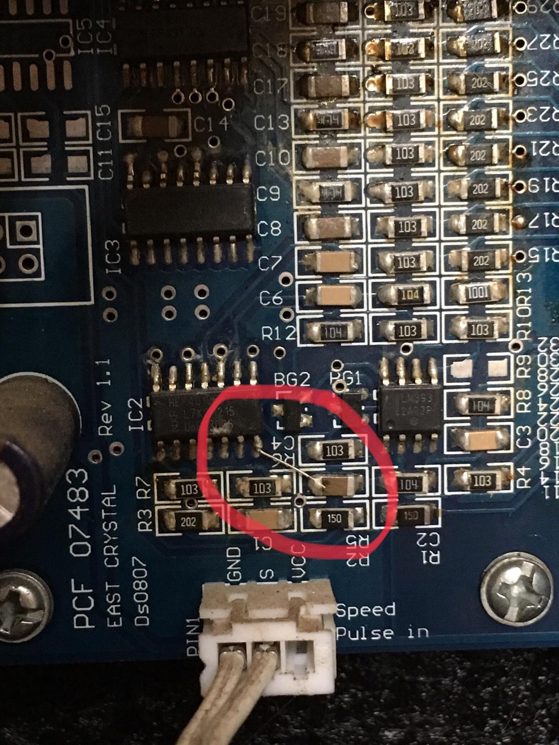

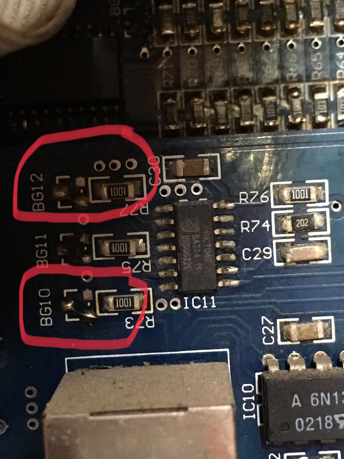

    Also noticed these
ID:	26338Click image for larger version.

    If they aren't modifications made since it last worked then they should be ignored as it ran fine like that previously?
    It's not uncommon for manufacturers to correct a faux-pas on a board with a wire link ;-)

    Ok nowhere do I see a Parallel port cable but I do see an Ethernet Cable going to what looks like a Controller board with ribbon cables going to Breakout board so are you sure it's using Parallel port.?
    If it's using Ethernet then it won't work untill you set the Ethernet address and it would be Dead just like your experiencing.!
