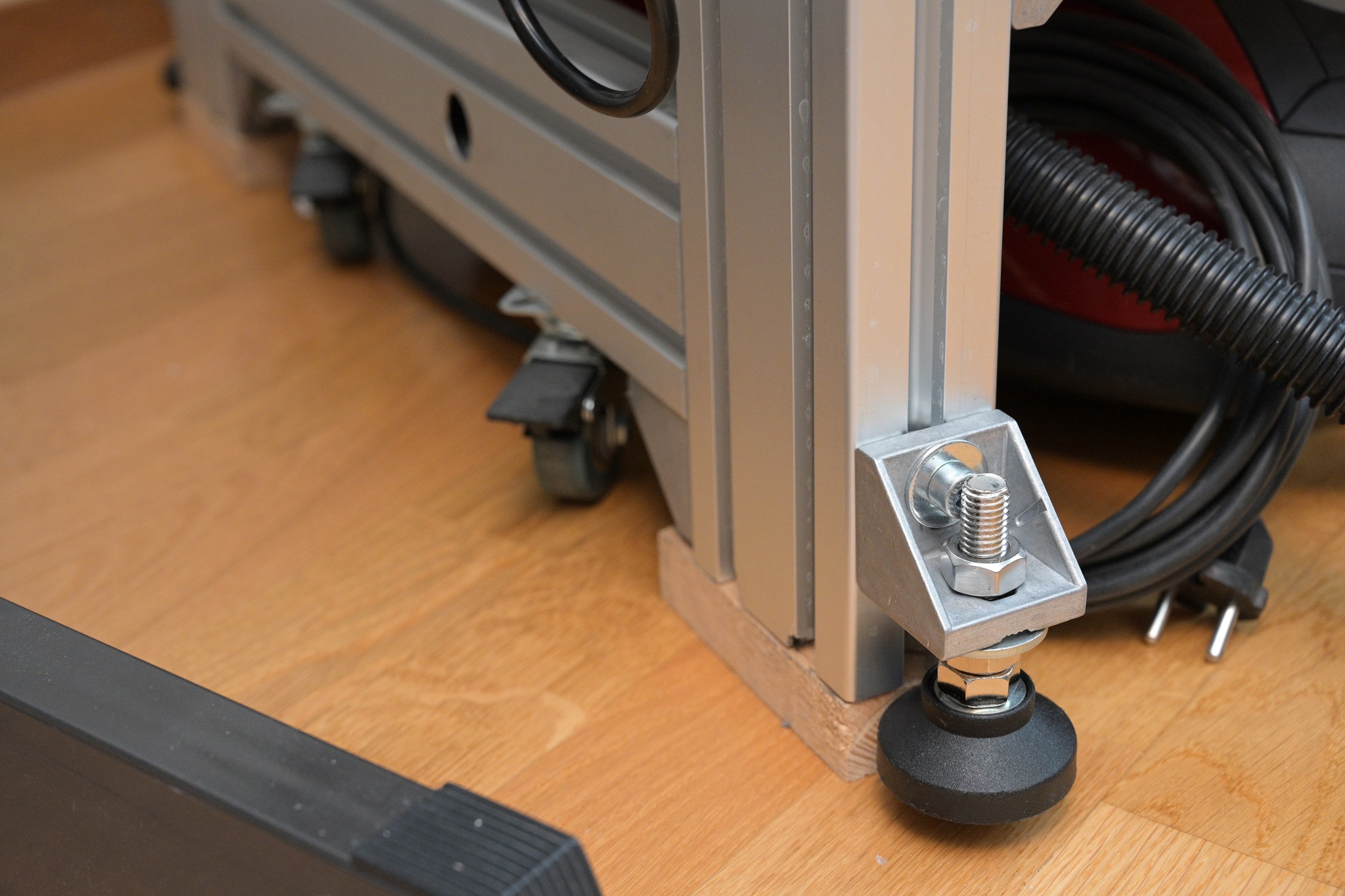

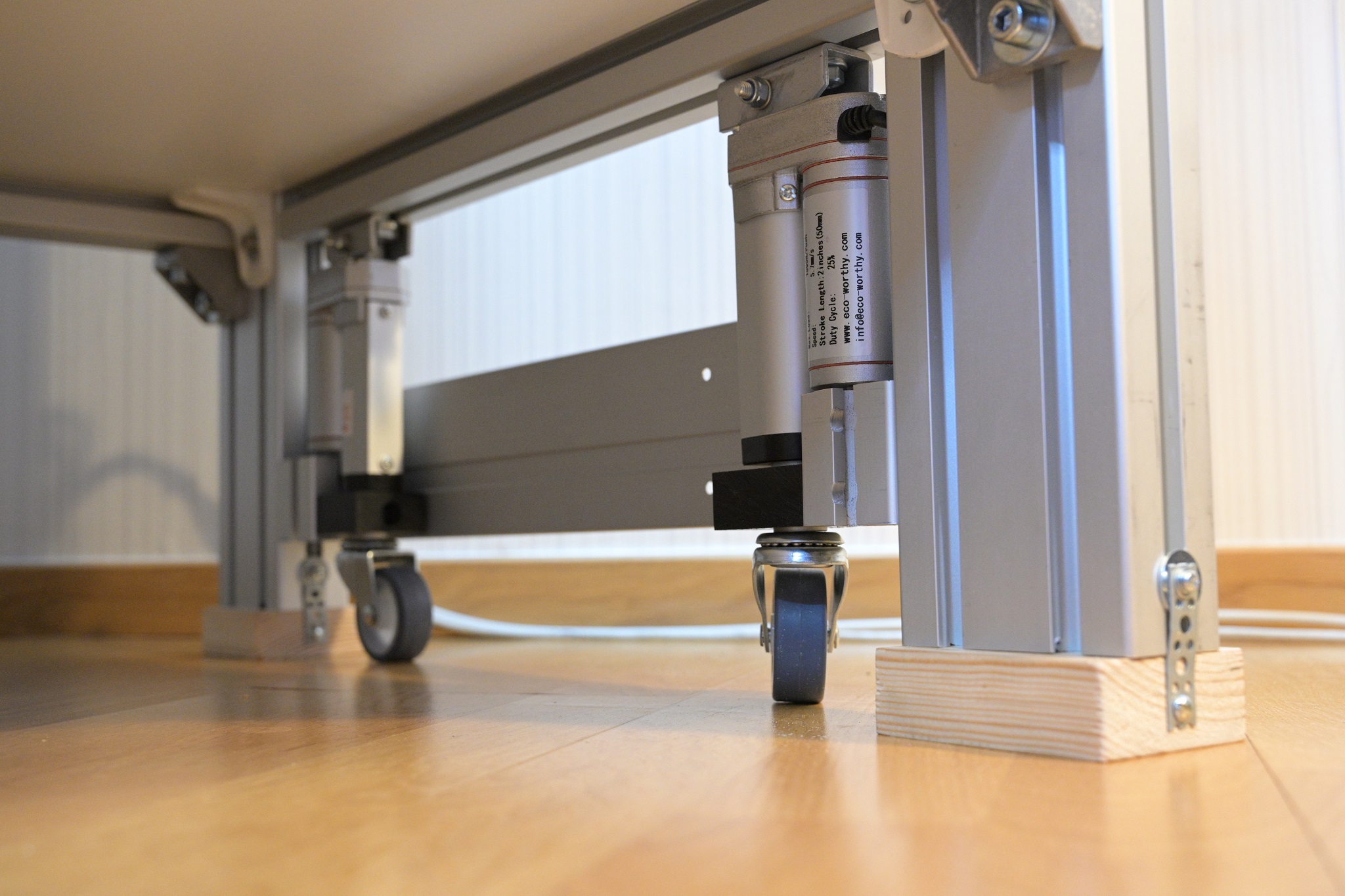

    I had to lower the round black feet on all four corners to lift the machine, remove the wooden blocks the machine normally resting on, raising the black plastic feet to lower the machine on the four castors, move it to the new place, lift it again, place the wooden blocks under it and lower the machine on those. It was a complicated operation, which actually put me off from doing any improvements and modifications, so I decided to do something about it.
    What I did was I ordered four linear actuators, installed castors on them and installed on the four feet.
    After installing the actuators, my CNC looks like this if I take look in an upskirt view...

    Each linear actuator can lift 152kg, so I knew I had good margin. The only thing I am not that happy about is that they extend to three different lengths, only two are the same, but in this application that is not critical.

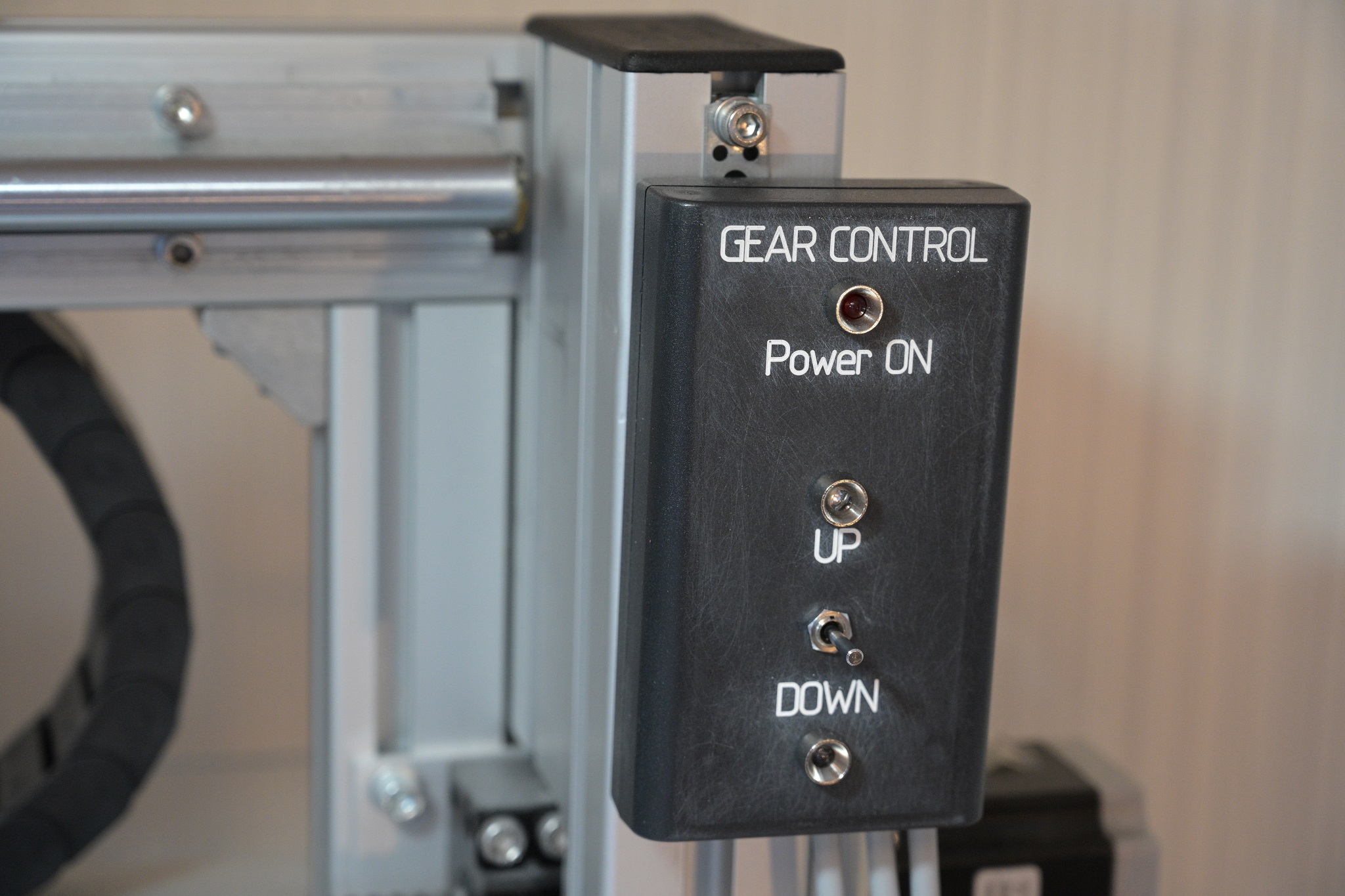

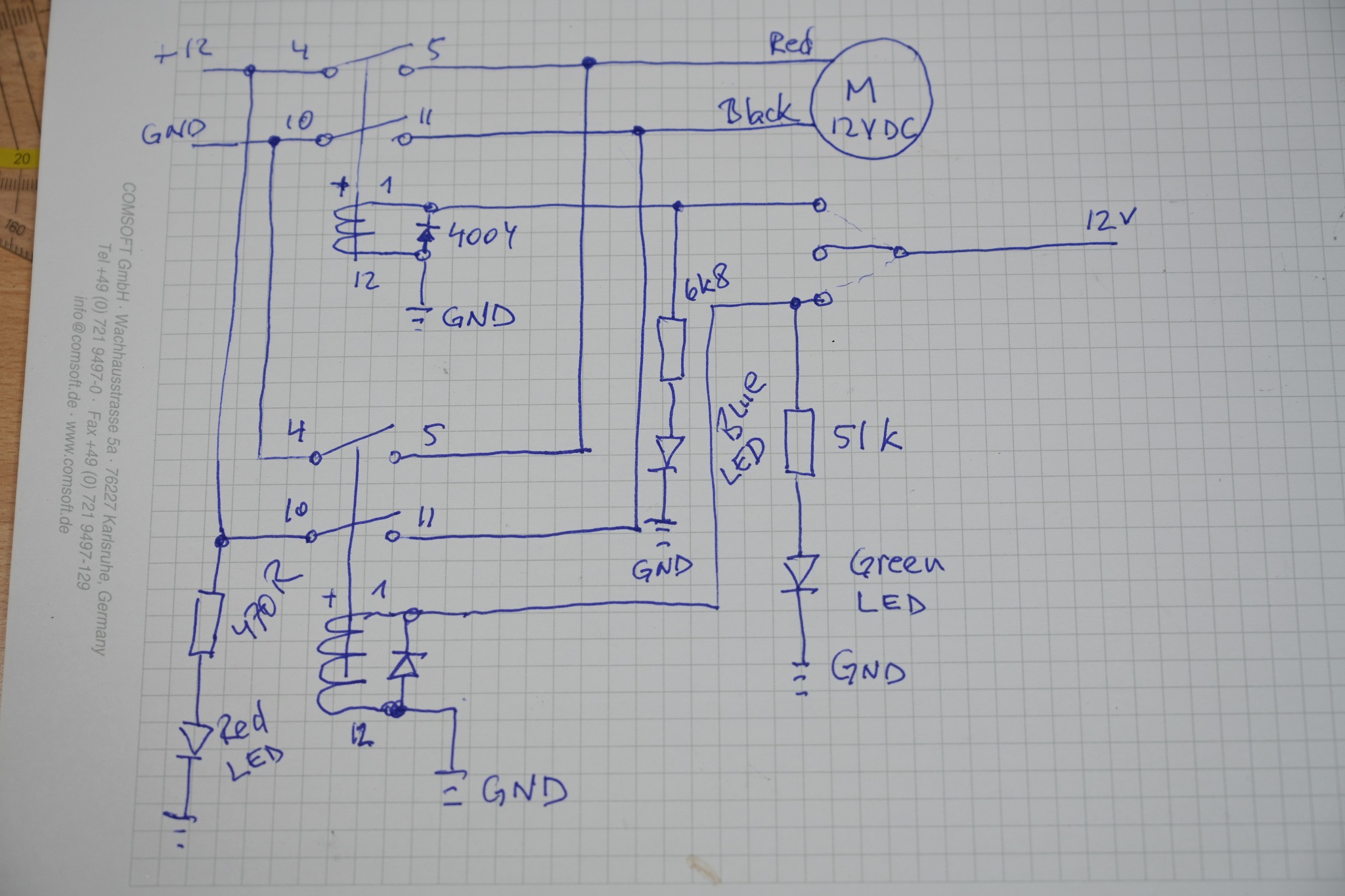

    I made a control box with some relays, a switch and three LEDs to control the actuators.

    Of course, simplest would have been to use a 3-way two pole switch, but I had no such thing in my boxes and drawers. I had however more than enough relays to make it, so I went for a relay based solution.

    The box isn't as nice as I wished for, but it does what I wanted it to do. This was the first time I made this sort of engraving, so it's OK for now, but I will make a new box top with better polished surface another time. Now it is easy to move my machine around, just flipping a switch and that lifts the machine with the wooden blocks permanently attached under it's feet. No more crawling on floor for a simple move.

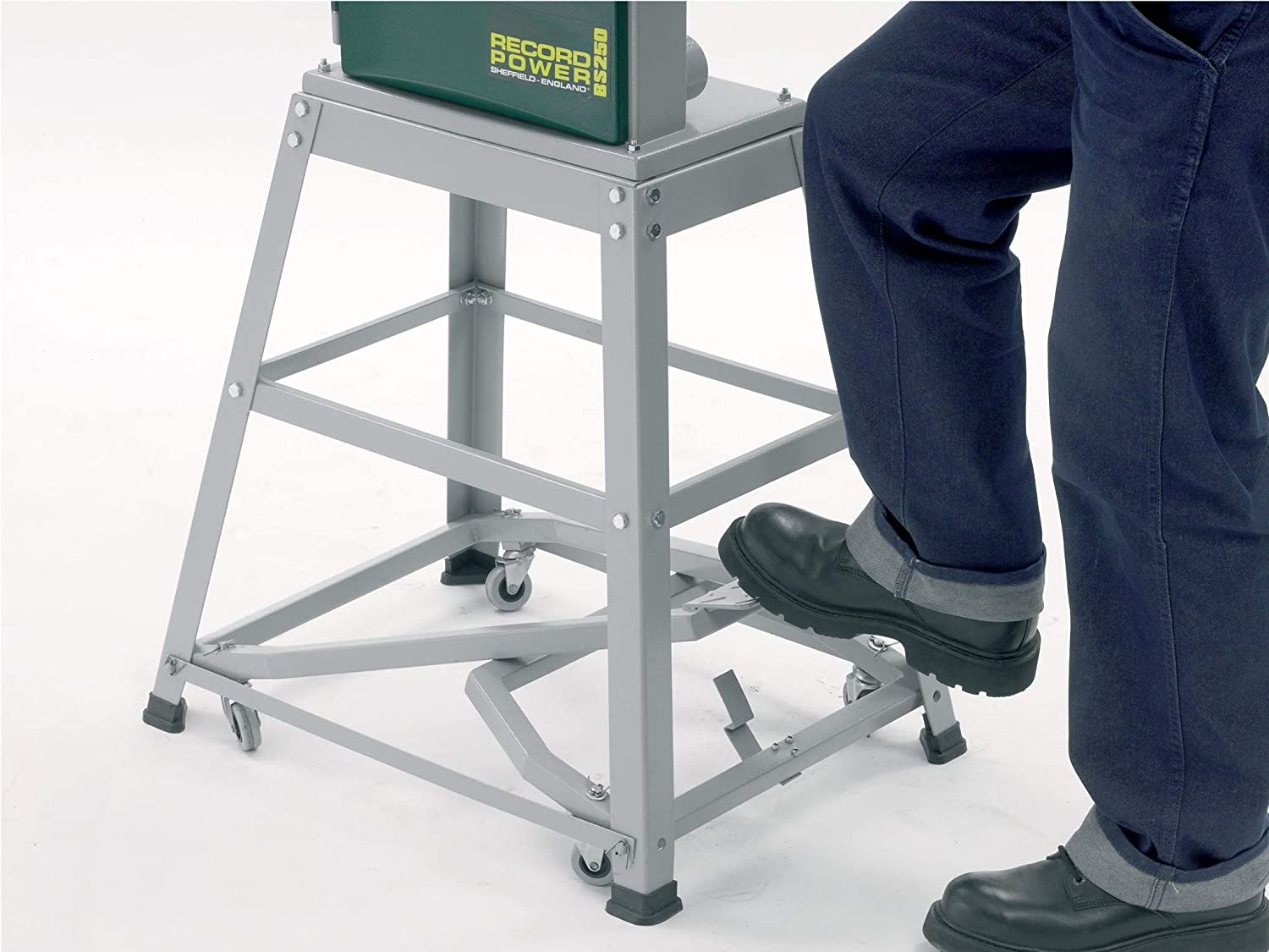

    Hi, thanks for sharing this experience and your solution. My first reaction was that it was rather an over engineered solution, as I am rather more used to small workshop solutions like these or these. However a quick check on eBay suggests those actuators are only around £30 each and work for machines in the 200-500 kg range. Plus as you say simple switches and power supply is all you need. Now I have definitely stored this idea away should I need to move my machine regularly for pass through jobs. The satisfaction each time you flip the switch rather than lie on the floor winding up machine castors like these would hasten the pay back!
  3. The Following User Says Thank You to Andrewg For This Useful Post:
    Quote Originally Posted by Andrewg View Post

    BTW, yes, my control box is definitely over-engineered, but as I said, I had no switch for the high current and I like to use what I have when it is possible, so I had to use relays. In fact, I am using four relays, two for one side two for the other, because the relays I have can't handle all that current (around 12A) so I use two relays for one side and two for the other. The 12A is just a guess, but my PSU to the acuators is a 12V 8A PSU which is OK for now, but if I stop the motion half way in the lifting process then the PSU stalls and the actuators won't continue the pushing. The rated current is 3A for each, but I haven't measured what is the current needed to start with load. Anyway, on my to do list is the replacement of the PSU with a 12V 82A version. Yes, eighty two amps. Once again, it is over-engineering, but I have many PSUs like these:
    Ah, I've been there - brilliant machine feet, but a complete bugger when you've got a bench & mill weighing in at over 200kg and you're trying to get to the foot at the back. We need someone to design a wrench for the cog for these - my thumbs ain't what they used to be.
    A_Camera - like your idea, but over complicated. Why not build a multi-purpose jack-plate (basically what you have... but you can place it under any machine to lift it)

    You have got me wondering whether a combination of your linear actuators and a lever system like on that bandsaw stand might be ideal for a mobility solution if one need to build a steel frame anyway. Maybe one for each side, as with the additional leverage two 1500N actuators would be good for weights up to 500kg easily.

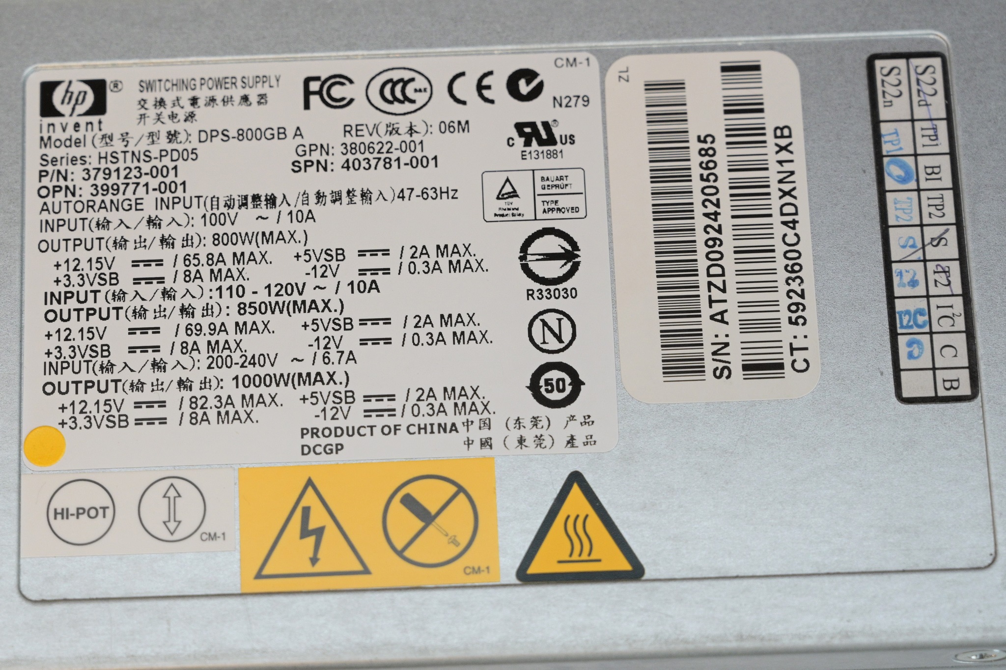

    Is that a server PSU? I have been told they are a cost effective solution if bought refurbished off eBay.
    I had a similar idea as well, using two actuators, but did not do it because I need the space under my CNC for the vac. Also, the one in that link is I think too weak, but I can be wrong about it. It is however definitely good enough for a band saw or similar.
    Yes, it is from HP G7 servers. We threw away quite a few last year and I saved a few PSU. They are excellent and easy to use, but beware in case you want to buy a few, the 12V GND is connected to the earth, so connecting these in series is a bit tricky. Of course, the problem is solvable, but you have to be aware of it
