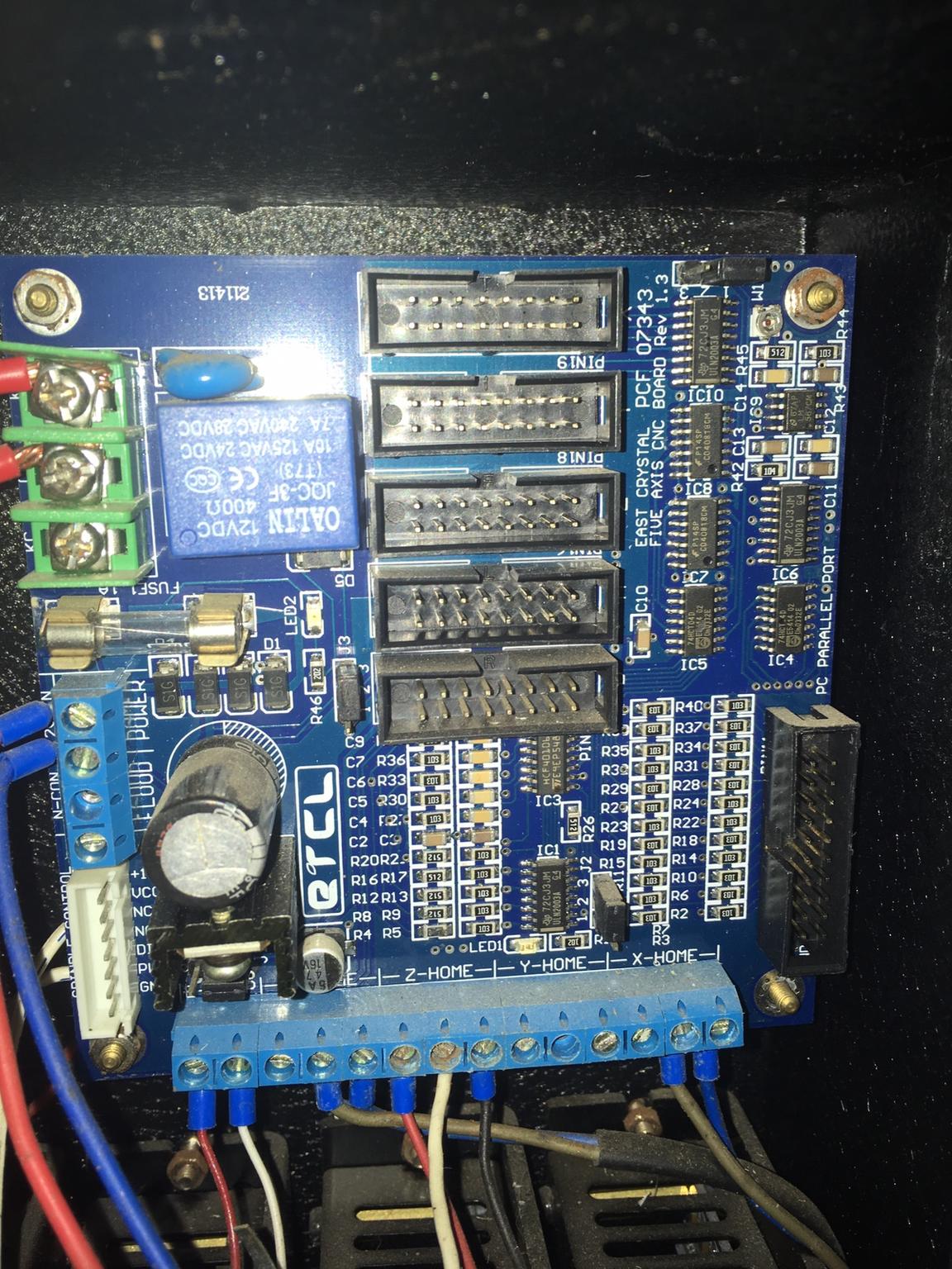

    - Really stupid question and I’ve legit spent hours googling but where are the pins? My board seems to be different. Are they the pins labeled “A””X””Y” or are those limit switch pins?

    The pins are ultimately the screw terminals on your breakout board. For example in the photo you can see estop and home. It would help if you could upload a photo of the whole board.
    You are looking for a screw terminal with the label step and the label direction. These send signals out to the drivers to turn the motors.
    So to follow Doddys help touch one probe of the multimeter onto the screw terminal marked direction for the axis that should be moving and the other onto something marked ground. When you use the keys to go left and right that terminal should switch between 0V and 5V.

    Literally havnt changed a thing - I found the XML file that comes with these and it matches the one I’m using. I’ve literally unplugged it from the power point and unplugged the parallel cable from to the pc and loaded it on to a trailer - moved then plugged it back in again.
    Now I think of it the last time I used it it the x axis was jamming and skipping every now and then if that’s relevant.
    I’ll be near it in about 15min and will take some picture of the board.

    Other thing I noticed is this board kinda looks burnt?

    OP: Thanks, that helps a lot. Random googling of the board name/model suggests that these were boards installed by Syil as part of their standard build. There's easy reference to Syil 3's and 4's having the same board. I wouldn't necessarily trust the info from blind but there looks to be some level of consistency. The following was taken off another thread referencing a '3':-

    I’m standing in front of it atm with a multimeter - just can not figure out where the pins are
    Actually disregard that - they are labeled ‘pin xx’ on the board correct?

    You're absolutely correct, and I've fallen foul of my own criticism of assuming too much. Looking at the board the axis drives are presented onto the IDC headers (the 16-pin black connectors, 5-of) on the board. Okay, that gives us a bit of an issue to understand how these are wired.
    I'm guessing there are at least 3 ribbon cables normally plugged into these (I think I did see this on an earlier piccy).
    I'm going to change tack back to the e-stop, but I'll post this for now knowing that you're stood in front of the machine scratching your head. Give me 20 minutes to write up another thought.
