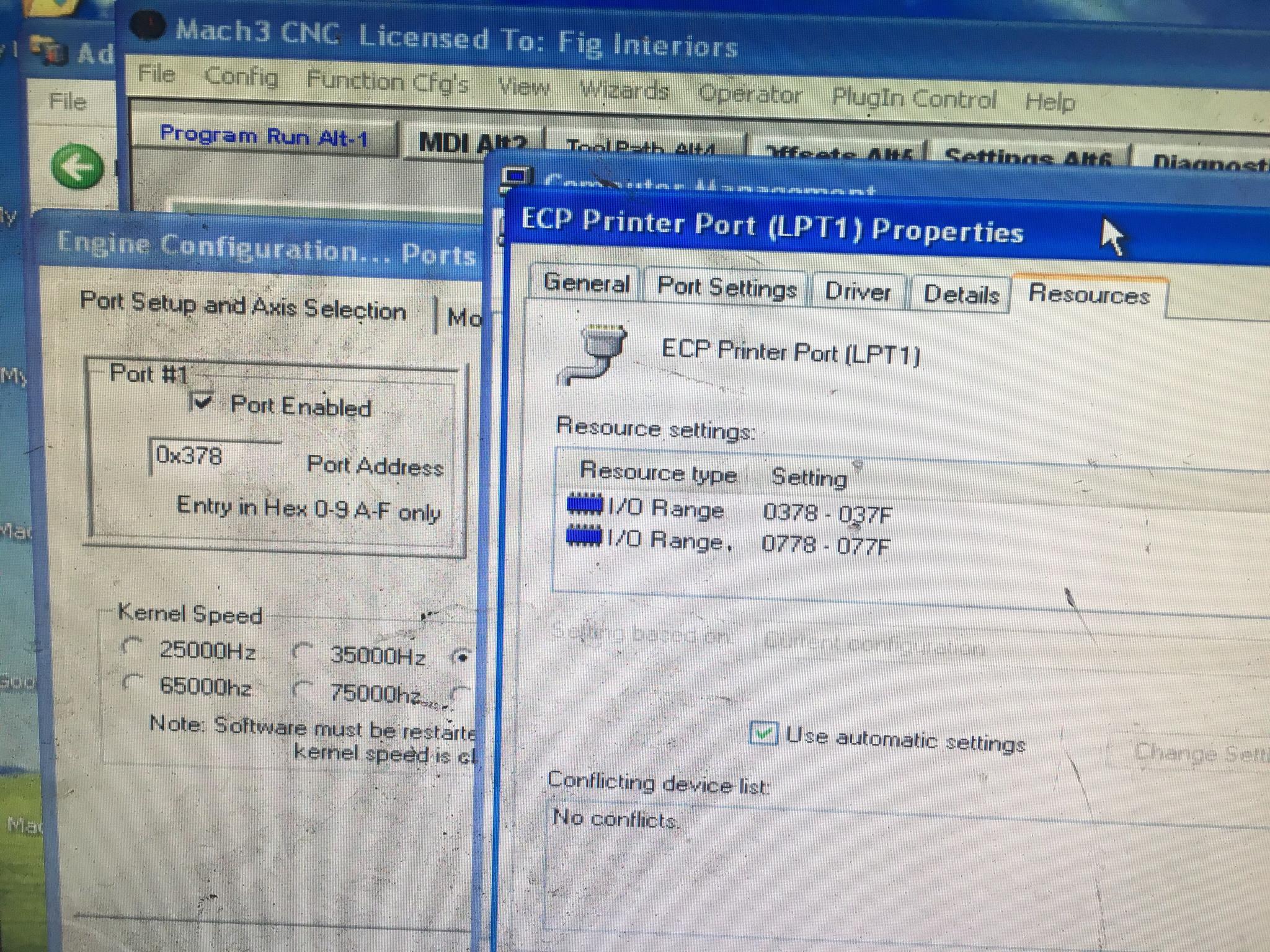

    You said in your first post that
    you have:
    -replaced the pc (was on it way out anyway)
    -checked the ports configured
    Did you actually checked that the Port Address of your new pc parallel port matches the one you set in Mach3 (0x378)?
    What OS does the new PC run?
    Anything newer than Win7, (aka 8.x or 10), and anything 64bit, won't work with the parallel port.
  3. #53
    you have:
    Is that correct or should it be the ‘com1’ address?
  4. #54
    Windows XP 32

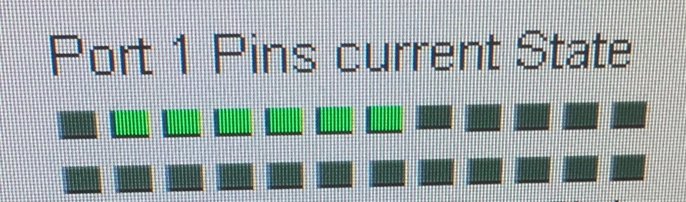

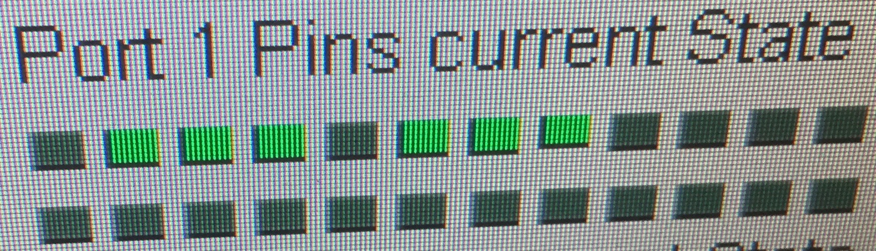

    Let's test that the inputs into the parallel port are being read correctly by Mach3.
    Use a jumper to short from pin 25 (GND) to pin 10 - on the PC's parallel port...
    On the diagnostic page...

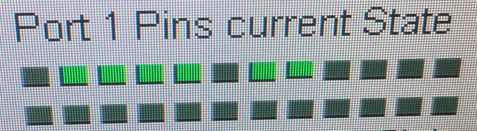

    Move to 25->11

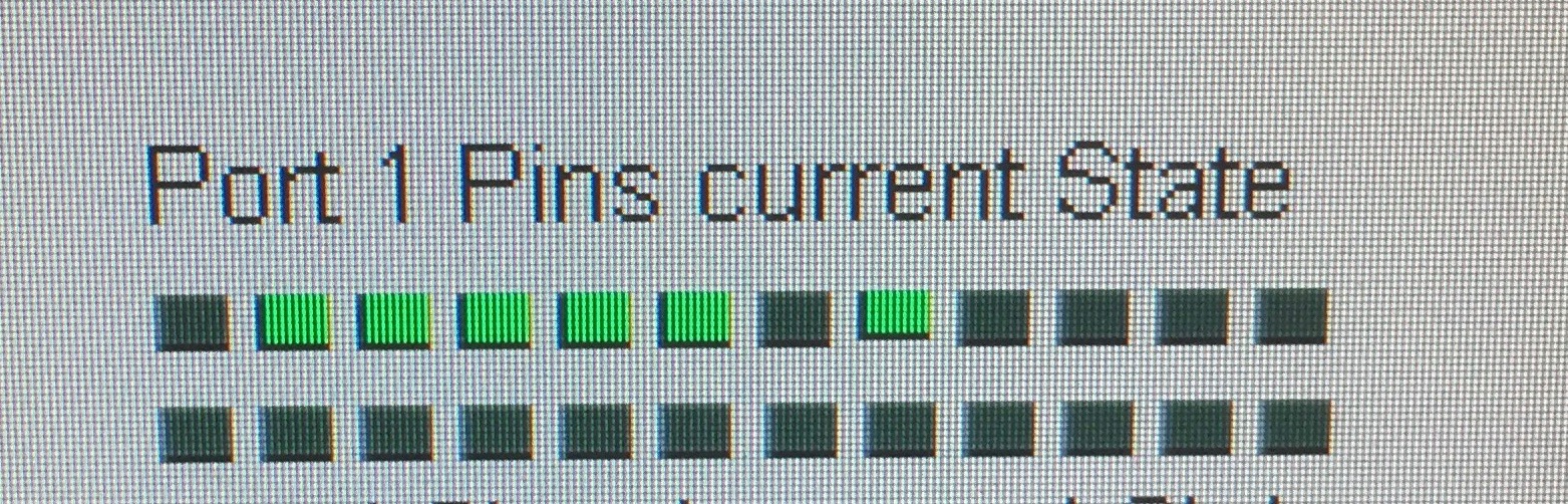

    25->12:-

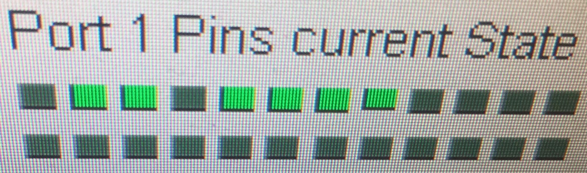

    25->13:-
    25->15 (NOTE: skip 14 - that's an output!, not input):-
    Confirm that behaviour then we're confident that the parallel port inputs are able to be monitored by Mach3.
  10. #60
    Doddy's Avatar
    Lives in Preston, United Kingdom. Last Activity: 4 Weeks Ago Has been a member for 9-10 years. Has a total post count of 1,364. Received thanks 188 times, giving thanks to others 66 times. Referred 1 members to the community.

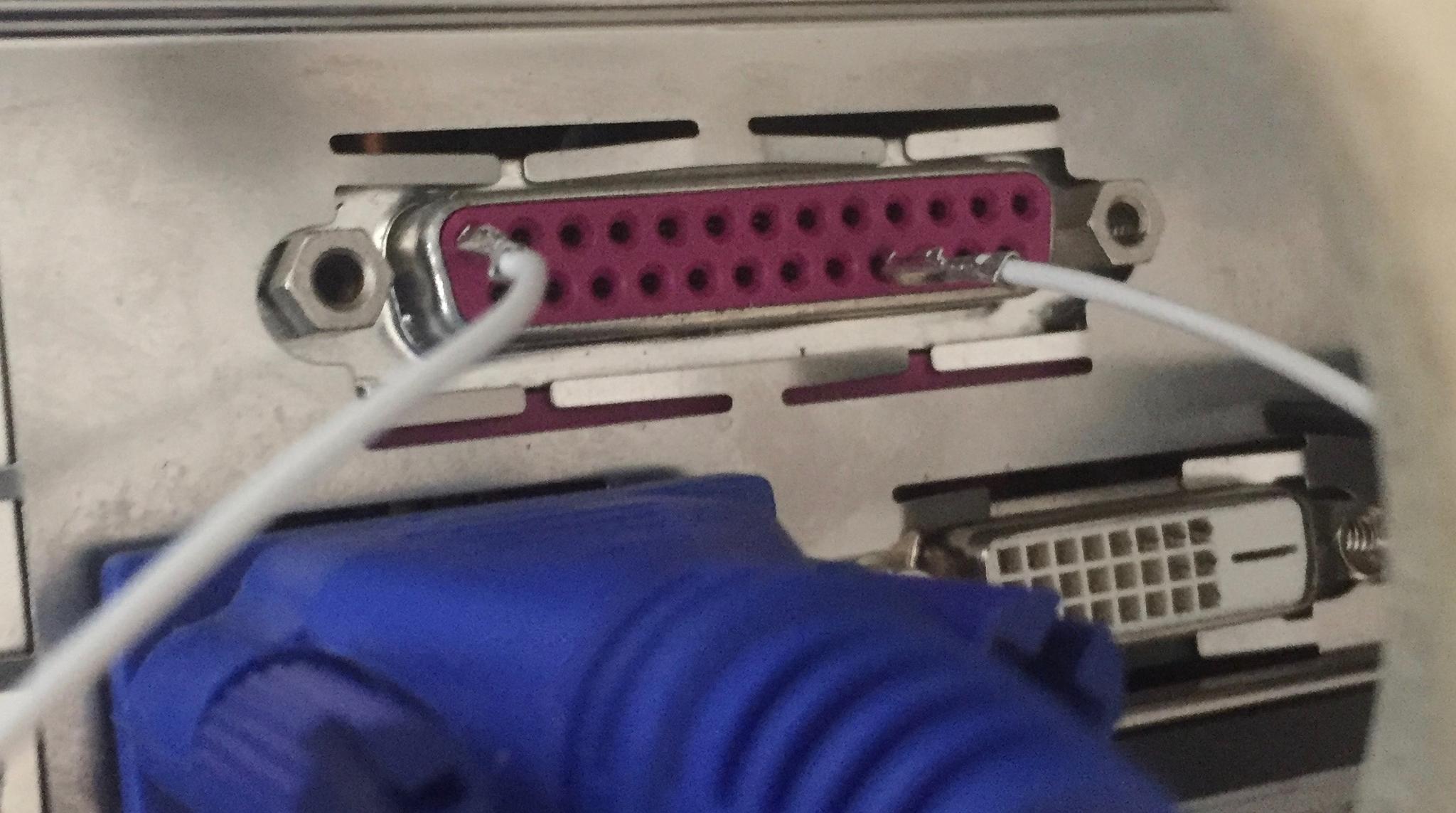

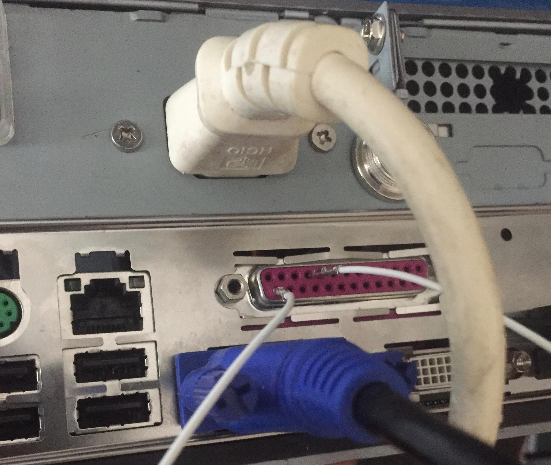

    If that works, short the X-DIR pin to one of the inputs, for example I shorted 17 to 13...
    Now, by using the cursor left/right and verifying the change in the "X Pos" on the diagnostic screen, I can toggle the state of the pin 13 LED. This verifies that the Mach3 X-Axis Direction output can be set correctly by Mach3. Note, I'm ignoring the X-Step signal because this is a very short duration pulse that won't be shown on the LED status on the diagnostic page.
    Ignoring the Step signal - which is critical to this, but noting the difficulty in measuring it. If the X-DIR signal and X-Step signal work then the X-Axis of the machine when plugged in should work and should be under user control with the Cursor Keys. If not, then we move to the Syil.
